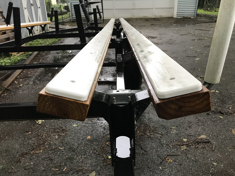

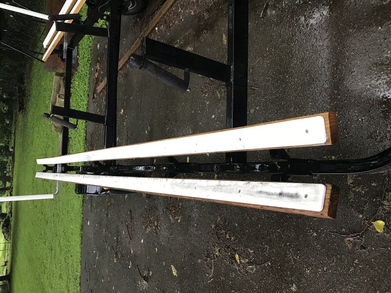

I used Trailer Bunk Glides from Surfix Incorporated and am very happy with them. http://www.surfixinc.com/surfix_trailer_bunkslides.html
They are pricey, but I like the idea of them better than the thin covers. Because the boat never touches the wood I used pressure treated lumber without worry. I installed them in early 2015 and have had no issues or regrets. I used the 3" x 48". It installs in minutes.
- IMG_0304s.jpg (261.17 KiB) Viewed 6724 times
- IMG_0306s.jpg (180.8 KiB) Viewed 6724 times
- IMG_0307s.jpg (221.73 KiB) Viewed 6725 times

[quote="gerg"]I used Trailer Bunk Glides from Surfix Incorporated and am very happy with them. http://www.surfixinc.com/surfix_trailer_bunkslides.html
They are pricey, but I like the idea of them better than the thin covers. Because the boat never touches the wood I used pressure treated lumber without worry. I installed them in early 2015 and have had no issues or regrets. I used the 3" x 48". It installs in minutes.[/quote]

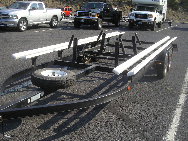

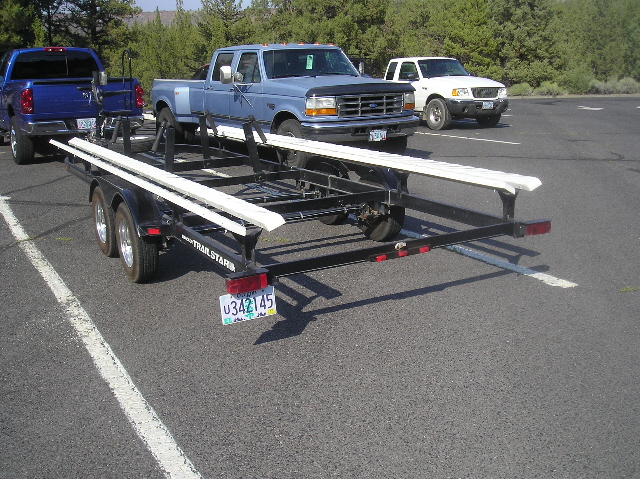

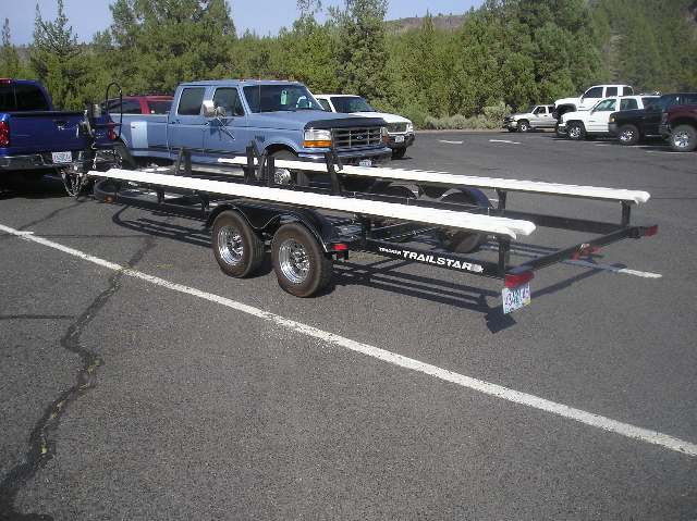

as stated earlier it's time to do some bunk repairs on my trailer.. the carpet is still in pretty good shape, but unfortantely, the wood bunks are rotted thru.. not surprised since the trailer is going on it's 8th season. this time getting away from carpet and going with these polymer bunk glides over new pressure treated 2 x 4's. ( trailerpartsdepot.com/p-3645-bunk-glides-2x4-boxed-4-50-pcs.aspx ) had to order 4 kits to accomadate 4 16' bunks, so yeah it got a little expensive but I'm looking at it as something that should last forever.. speaking of, would it hurt anything if I were to use some sort of sealer like thompson's water sealer on the 2 x 4's that I'll be buying to replace the bunks. That would extend the life of the bunk boards don't you think? I know that a couple of our members have used these bunk glides and if I remember right, they loved them... Guess I'll find out in a week or two.. these pics are from one of our members post showing the bunk glides installed.
- we don%27t need to stink%27n carpet1.jpg (289.57 KiB) Viewed 6556 times
- we don%27t need no stink%27n carpet3.jpg (280.17 KiB) Viewed 6555 times
- we don%27t need no stink%27n carpet2.jpg (287.46 KiB) Viewed 6555 times
.GERG did they come already counter sunk or did you drill the holes??

[quote="killerkernrich"][quote="gerg"]I used Trailer Bunk Glides from Surfix Incorporated and am very happy with them. http://www.surfixinc.com/surfix_trailer_bunkslides.html
.GERG did they come already counter sunk or did you drill the holes??[/quote]
Killerkernrich... the link to the bunk glides on your post are not the ones I just bought.. the one's I just purchased don't have to have any counter sink holes, glides are secured to the bunk with ss screws on the sides of the bunk...jump over to the "members photo" forum and find " bunk glides arrived ". detailed pics there plus description... let me know what you think. This will be my first attempt at tearing out rotted bunks and replacing them with something different.
