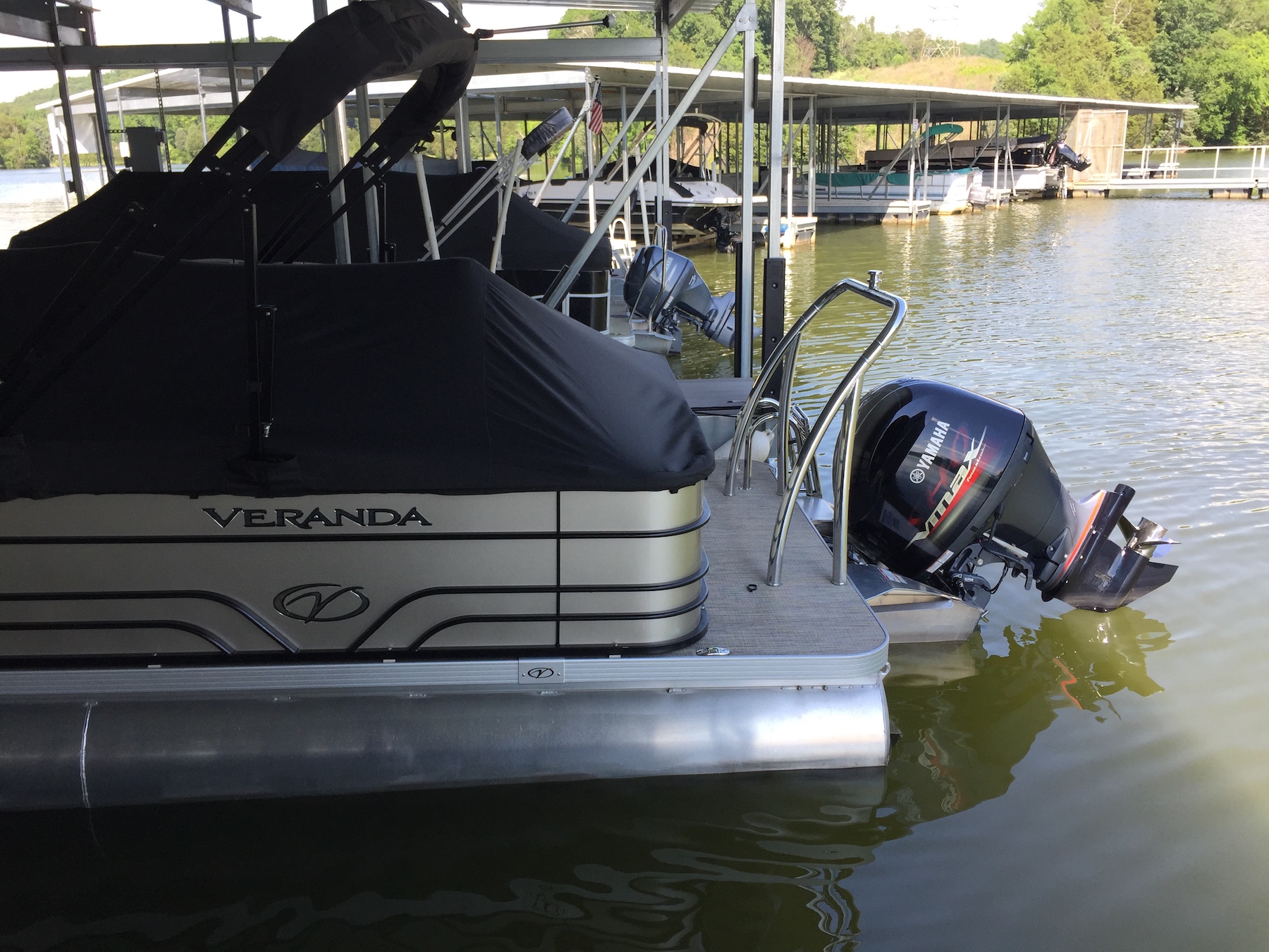

I just got a Veranda 2275 with a Yahama 175 Vmax and when docked ith lower unit is in the water about the same as in his photo. I am not sure if I have a 25" lower unitor not.
Still breaking in the motor an have only had it up to 4500 rpm getting 30 mph gps with two adults. It should do 40+ at 6000rpm.
- Lower unit is still in the water when fully raised

Re: New Boat Delivered-Motor Height seems off. Need feedback
That Veranda looks like a 20" motor, but I cannot be for sure. How does it make tight turns without the engine trimmed all the way up? Okay? We'd be interested to hear how that engine performs after break in, as we have not seen many such boat/engine combos. Most have had F150's or F200's on them.
Many boats that come with a 20" motor have transoms built for that height lower unit.
My Bennie has a 25" motor and it's set up 3/4" off the transom--one hole. When I trim the lower unit up to 3/4 level, it ventilates a little in a straight line upon accelerating--just like I like. When I trim the lower unit down and go into a tight turn, it doesn't ventilate at all--just like I like.
