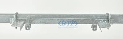

If your trailer has axle sliders, you need to move the axle aft of where it is bolted now, that will give you the extra tongue weight you need without moving the winch post and changing where the boat sits in the bunks.
- axle slider.jpg (3.96 KiB) Viewed 10930 times

[quote="FLOUNDERPOUNDER225"]If your trailer has axle sliders, you need to move the axle aft of where it is bolted now, that will give you the extra tongue weight you need without moving the winch post and changing where the boat sits in the bunks.[/quote]
This would be the preferred way to correct your problem.
Re: Hitch weight on pontoon
[quote="kryptonite"][quote="FLOUNDERPOUNDER225"]If your trailer has axle sliders, you need to move the axle aft of where it is bolted now, that will give you the extra tongue weight you need without moving the winch post and changing where the boat sits in the bunks.[/quote]
This would be the preferred way to correct your problem.[/quote]
Agreed, but if your leaf spring brackets are welded to the trailer, and therefore not movable, also the most expensive way to fix the problem. Then again, the best way, isn't always the cheapest way now is it.
