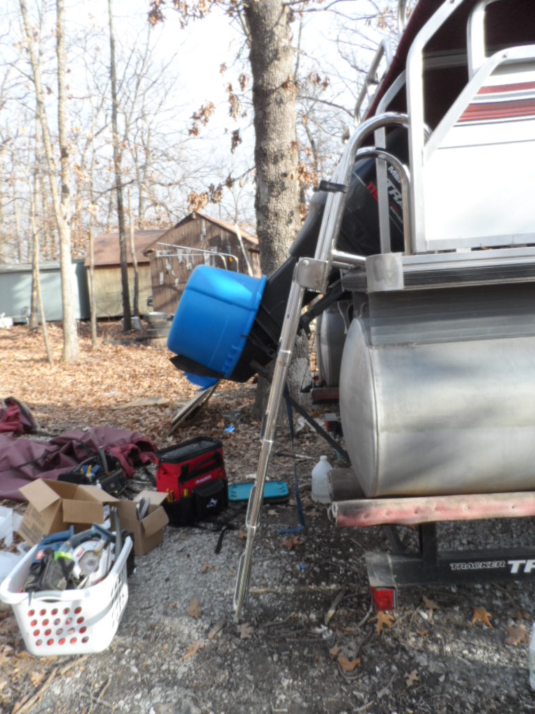

I would say whatever fits your trailer better. My pontoon takes a straight one. Best pic I could find right now.
- SAM_2567.JPG (238.03 KiB) Viewed 7007 times

Thanks for your response. How do you have it secured to the trailer. I really don't like drilling holes into the trailer but I guess I will have to.
Re: Transom saver question
mine has a hitch pin that attaches to mount on trailer. They make once that brace on trailer then you strap as well.
Cool thanks! I will check in to it.
Mine has a bracket on the end of it that sits on the trailer brace and I run a bungee cord around it. So I guess I have a strap on. Not sure that's something I should be proud of or not.

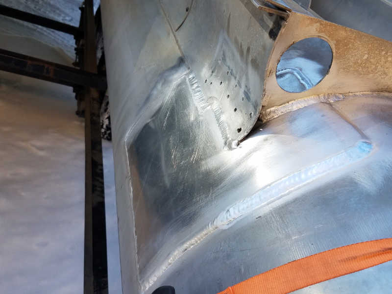

heres one reason to tilt the motor and use the support
the previous owner of my boat trailered it without supporting the lower unit, the bouncing on the transom did not hurt the transom but it did cause stress cracks where the mounts met the tube, i spent much time and effort repairing them.
so you are allowing a 300 lb plus motor just bounce up and down on the tubes, the metal fatigue will set in.
by using the motor support you eliminate a lot of stress,
i have been using a support under my motors for 35 plus years, never seen a supported motor get damaged, but i have seen an unsupported motor damage a boat or two.
these are the welds i had to use to repair my tubes from unsupported motor:
- 10.jpg (46.92 KiB) Viewed 6687 times
