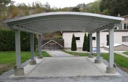

I would never use the mooring cover over the winter.
I just bought one of these to keep the elements off my boat.
