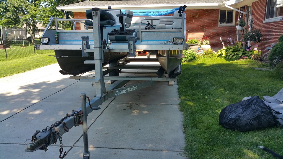

Nav lights. I'm looking at my Nav light up front and thinking... "that wouldn't pass a coast guard inspection"...
Why? I'll post a pic in a sec, but look at it. It's smack in the middle at the very front of the deck. The light is supposed to be visible in an arc that extends aft a bit. Those side "wings" from the fence are blocking the lights even at 90 degrees from their location.
I'm certainly not going to chop off the fence. Should I be looking at side mount lights?

That's definitely a violation. Just mount a pair of the standard teardrop R & G lights on the cast corner pieces.
It looks like there's enough room beside your docking lights. There are much smaller LED docking lights available & they don't need to be 50W driving lights that project a mile.

[quote="guy48065"]That's definitely a violation. Just mount a pair of the standard teardrop R & G lights on the cast corner pieces.
It looks like there's enough room beside your docking lights. There are much smaller LED docking lights available & they don't need to be 50W driving lights that project a mile.[/quote]
The docking lights came with the boat. I'm not married to them. I'm TRYING to do stuff slowly so I don't sticker shock the wife, but you know how it is when you get into stuff and go.... "that shouldn't be like that"

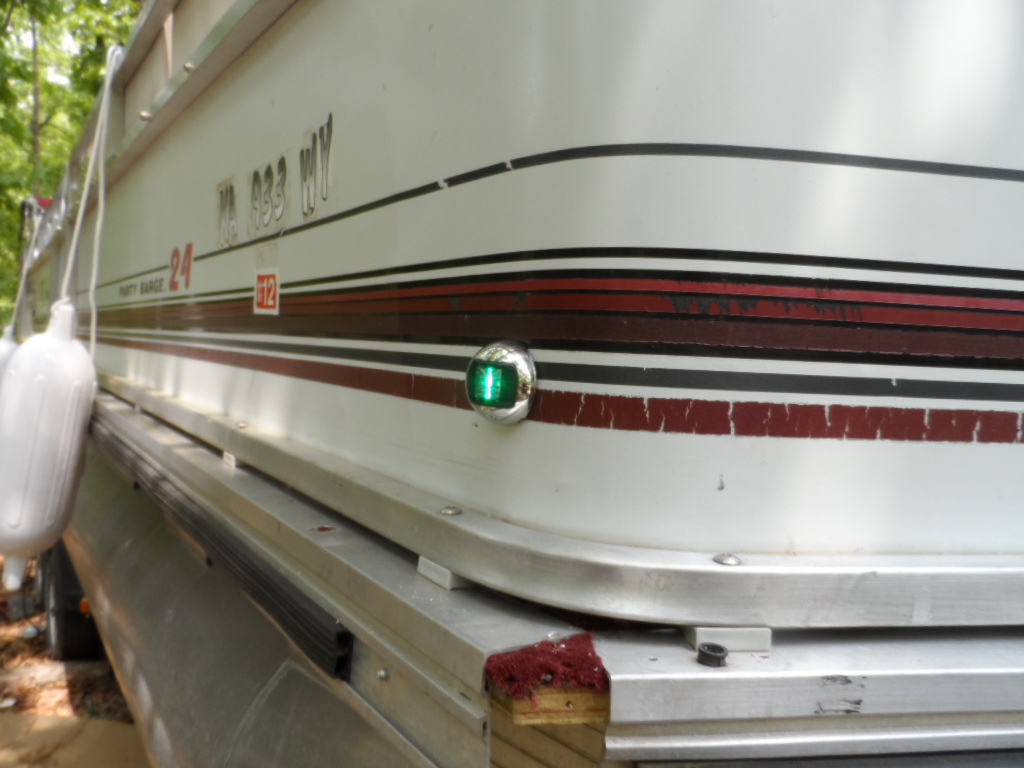

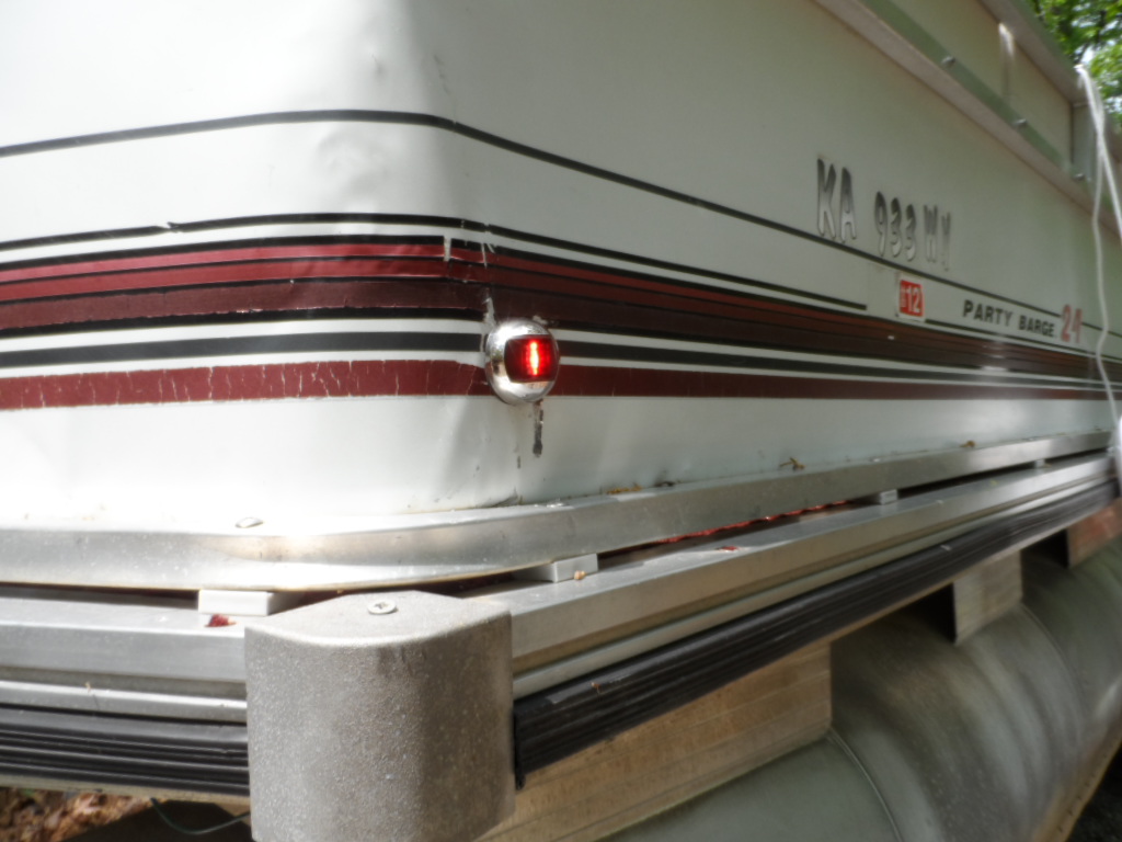

You can find LED Red/Green Running Lights that are about the size of half a golf ball that are depending on model designed to fit either vertical or horizontal, mine are the vertical type and mount directly to the side fencing...

[quote="teecro"]You can find LED Red/Green Running Lights that are about the size of half a golf ball that are depending on model designed to fit either vertical or horizontal, mine are the vertical type and mount directly to the side fencing...

If you have a pic of your nav lights, I'd be interested. I'm looking. The corner braces at the front of the deck are not very big. I'm also thinking about things like dock rash. Don't wanna have them acting like bumpers after I tie up and leave.

Your nav lights need to be visible from clear ahead to 120 degrees toward the stern. If you are going to replace them think about led lights. Sometimes the fixtures that come with led can be pricey, but companies like Mr LED have replacement less that can go into traditional housings at a reasonable cost. Look for the Coast Guard approves label as they also need to be visible for a certain distance.
