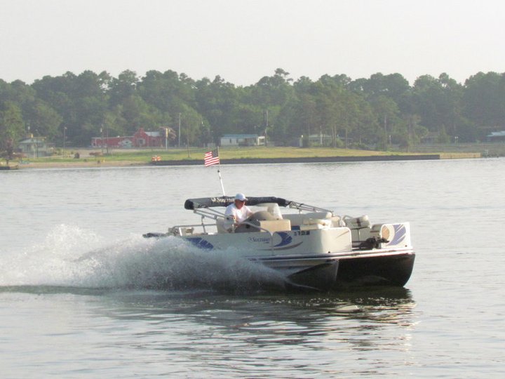

Hi-welcome aboard! I'm running a 13 x 16 pitch on my 20 ft Lowe SS204 with front and rear fishing seats--so only a trolling motor and fishing seats up front----so I can trim up pretty good. My SS prop gets me 27 gps on my 90 Merc Optimax. Strangely the same prop specs in my spare aluminum prop gets me 28-29 with just me in the boat--go figure...
My motor gives overrev alarm at about 5850 rpms-so I can run right at max rpms and get my speeds--which I like. I repitched my SS prop to 17 lower Wide open rpms and actually lost speed at max rpms of around 5450-so repitched it back to 16. btw--have had my SS prop rehubbed twice---spun out my hubs --prop really works hard on a pontoon-like pushing a giant dumpster through the water! Esp 2 toon without lifting strakes.
Re motor setup-set motor so cavitation plate when motor is tucked all way in is even with bottom of motor mounting pod---too low and you will throw water around lower unit which will slow you down-too high and you will blow out and cavitate ==esp if too much weight in front of boat. Good luck!
Enclosing pic of mine at 27 gps==moving lots of water!
