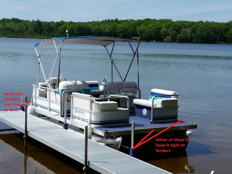

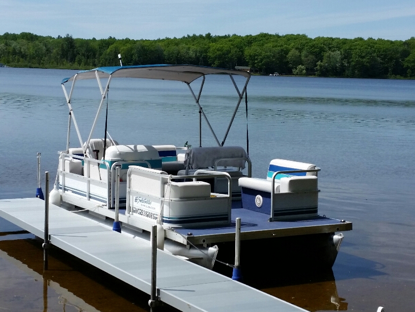

I just throw a hooped line from each corner of the boat over 2 of my dock posts & adjust the length (permanently) so they're tight. Lake level is kept constant by a dam. Weather can be a problem anywhere but here in the Midwest we don't get the extremes seen in coastal states.
I'll experiment with criss-crossing the lines to see if they can be made tight enough to keep the boat against the fenders, but not so tight that a wake will rip my dock posts out. My dock has 10-foot sections so the posts are that far apart. Kinda limits my attachment options but I'd rather not bolt on cleats because they interfere with stacking my sections for the winter.
- 2018-06-15 09.16.33.jpg (374.52 KiB) Viewed 12316 times

Why not tie front off here or here to tighten to fenders? Tie back to trailer tie down on starboard side, untie from post and coil inside rear of boat, then just tie off at post when you get back inguy48065 wrote: ↑Fri Jun 15, 2018 6:04 amCleats? My boat & aluminum dock have none & I've never seen any on any of my neighbor's docks, either. Funny how in a "lake community" you often see the same brands of boats, trailers, and see everybody doing everything the same way.
Re: How many dock lines?
Hmmm...I never considered tying to one of the rings on the far side of the boat. I'll give that a try & see if that gives me more control.
Can't see it in the photo but there is a 3rd line I use at the last pole. It's wrapped loose and is really there for redundancy since I live 200 miles away & can't keep watch on it when storms blow through.
You mention "tight to the fenders"--is that the goal? Maybe my approach is all wrong but I thought the goal was to leave slack in the lines so the boat is free to adjust to changes in level (wakes, wind-driven level changes, etc), but still keeping it short enough to not have a big gap to step over. Should I be tight to the dock...maybe use those "dogbone" stretchy things on the lines?
