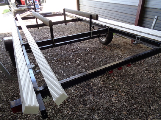

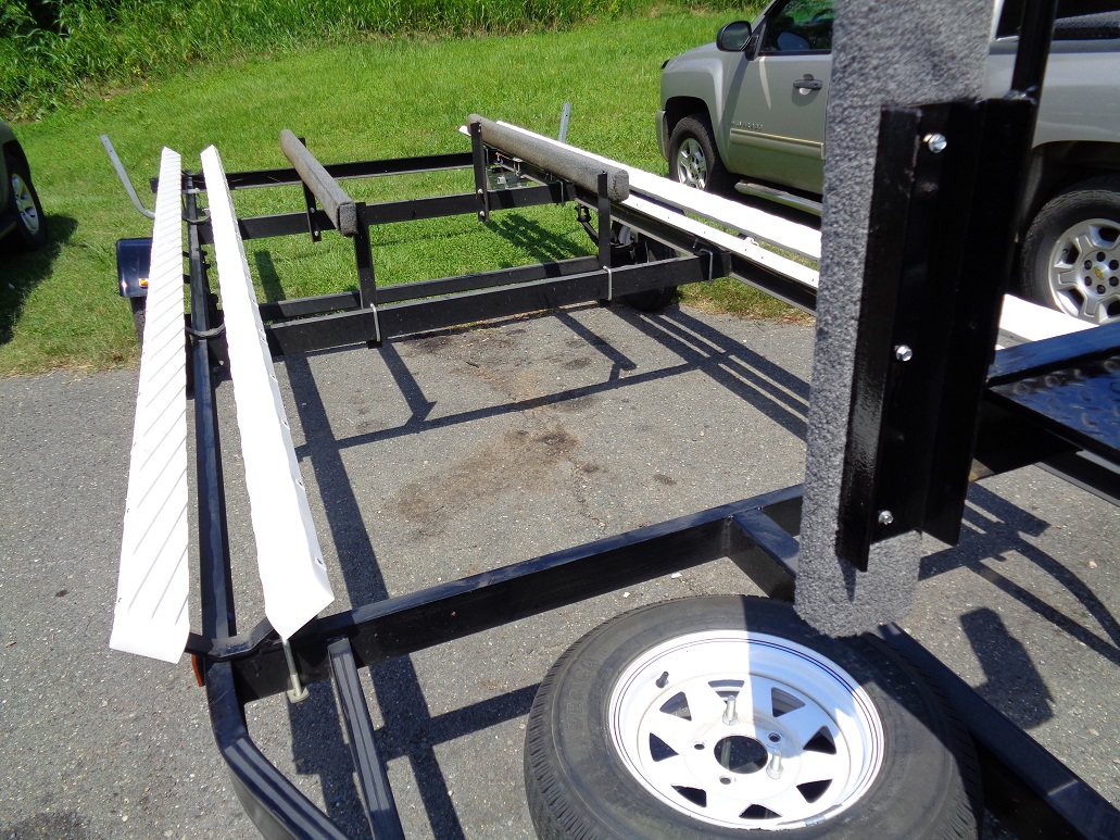

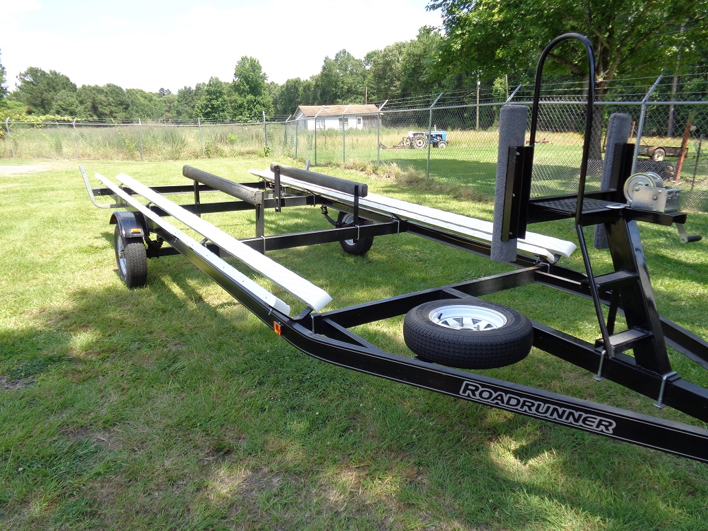

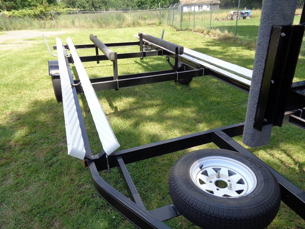

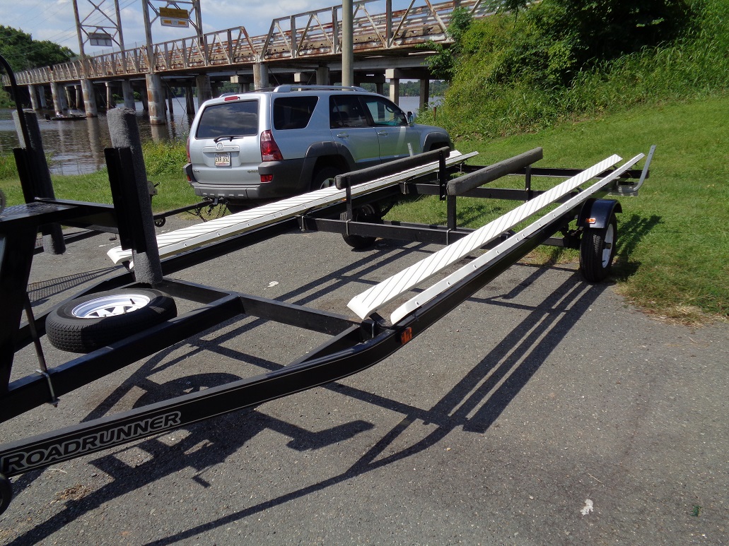

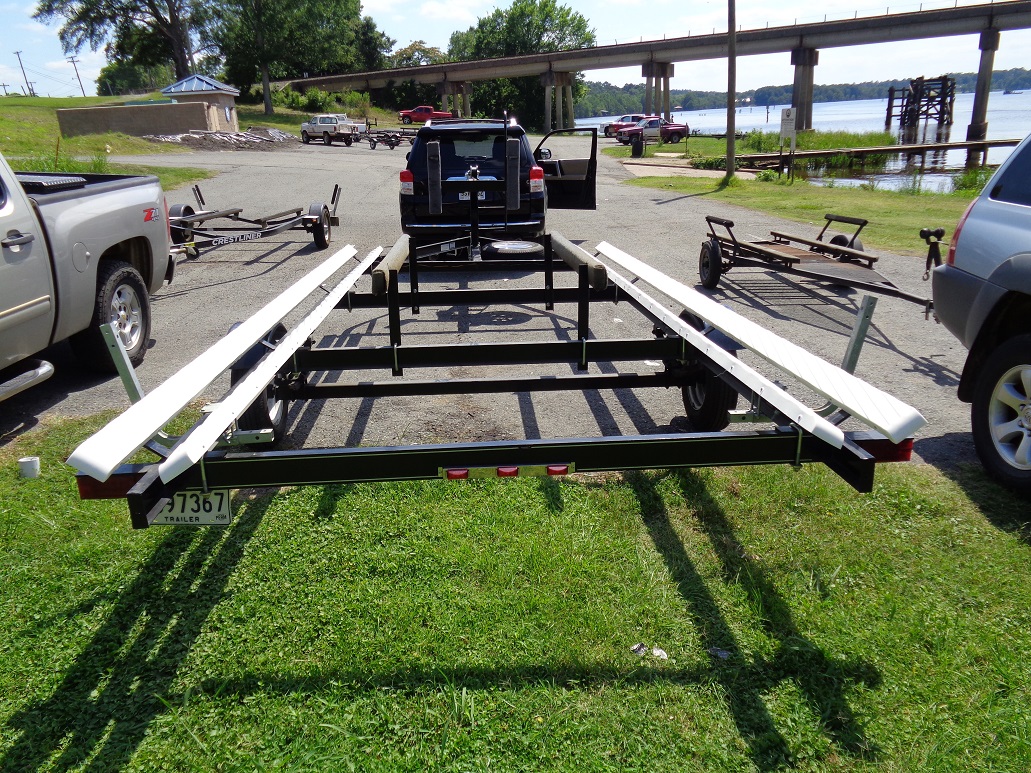

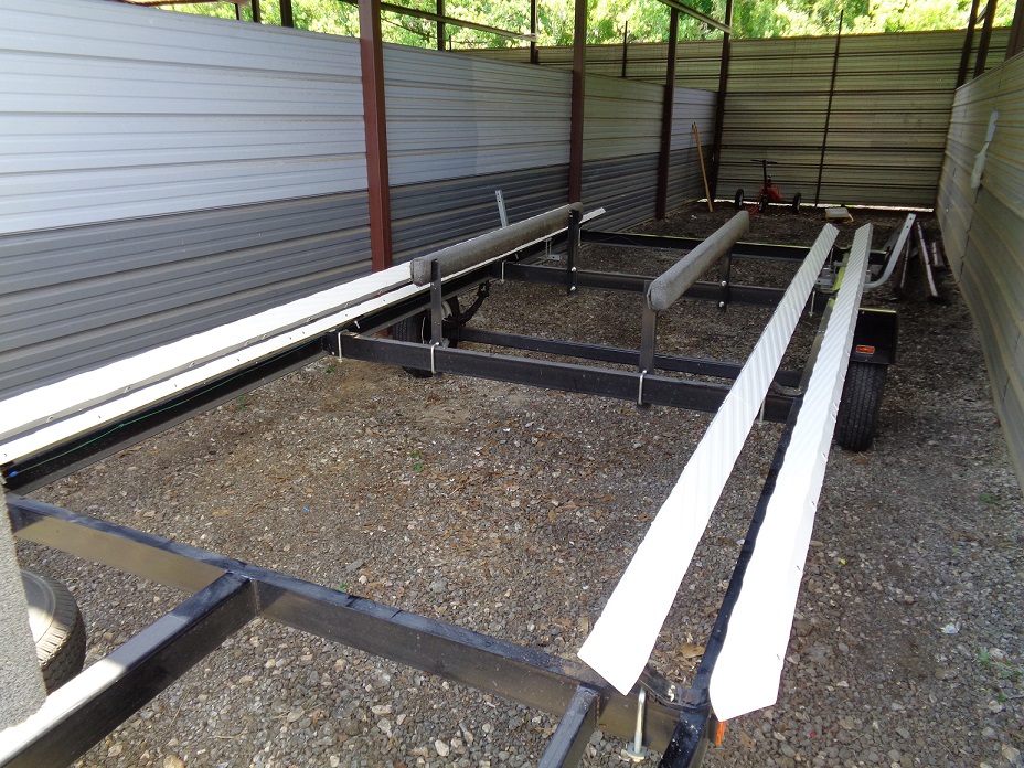

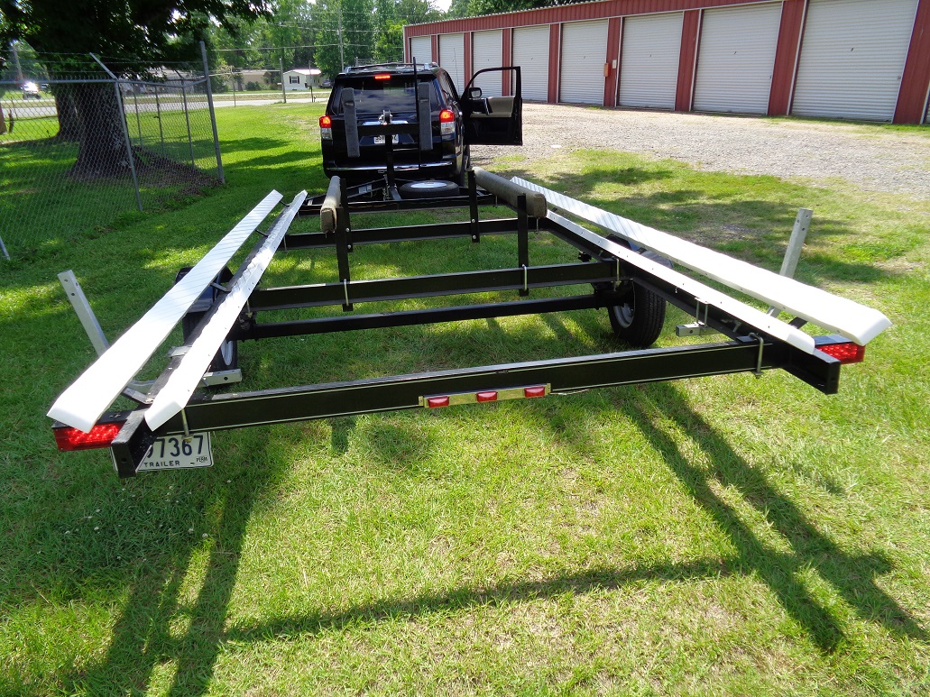

Glad you asked as this is something I encountered 2 years ago.. Got ready to take the boat out one day and noticed that one of my bunks was rotted and the carpet, while still useable, wasn't in the best of shape.. since I had to replace my bunks I decided to go ahead and get rid of the carpet altogether. After I bought new bunks i also bought some new polymere plastic glide ons. The ones I bought are made by a company called Tie Down Engineering.. the model number for these in case your interested is 86162. and these work GREAT.... I did all the measurements and pre cuts in my garage and then installed the bunks and bunk glides the next day.. took me about 6 hours.. anyway I think they look good, they work perfectly and hopefully I'll never have to deal with this again.. My son liked them so much I ordered several sets for his pontoon boat.. again in case your interested the best price I found on these was around $42 a box from black bear sporting goods. Each one of my bunks is 16' long so a total of 32'. Took 4 boxes to do mine. I love em. Hope this helps... I've put in a bunch of pics so you can see them from just about every angle. Now just in case you don't want to take this project on, you can always use a spray lubricant on your carpeted bunks. Up until the time I decided to change out the bunks, I always usesd a product called Liquid Rollers... Just saturate your carpet with it once a month or so. Works okay, but not nearly as well as the plastic bunks.

New polymere plastic bunk glides installed and ready to go    6-10-2017 (10).JPG
New polymere plastic bunk glides installed and ready to go 6-10-2017 (10).JPG (501.01 KiB) Viewed 12614 times
New polymere plastic bunk glides installed and ready to go    6-10-2017 (9).JPG
New polymere plastic bunk glides installed and ready to go 6-10-2017 (9).JPG (399.89 KiB) Viewed 12614 times
New polymere plastic bunk glides installed and ready to go    6-10-2017 (7).JPG
New polymere plastic bunk glides installed and ready to go 6-10-2017 (7).JPG (504.74 KiB) Viewed 12614 times
New polymere plastic bunk glides installed and ready to go    6-10-2017 (6).JPG
New polymere plastic bunk glides installed and ready to go 6-10-2017 (6).JPG (436.62 KiB) Viewed 12614 times
New polymere plastic bunk glides installed and ready to go    6-10-2017 (5).JPG
New polymere plastic bunk glides installed and ready to go 6-10-2017 (5).JPG (456.34 KiB) Viewed 12614 times
New polymere plastic bunk glides installed and ready to go    6-10-2017 (4).JPG
New polymere plastic bunk glides installed and ready to go 6-10-2017 (4).JPG (331.87 KiB) Viewed 12614 times
New polymere plastic bunk glides installed and ready to go    6-10-2017 (3).JPG
New polymere plastic bunk glides installed and ready to go 6-10-2017 (3).JPG (164.72 KiB) Viewed 12614 times

I don't know if they would fit over the existing carpet or not but I wouldn't put them over carpet. One of the benefits of getting rid of the carpet is that carpet stays wet a long time when you pull your boat out of the lake, and that wetness can hasten rot in your bunk boards... with the plastic system bunk boards still get wet, but dry out much much faster.. Also in my case I didn't strip the carpet off.. my bunks were rotting so I just replaced the entire bunk board.

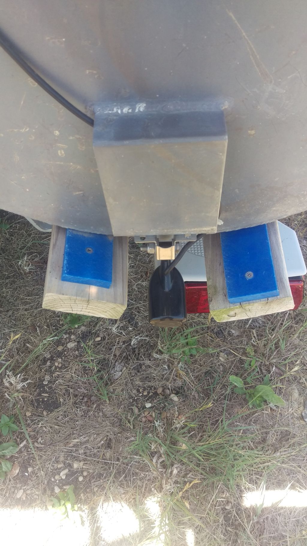

Been about 5 years since I did mine, but check with superslide.com. They used to sell 2 inch wide x 5 ft long scraps of their Blue Iron product. You should be able to search this forum for "Blue Iron" and find old posts. Very slick stuff and I installed it over treated lumber.
