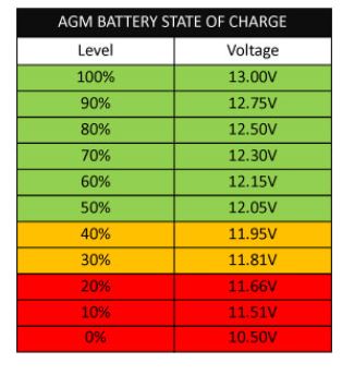

That is a great chart for conventional flooded cell batteries, and folks who use them should memorize the numbers.
AGM's are very different.

First, thanks to everyone for their contributions and information. This is an interesting thread that is probably going to increase the scope of my stereo project, because I'm probably going to add a voltmeter, power distribution block and more. But for me, doing these kind of projects is half the fun of having a boat!
After looking at the chart jrolin1 posted and seeing Mark K's comment that AGM's are different, I went in search of a similiar charge specifically for AGMs. Of course, I found numerous charts for all kind of batteries, and most of them differed from each other, regardless of battery type. Here's one I found for AGM's, but who knows how accurate it is.
The way we'll use our system will be similiar to jrolins, so I probably don't have too much to worry about, but I usually overengineer stuff rather than just assume things will be OK. LOL

That is why I posted both. Is the AGM not visible? I see it is not when I looked in another browser. It shows up in Chrome but not edge. Strange. It was the same one Steve has. Next time I will do it as an attachment.

Steve,
This is a brand specific thing, but your chart is exactly how many of the higher end AGM's are - but.............. 10.5v is 0% remaining when measured under load. The other numbers are "at rest."
If you discharge down to 10.5v then disconnect the load and let the battery sit, it will gradually rebound to around 11.2v to 11.6v. Same thing happens at other points on the discharge curve. So, if you find a battery that is reading 11.2v or lower in a resting state, it is fully depleted. If lower, it is already being damaged.
Sulfation of the plates begins with a standing voltage somewhere between 12.5v and 12.6v for most deep cycle AGM's (80% - 85% state of charge) and rapidly accelerates at lower charge levels.
Temperature has a very, very small impact on standing voltage at 0.6 mv per degree F. (About 0.05v at 0 degrees F)
Have you calculated the amperage draw and what to expect in terms of battery voltage? (The sag in voltage under load.)
Example: A pair of Group 27 (100 ah each) battery bank at 90% charge may read 12.4v while running under a 50 amp load and 12.7v with a 20 amp load.
Deka is different vs. Odyssey vs. Optima vs. Lifeline vs. FullThrottle, etc.
Marc
Marc

Understood! I just fired up Chrome and the AGM chart shows above the flooded.
(Can't see it in Firefox)
Marc
