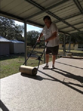

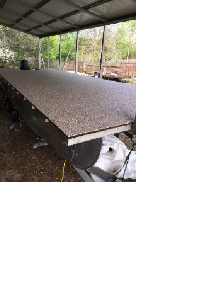

Refurbishing my 1996 Landau Bt-20, Cleaned pontoons, new deck and added vinyl flooring. I will try to post pictures as I go on this rebuild.I built my roller with form tube that I saw on this forum cant find the original post to give credit so if anyone knows who originally built and posted it give some credit. I'll keep looking for it.

Just finished trimming vinyl everything going well up to now.Trying to decide if I should cut holes or put trim on first. Looking to see if my control cables will fish through holes because there is not much space on Landau between pontoon logs and deck since I am rearranging the furniture and moving console back 18" from original I may need to get creative.

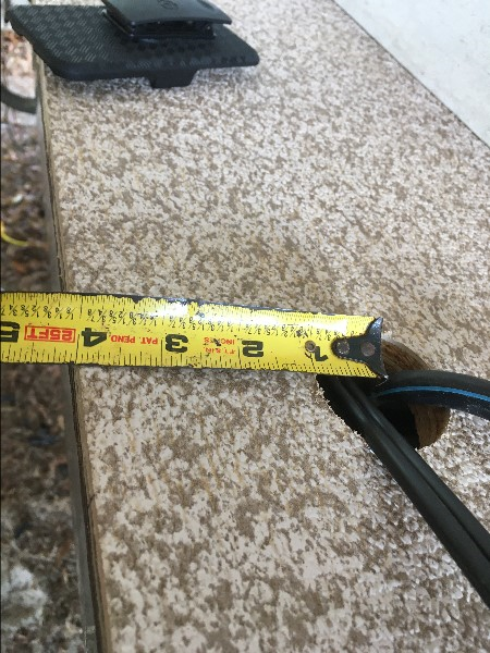

After looking at the measurements on the original hole for the shift/speed control cables the hole was cut 10 1/2" inches from the edge. I was going to set mine up the same way as original but decided against it, I was concerned that the original way the cables were ran would make it difficult if I ever had to replace them so I will come up through deck and have cut 2" hole 4" from edge to center of hole try to come up with something to cover them. The cables were easy to pass through deck without any excessive bending.

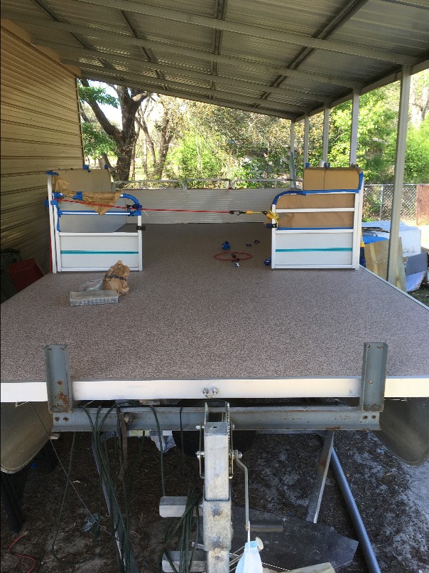

Starting to add rails on boat.

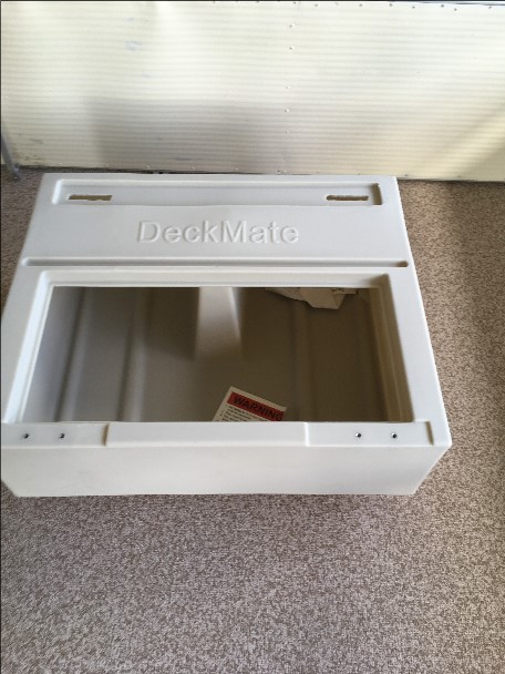

Deckmate furniture is unpacked and starting to put them together. Some notes about the slots in bases for the backrests. The slots were routed about 3/4" wide and the fender washers supplied are about 1" wide this causes the washer to slip through the slots and does not hold seat backs well. I purchased 1.5" fender washers to fix this and it worked to hold them more secure. You can see the slots in this picture.
