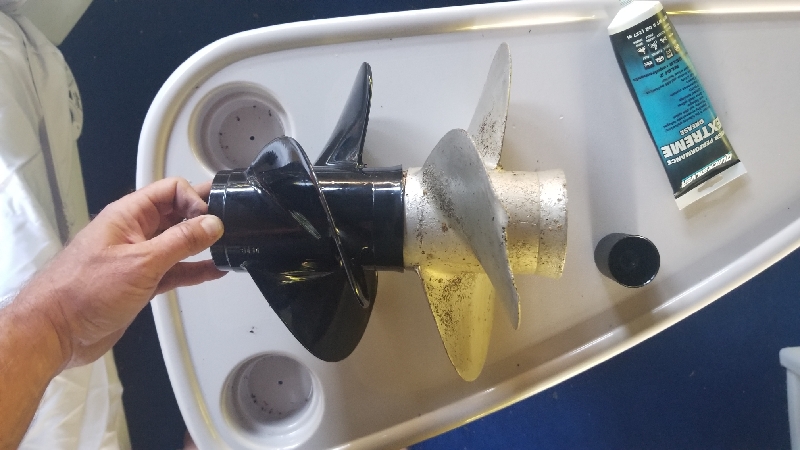

So new prop arrived today!!! I just came back from installing it. I didn't take it for a drive today, going to do that tomorrow, but there will be a difference. Take a look...the silver one is the one that was on the motor when I got it:
I couldn't get the numbers off the old prop, it was way too pitted so I have no idea the pitch.

Well I was able to take the pontoon out twice this weekend...so with 3 adults and one teenager the pontoon was able to hit 17mph and right at 5000rpm. to say I am happy would be an understatement. before the prop change 12mph maybe 13 if the conditions were just right was the most I could get plus WOT was 1000+ rpms too high.
now the issue i have to deal with since I am going faster is I'm getting a lot of wake spray from the back of the pontoon, it just shoots through the side opening where the control cables go through at. Just like normal....you fix one issue and create another...
