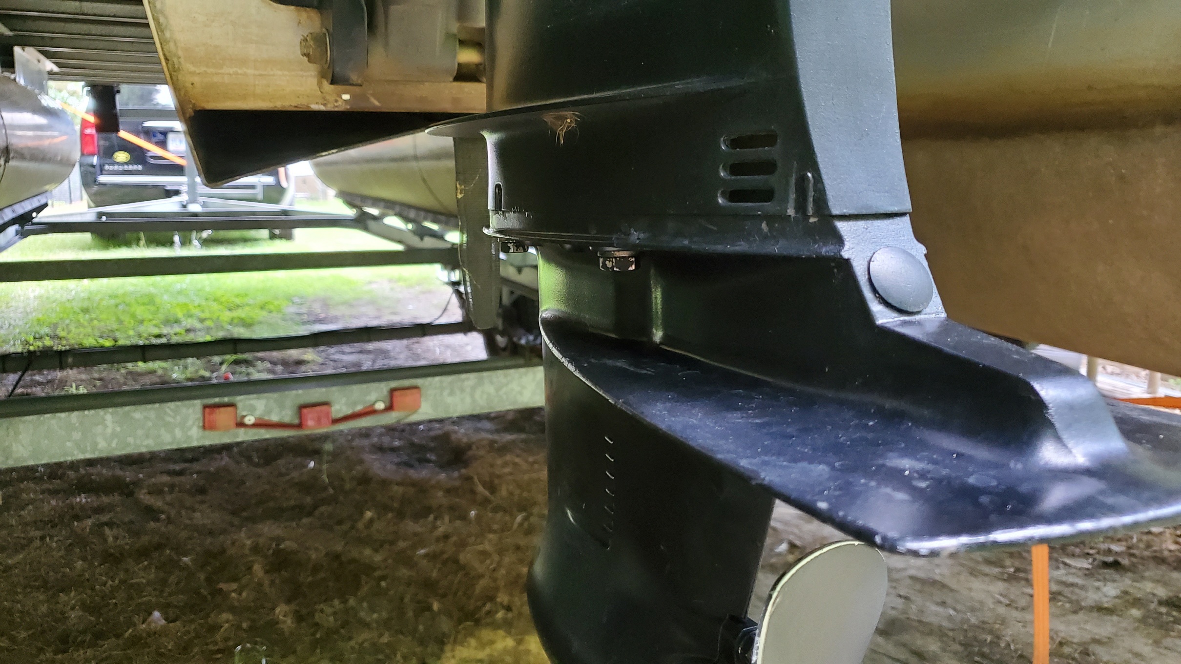

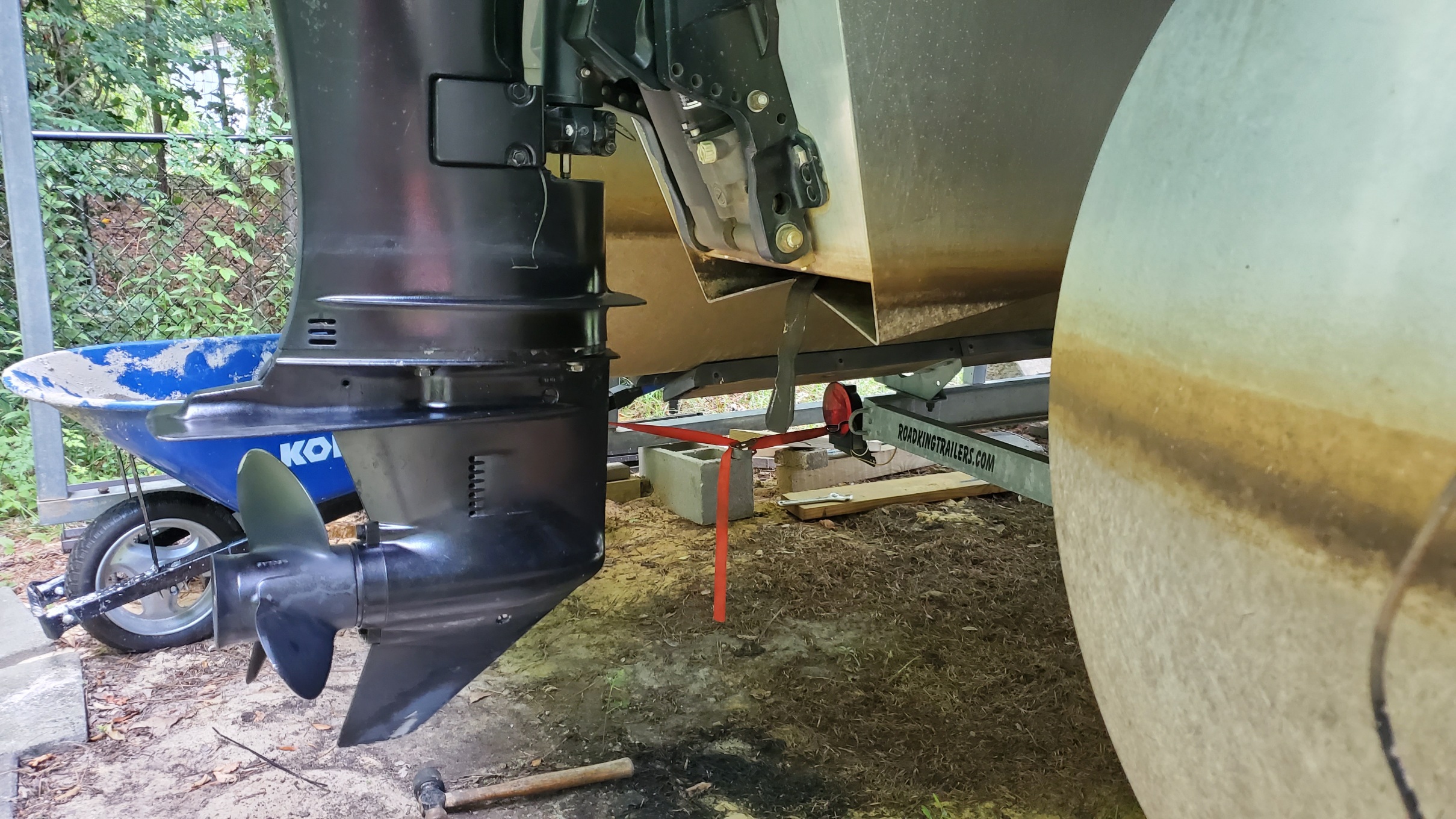

ImageI have a 2002 Palm Beach pontoon with a Mercury 50. Does this motor seem to low? I can be underway on the water and it will run fine the it blows out all of a sudden. Rpms go up and boat slows down. Back off throttle and back to cruising. It happens at random times. I thought maybe the motor is to low. Please help thanks

Sounds like the motor is too high. Drop it down a hole or two and see if that helps.
Is the bottom of your transom bent up on purpose? I don't think I've seen that before.

i've been fighting with ventilation issues myself. I have a 60hp merc that was mounted at the top holes (motor at the lowest setting). My cavitation plate was pretty low compared to the bottom of the transom. I raised the motor two holes and saw a little bit of difference in a good way. raised it up to the two final holes and I think we're good. at WOT I can see the cavitation plate . I also have reduced water being flung over the motor.
so I say raise it up!

Your cavitation plate should be at or near bottom of mounting pod--you look--5-6 inches too low it looks like. Solutions if you cant raise it are to get a shorter lower unit motor or use blocks to raise transom as long as you can still use the upper mounting holes

Sorry Wwind but that’s not correct. On a tri toon the cavitation plate should be in line with the bottom of the toon same as a mono hull but with a pontoon the cavitation plate height varies greatly depending on the boat design and weight distribution. He has already said that he is blowing out at top speed so he need more water not less. Since he cannot go lower without replacing his lower unit a hydro foil is his best chance. That or modifying his transom to get the engine lower.

Joseph was commenting about a tritoon but you have a regular pontoon (you don't have the third pontoon leg) so that doesn't apply to you. I still say to raise it up...your motor and my motor look like they were in the same spot, kinda low. I raised mine all the way up (but did it a little at a time) and now it's running like it should...so far no blowouts and rpm's increasing.

Looks like a motor with a 25" shaft on a boat/transom made for a 20" shaft. Agree with wwind3 on the reason for the blowout.
