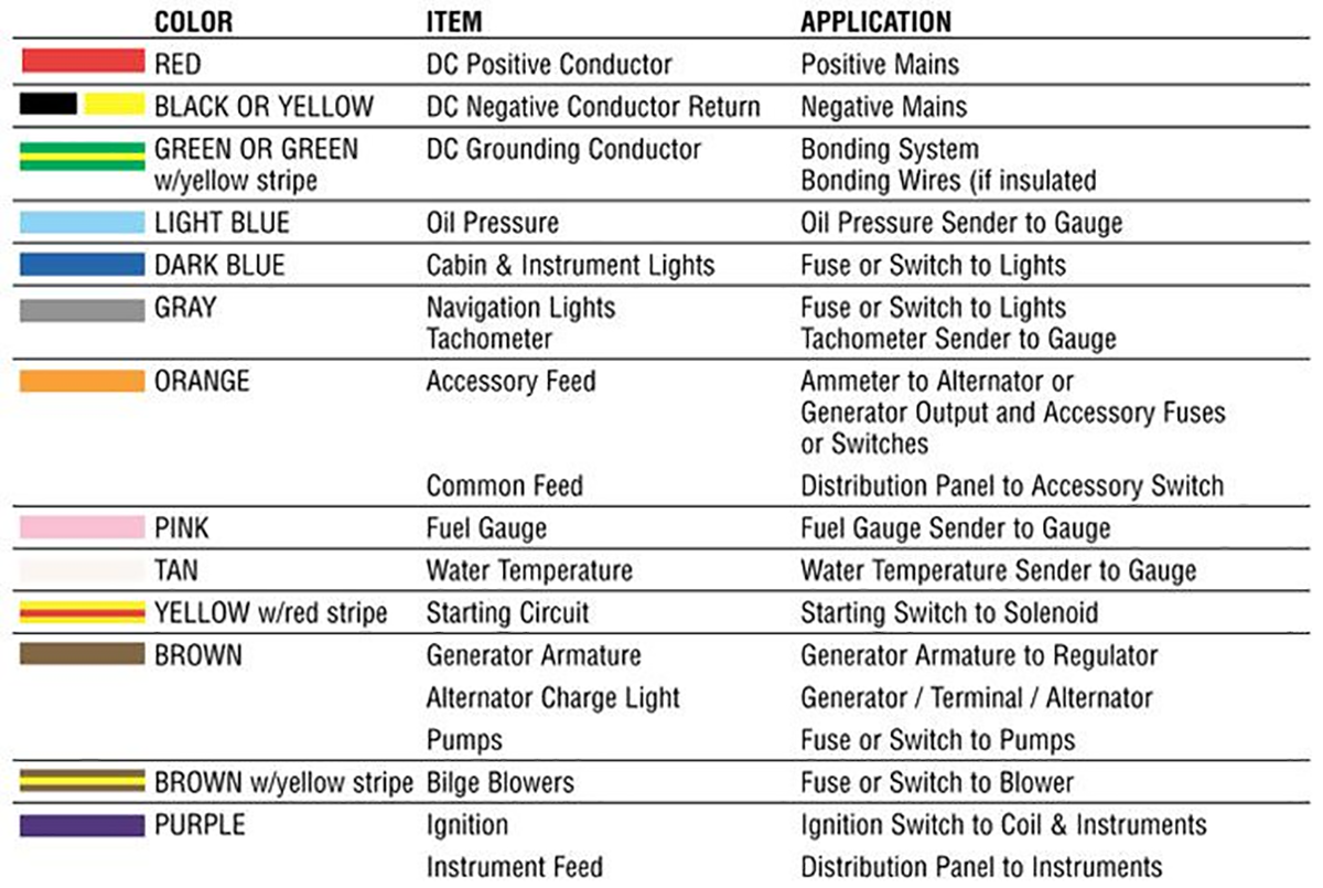

Can't tell too much from the pic, but checking the wire colors against a chart may help lead you to the answer. It might be wiring from an old set up - motor, accessories, etc.
From what little I can tell from the pic, it looks like there's a green, orange, black... maybe more.
See if this is of any help. There are other charts online. The colors are the same, but some may have more detail.
wire color chart.png (634.46 KiB) Viewed 22222 times

mgarvie might be right. It might be part of the wiring harness from an earlier set up. I tried blowing up your picture and it looks like there might be a grey wire hiding in there. That would normally be the tach wire. Check the wiring runs from your gauge panel and other fixtures to make sure they go somewhere.
Motor issues I am NO help with.
