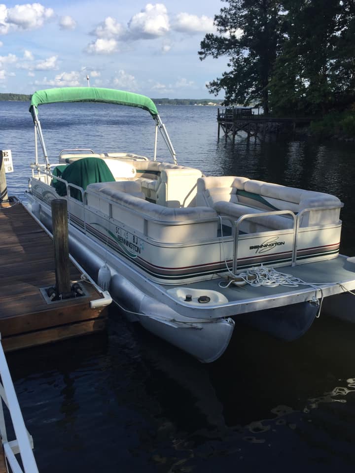

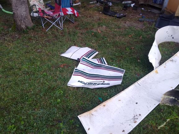

#1 Post by jrolin1 » Tue Oct 27, 2020 6:04 am

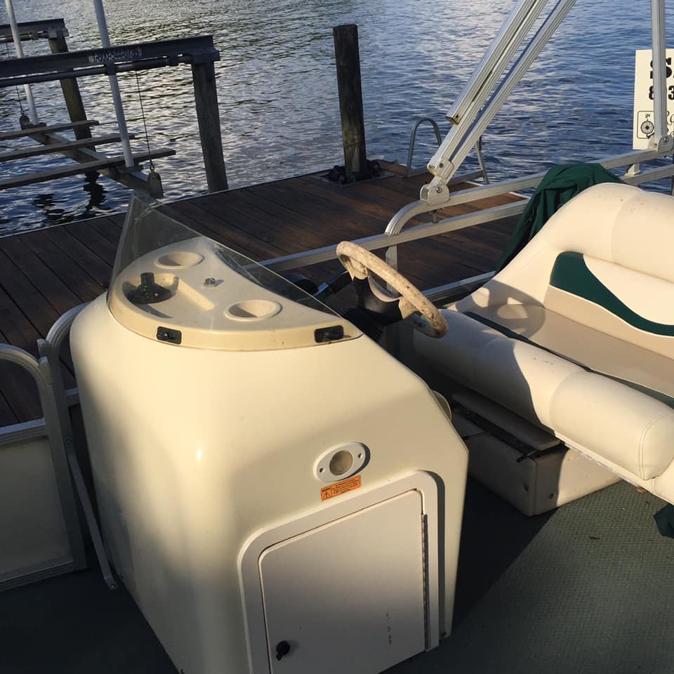

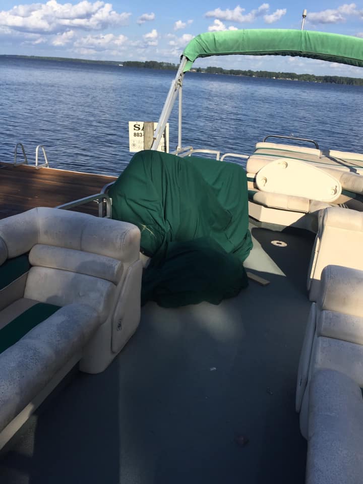

I bought a 2000 2575lx Bennington tritoon with sport package and underskinning. Carpet had a hole in it. Seats were a little sunburned. Siding in poor shape. Time for a lot of work.

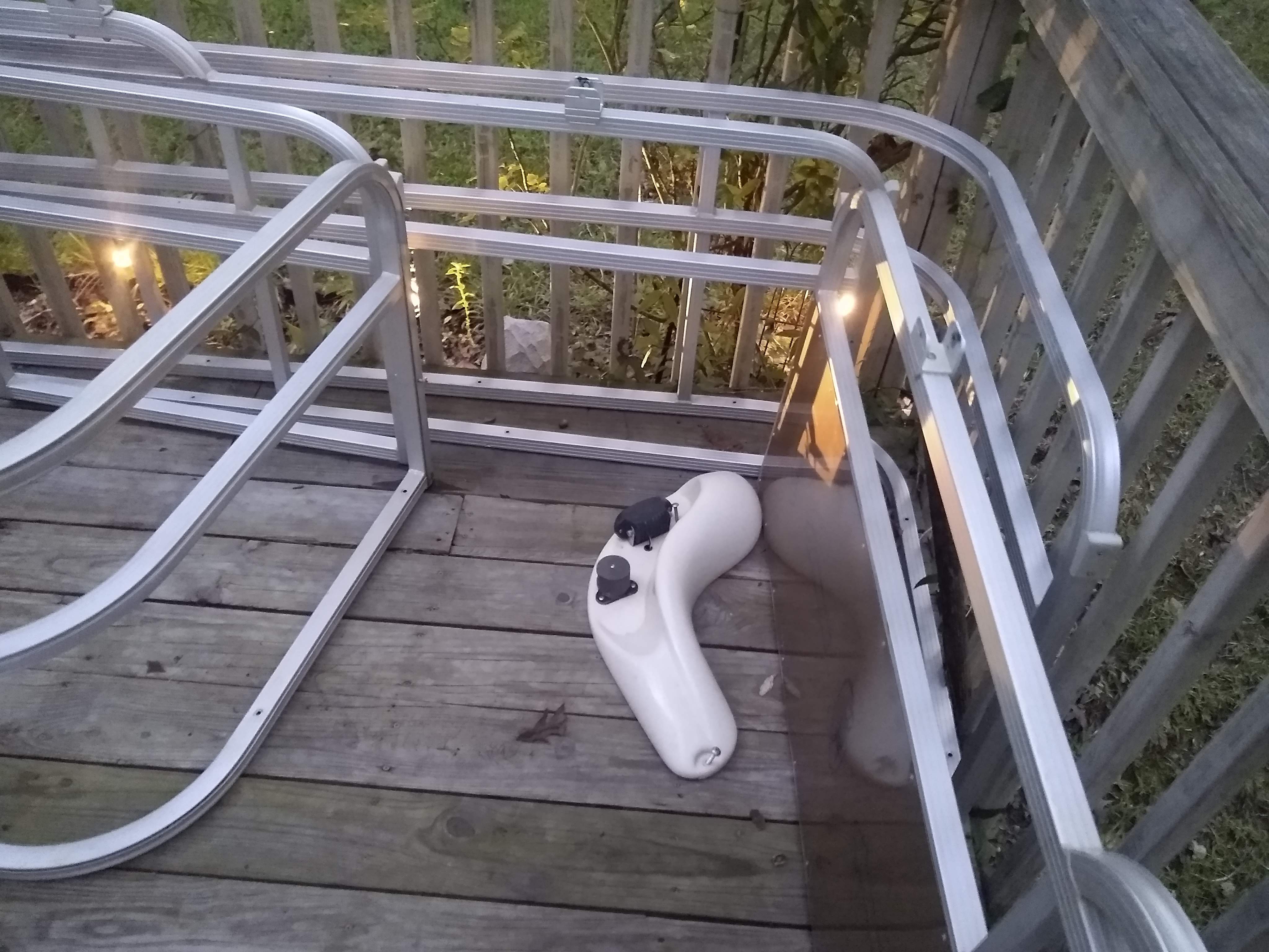

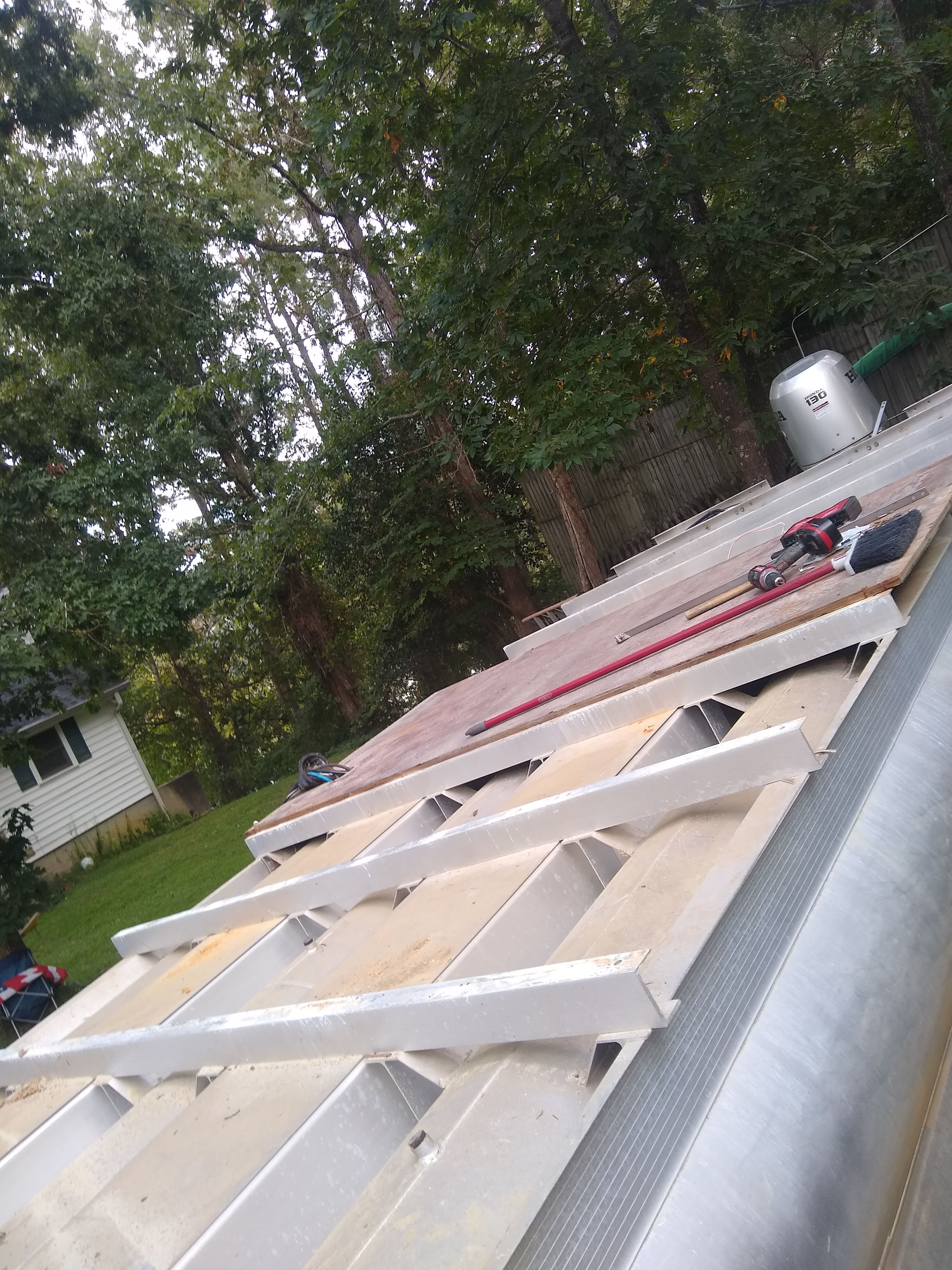

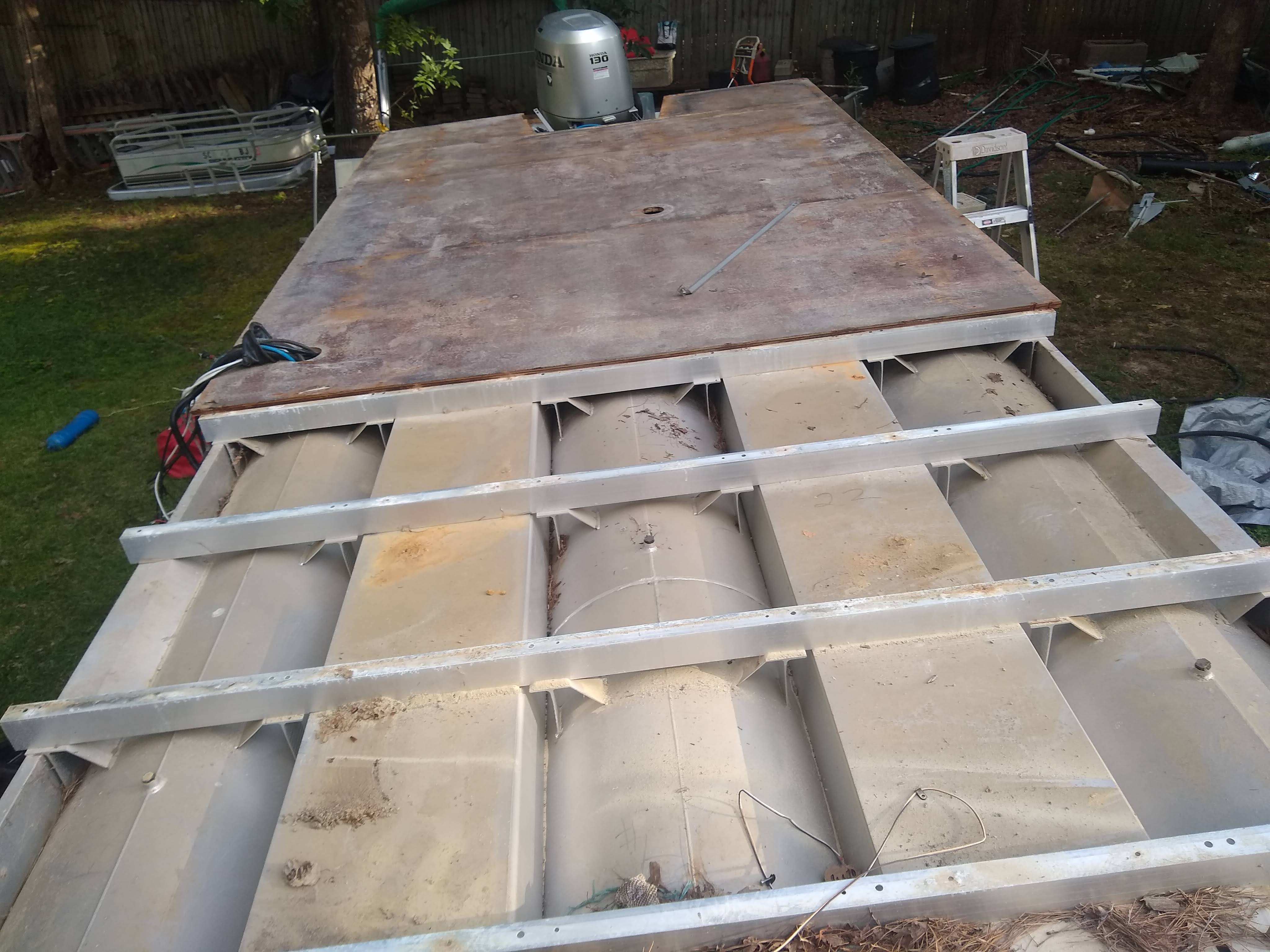

#2 Post by jrolin1 » Tue Oct 27, 2020 6:15 am
Disassembly time.

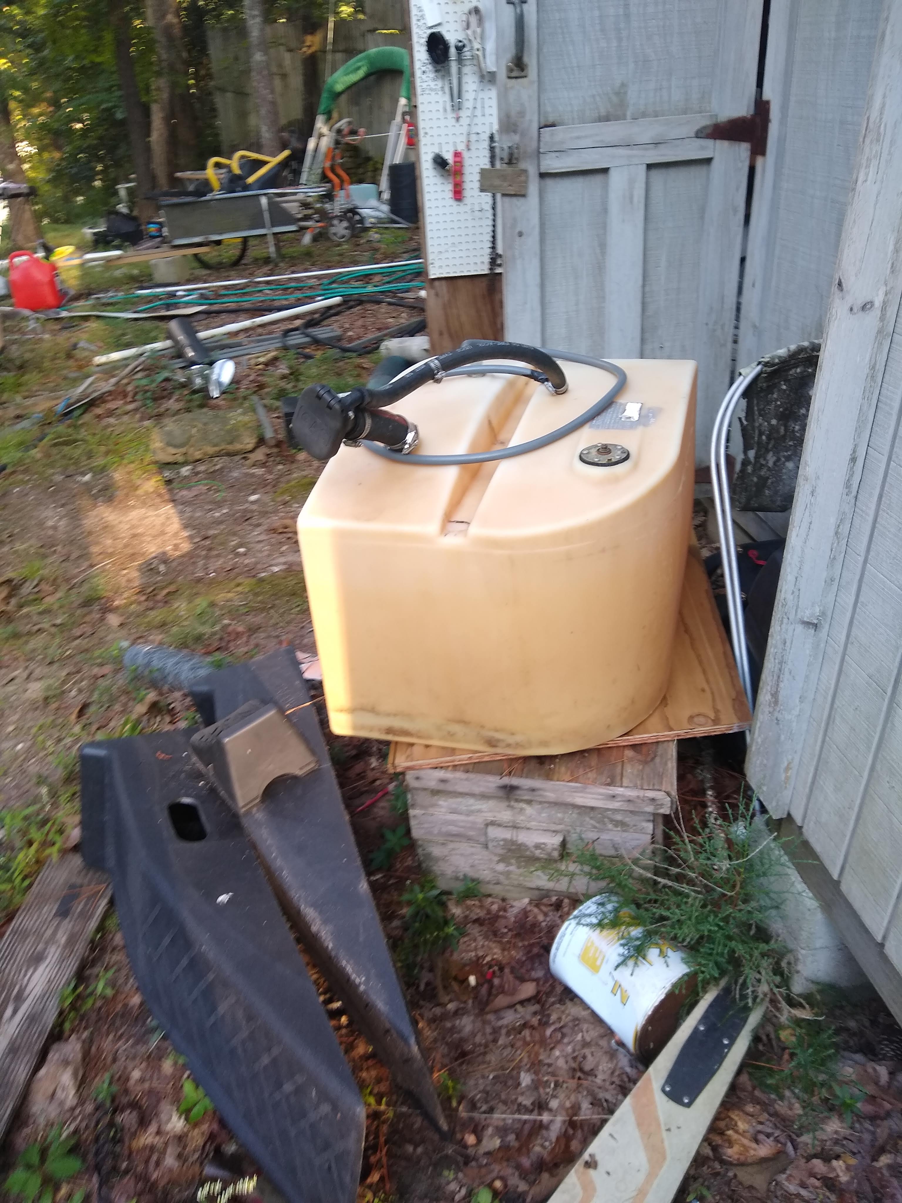

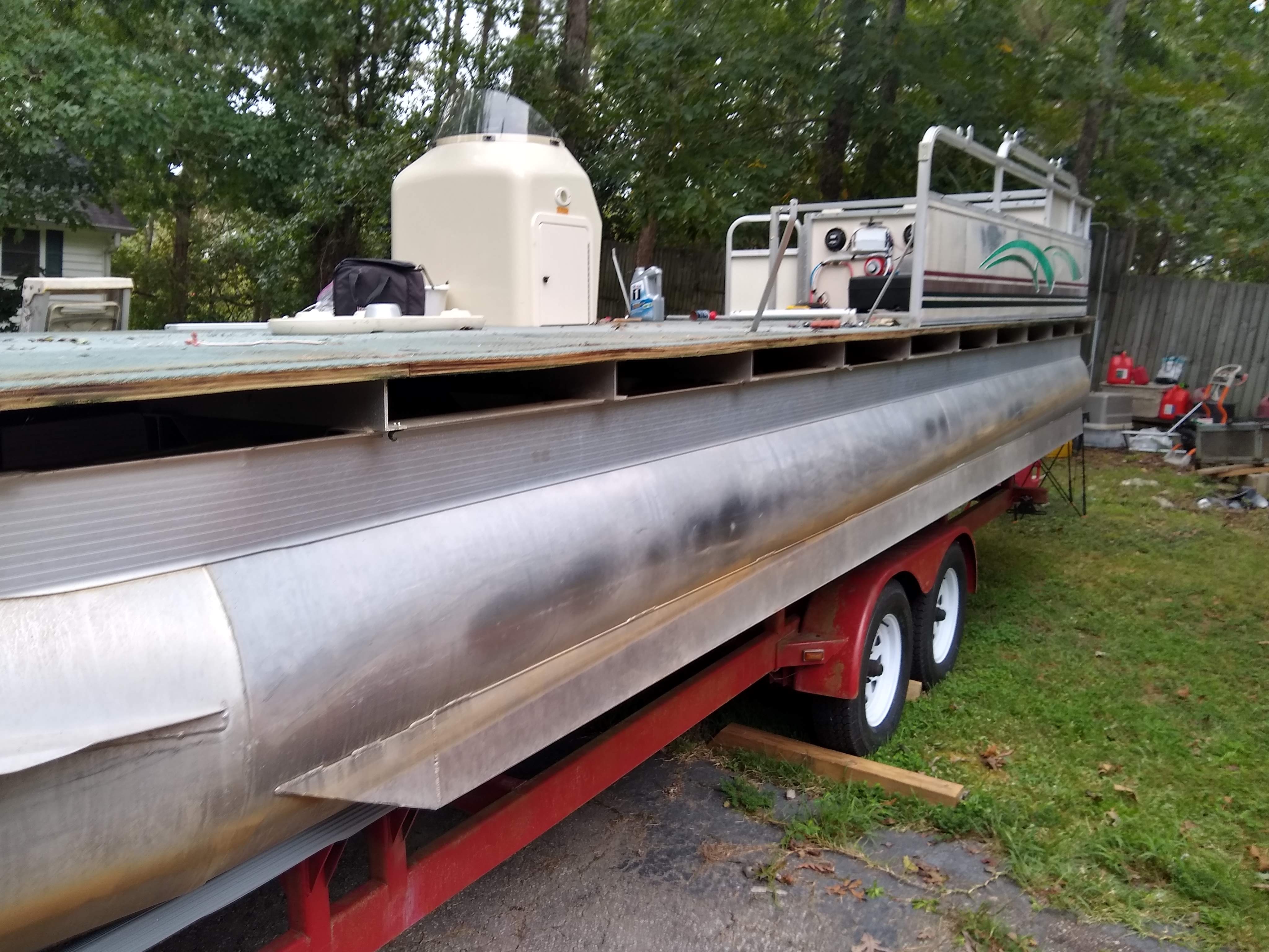

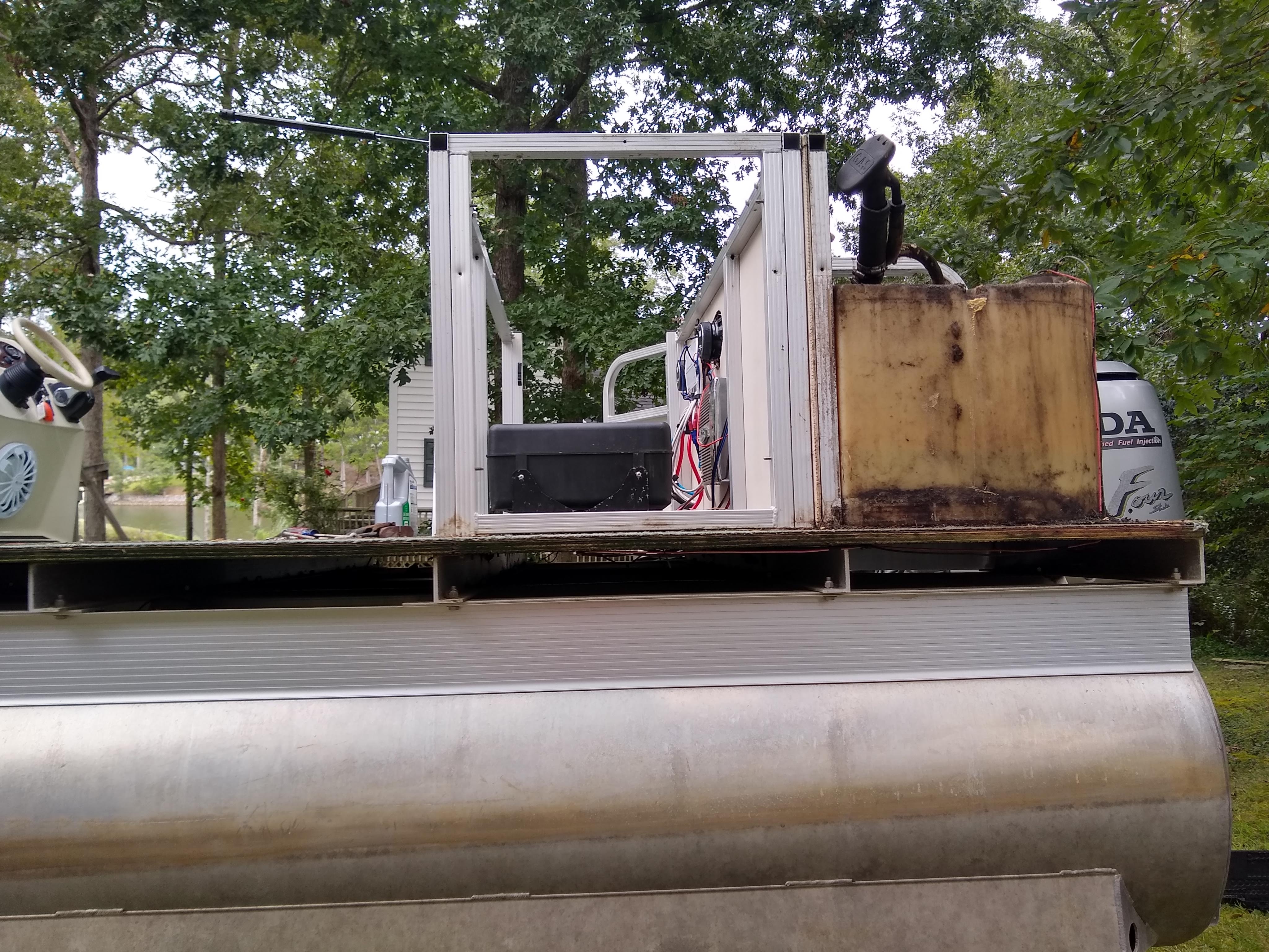

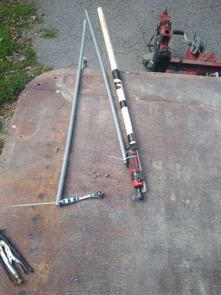

#3 Post by jrolin1 » Tue Oct 27, 2020 6:19 am

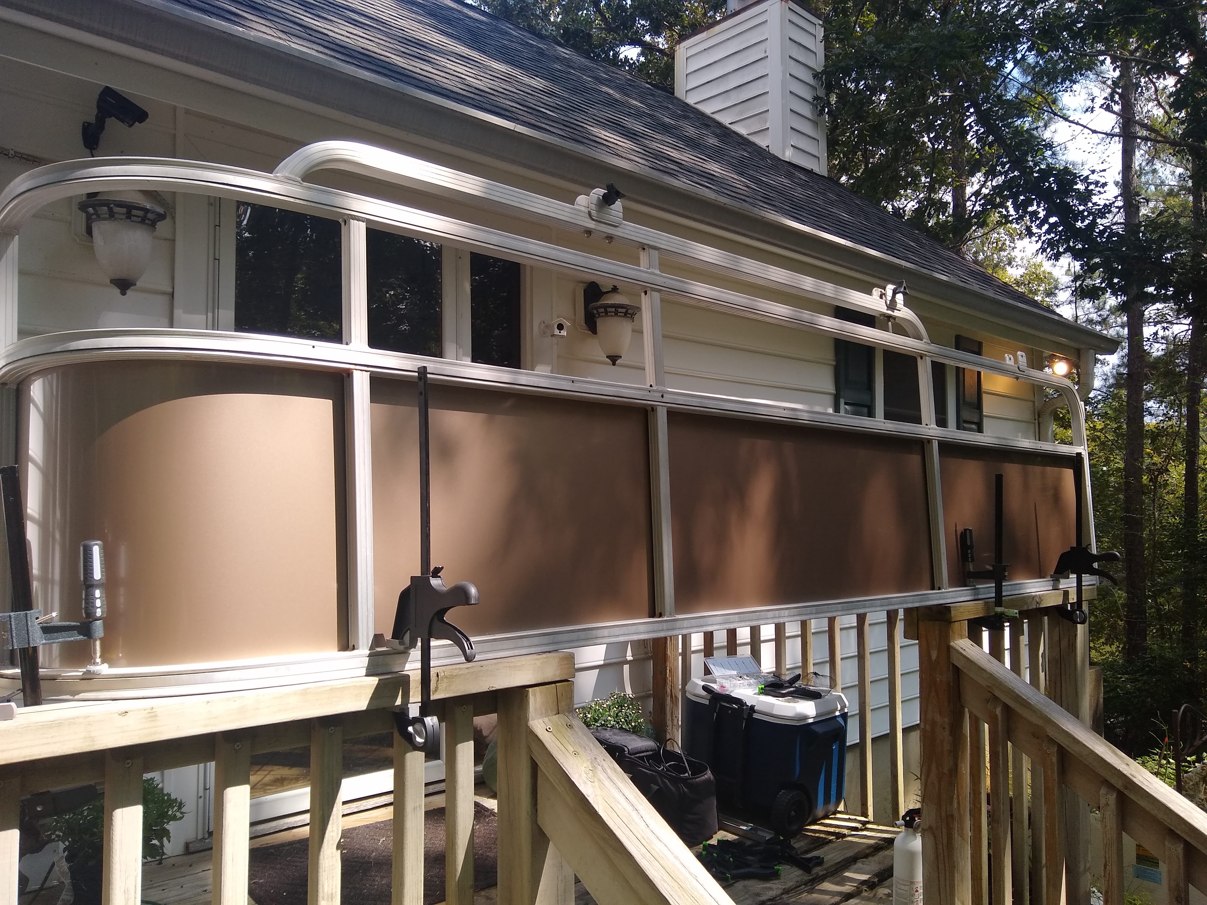

Pontoon was underskinned so no access from below. I could have cut off bolts. But I used a cordless ratchet on a 2 inch pvc pipe with a small pvc pipe to control the speed of the ratchet. Got it all off in less than an hour.

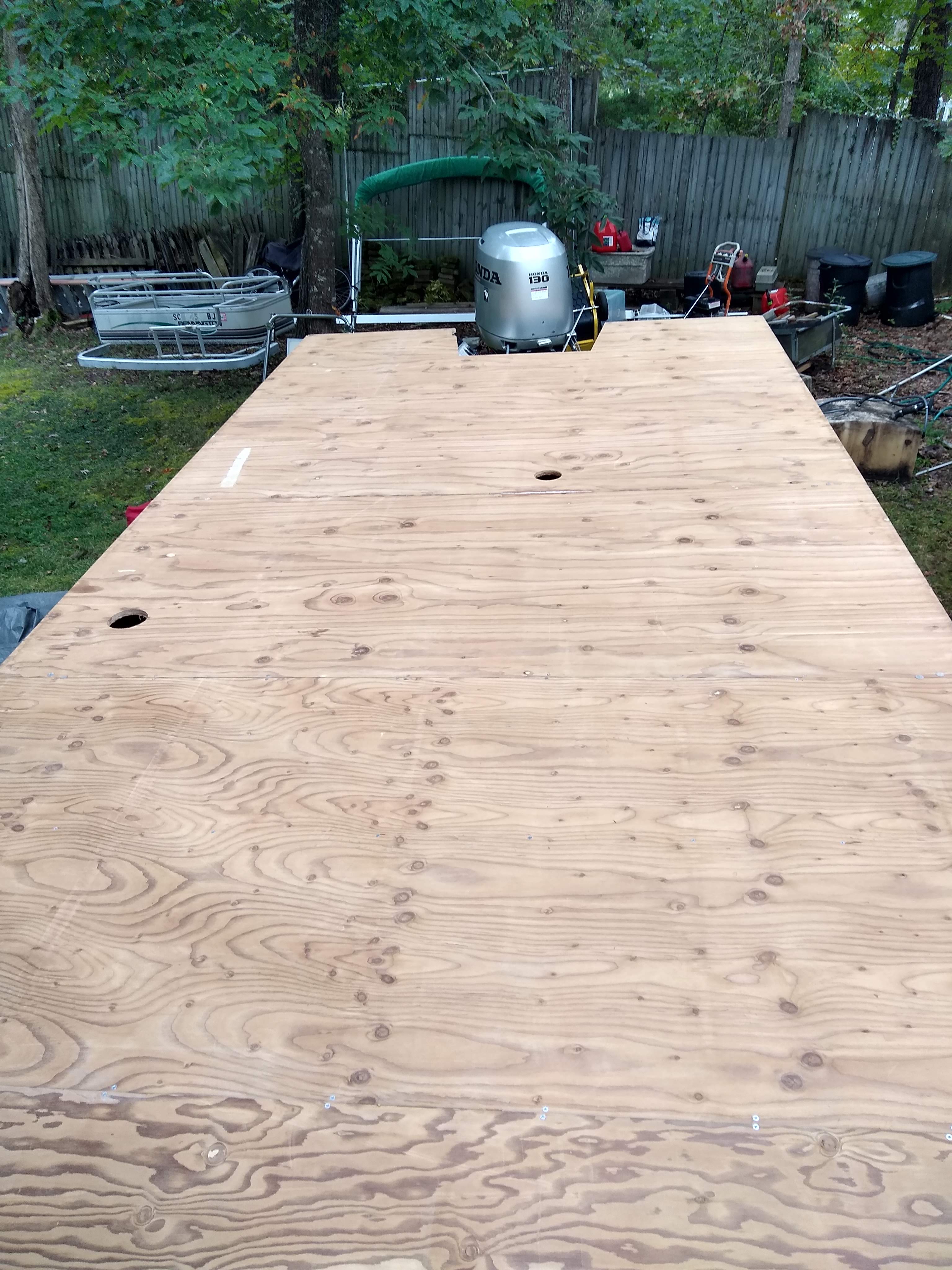

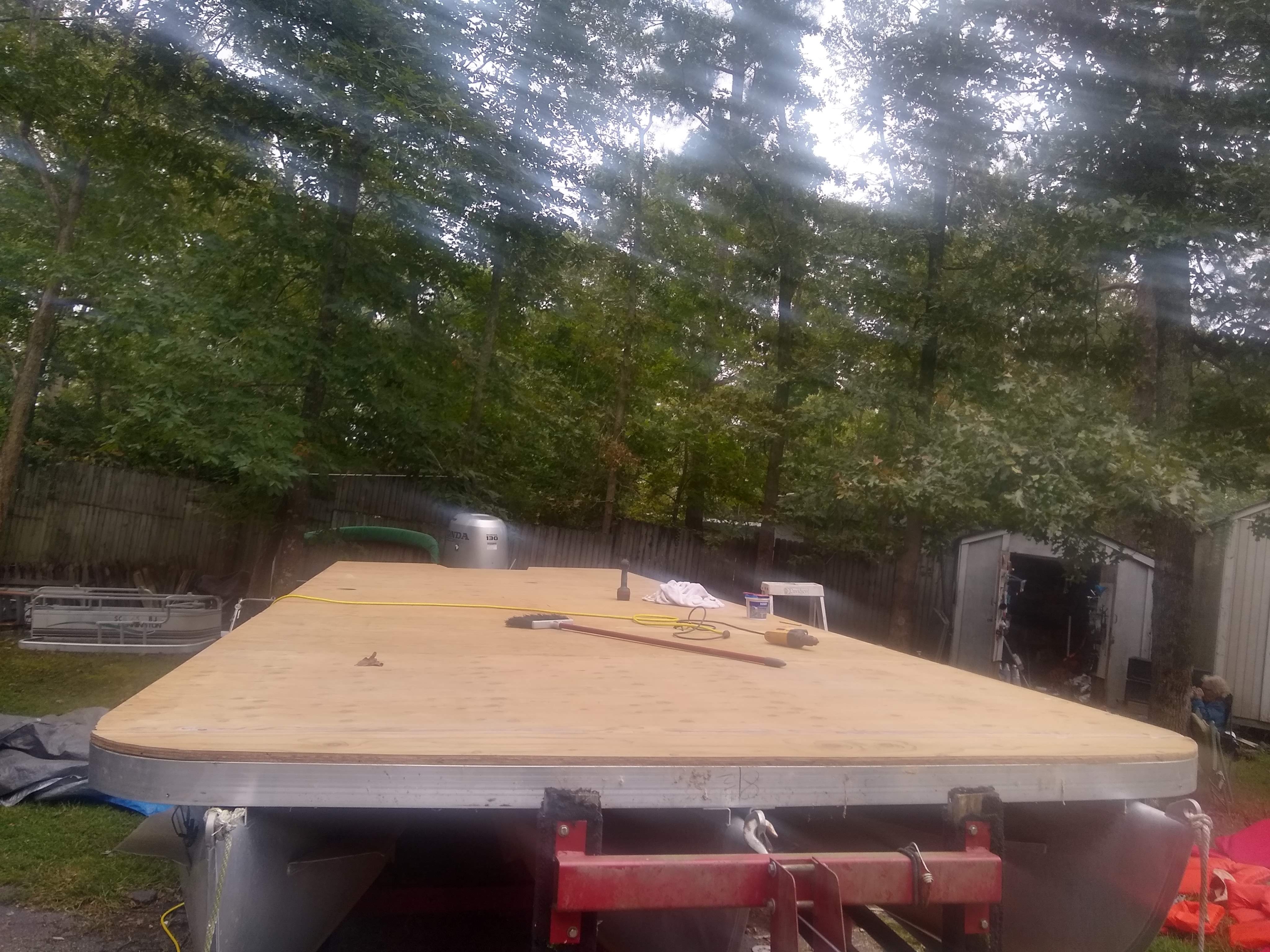

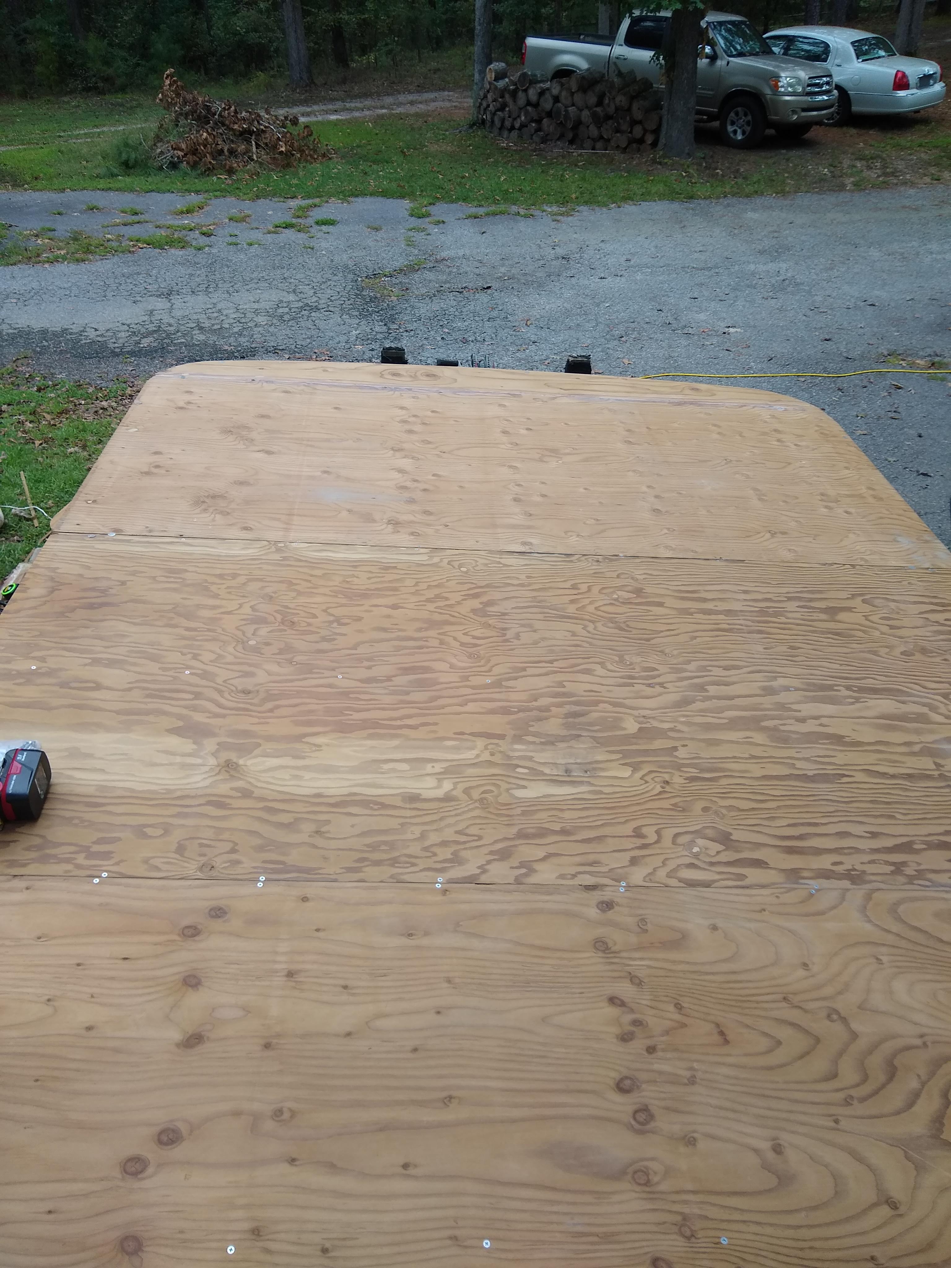

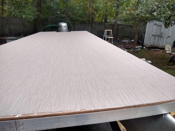

#4 Post by jrolin1 » Tue Oct 27, 2020 6:22 am

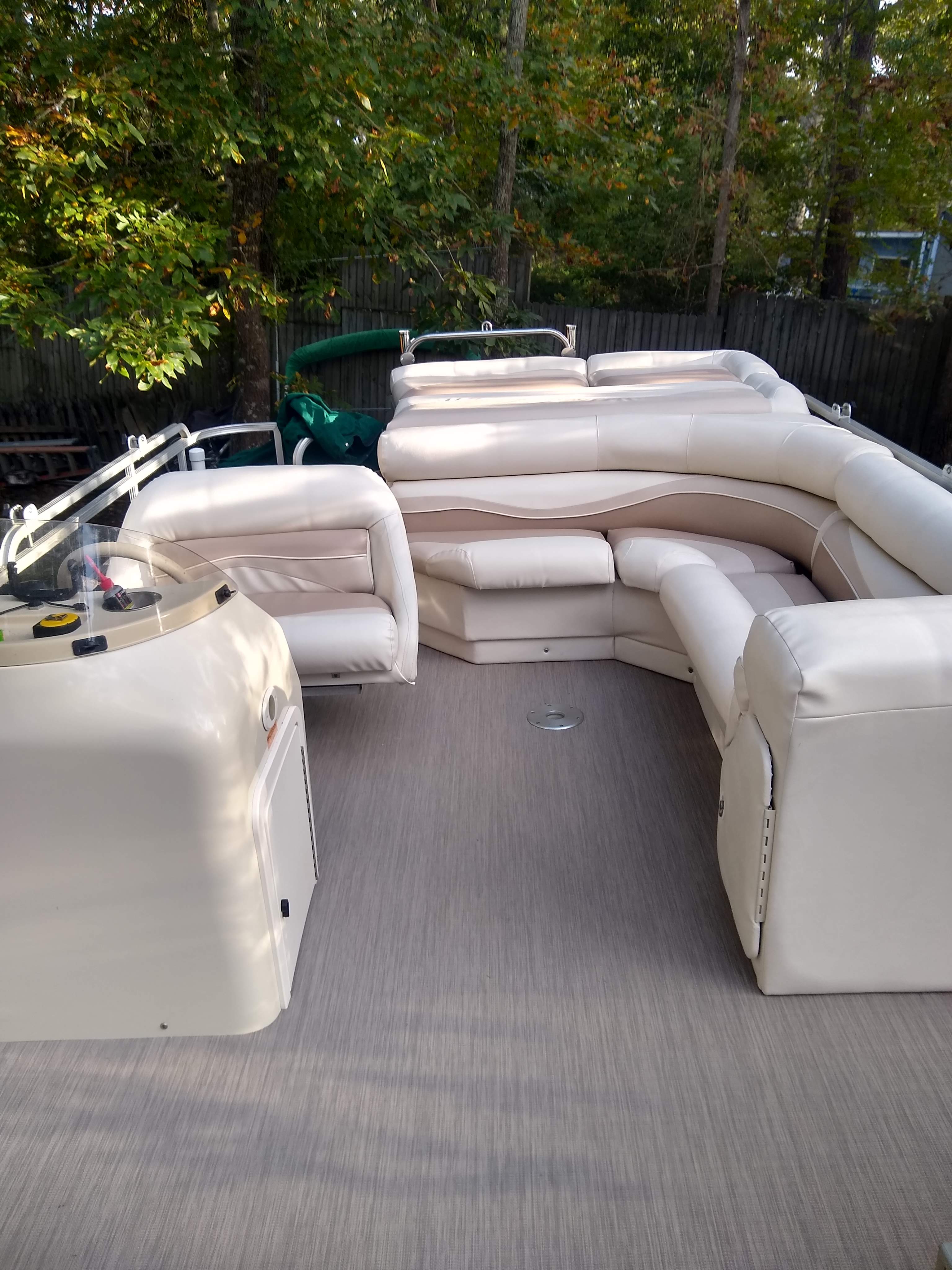

Wood was in decent shape but I replaced it due to the amount of work and expense to redo floor. A local guy that restored pontoons had the 8.5 sheets for a reasonable charge.
jrolin1
Posts: 400
Re: 2000 Bennington refresh

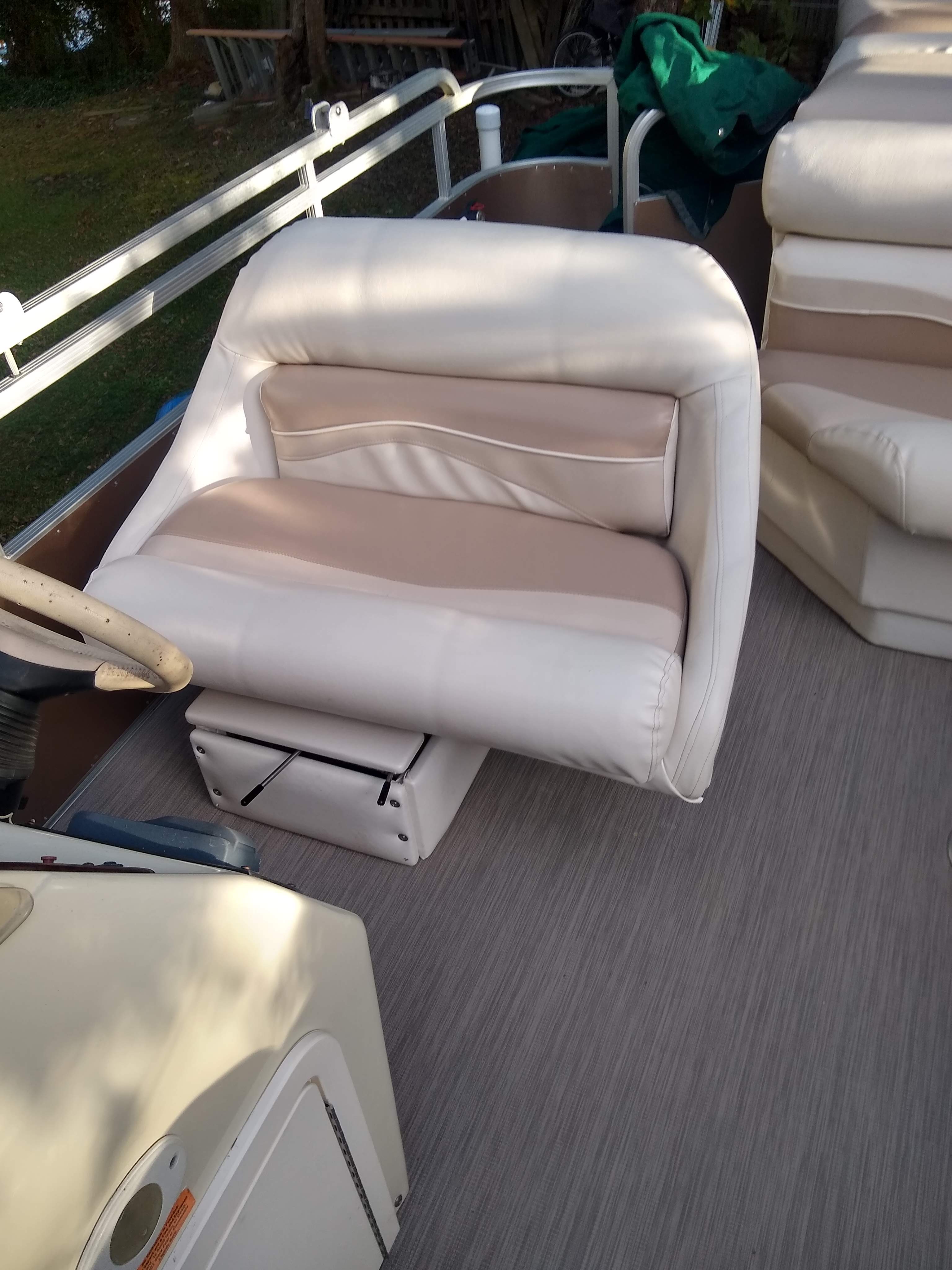

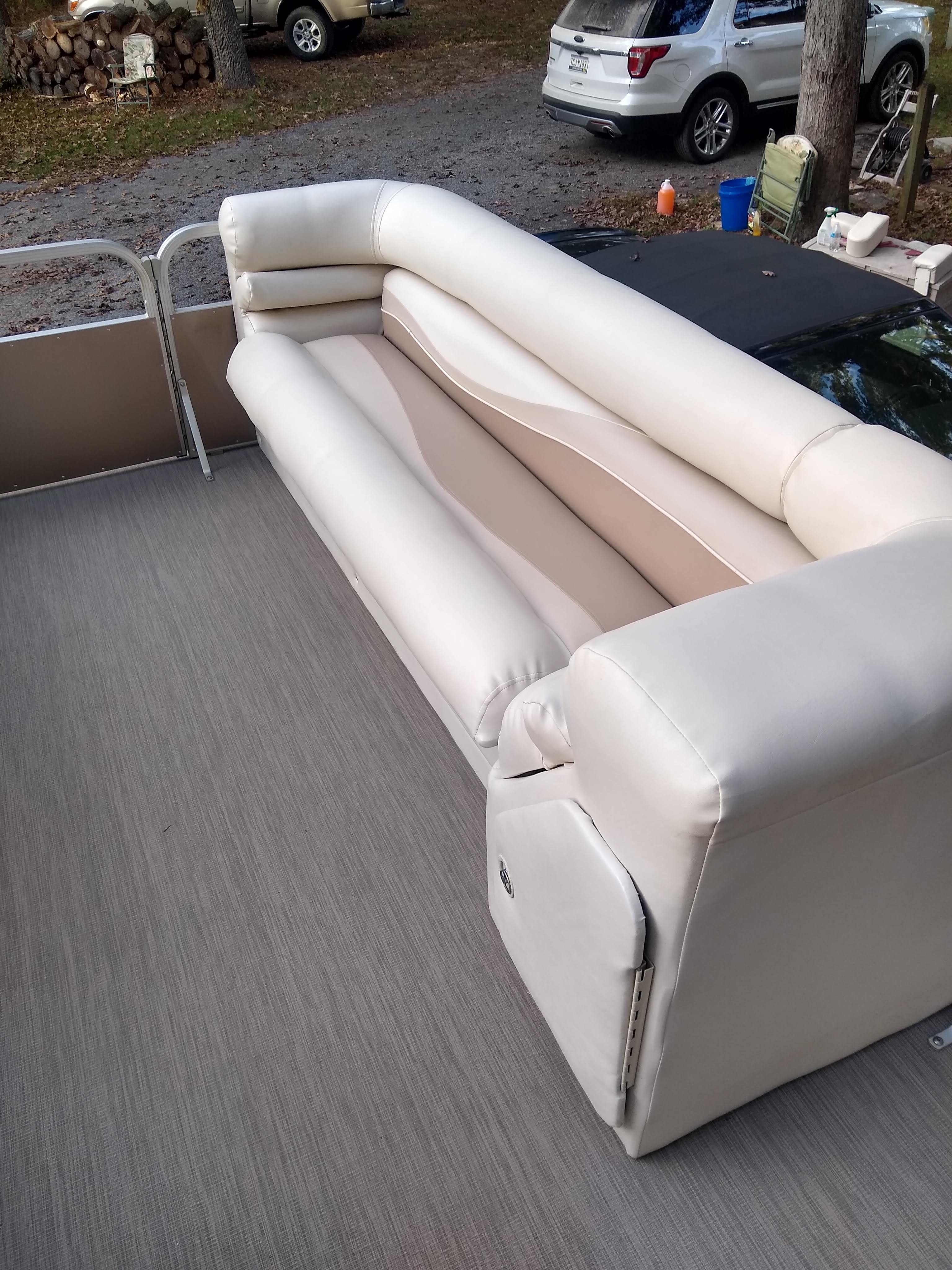

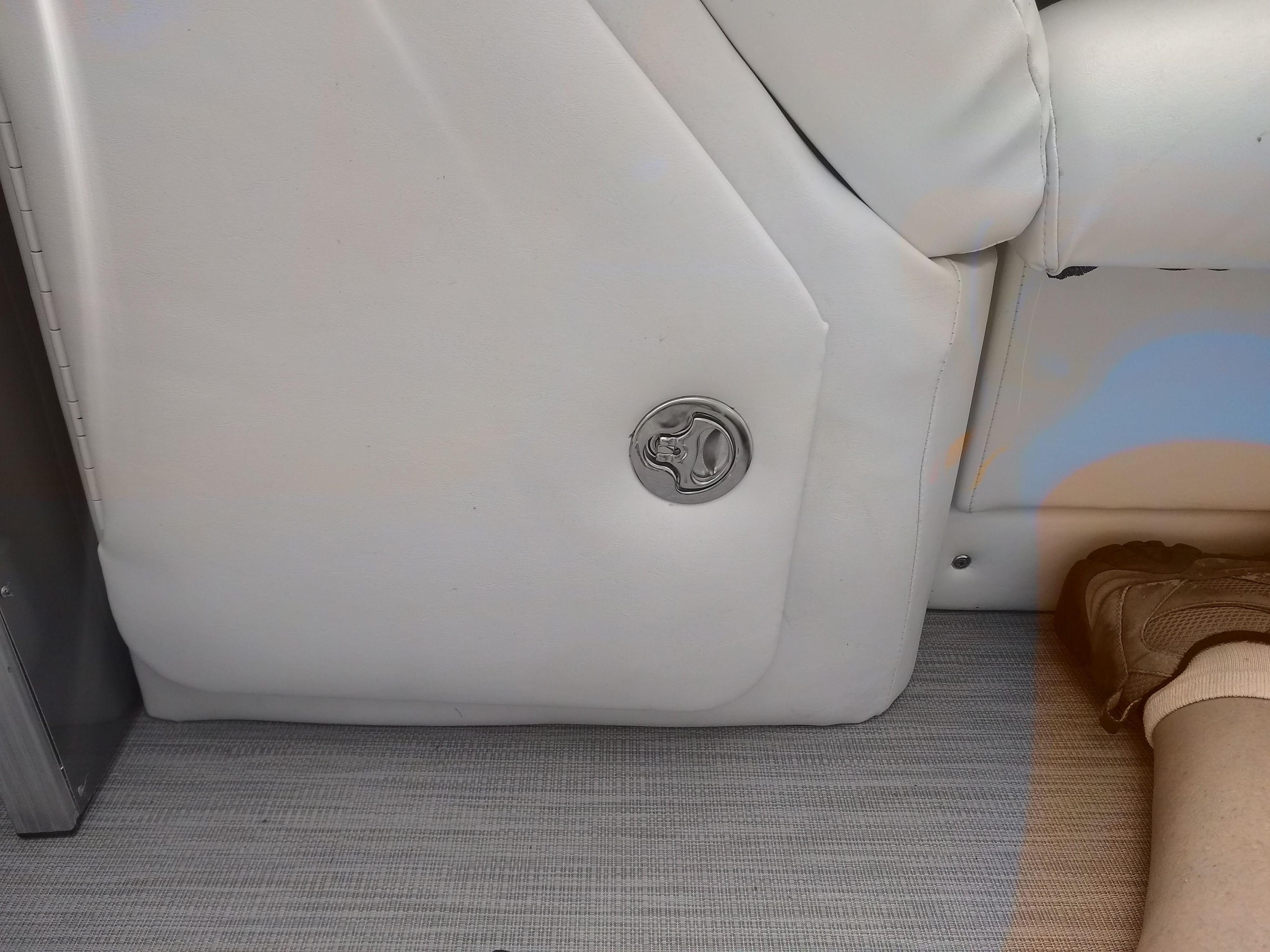

#5 Post by jrolin1 » Tue Oct 27, 2020 6:25 am
Went with a woven vinyl floor. No more wet carpet.

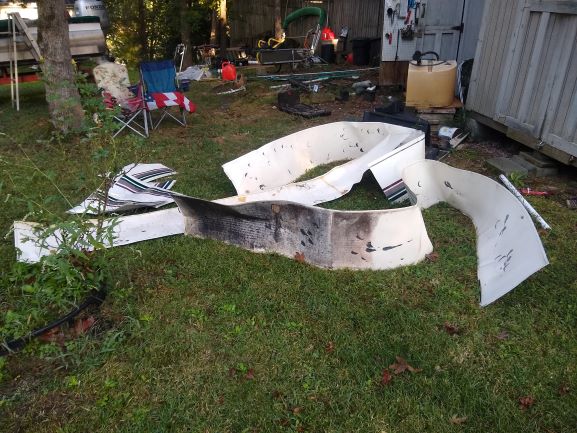

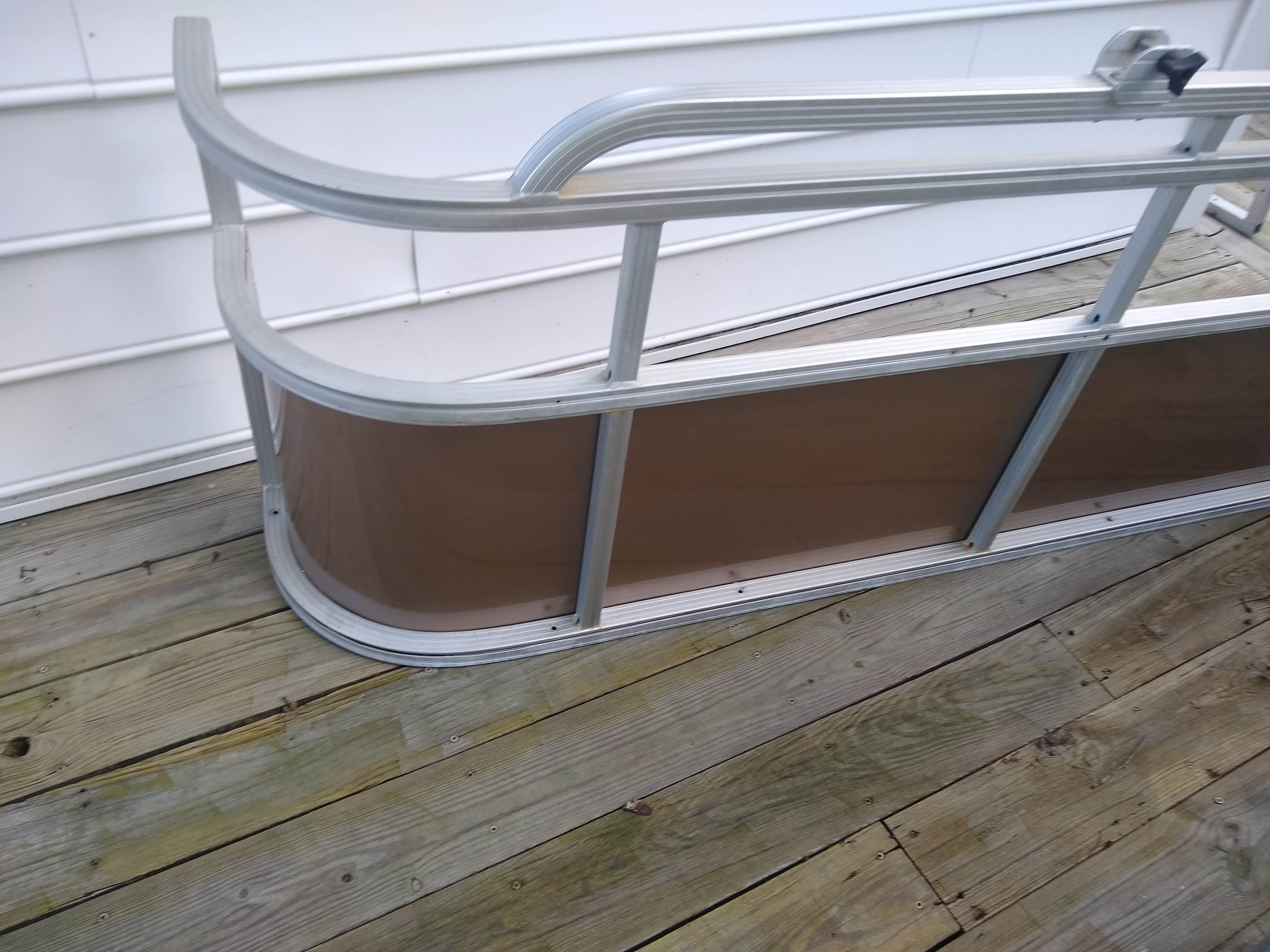

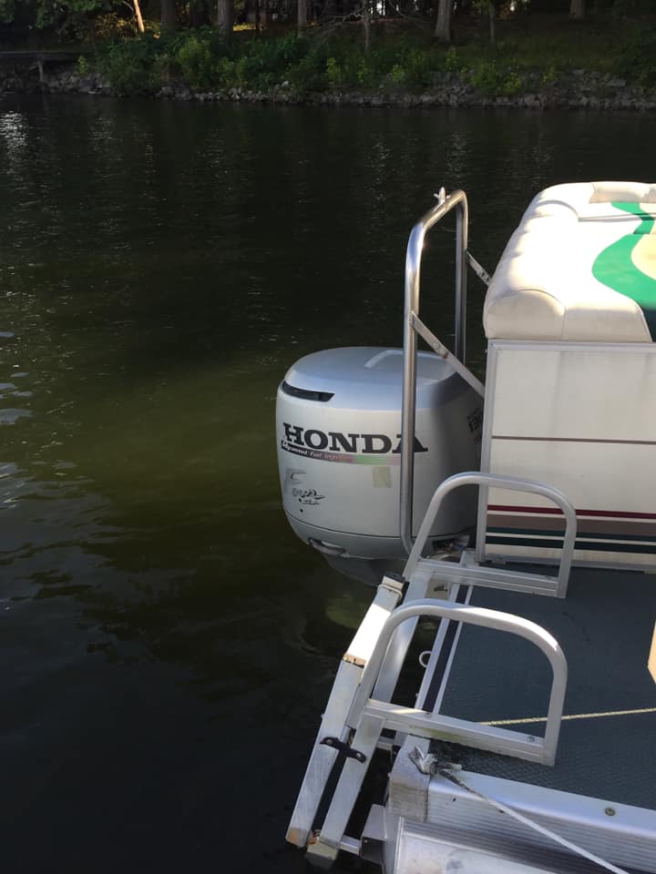

#6 Post by jrolin1 » Tue Oct 27, 2020 6:30 am

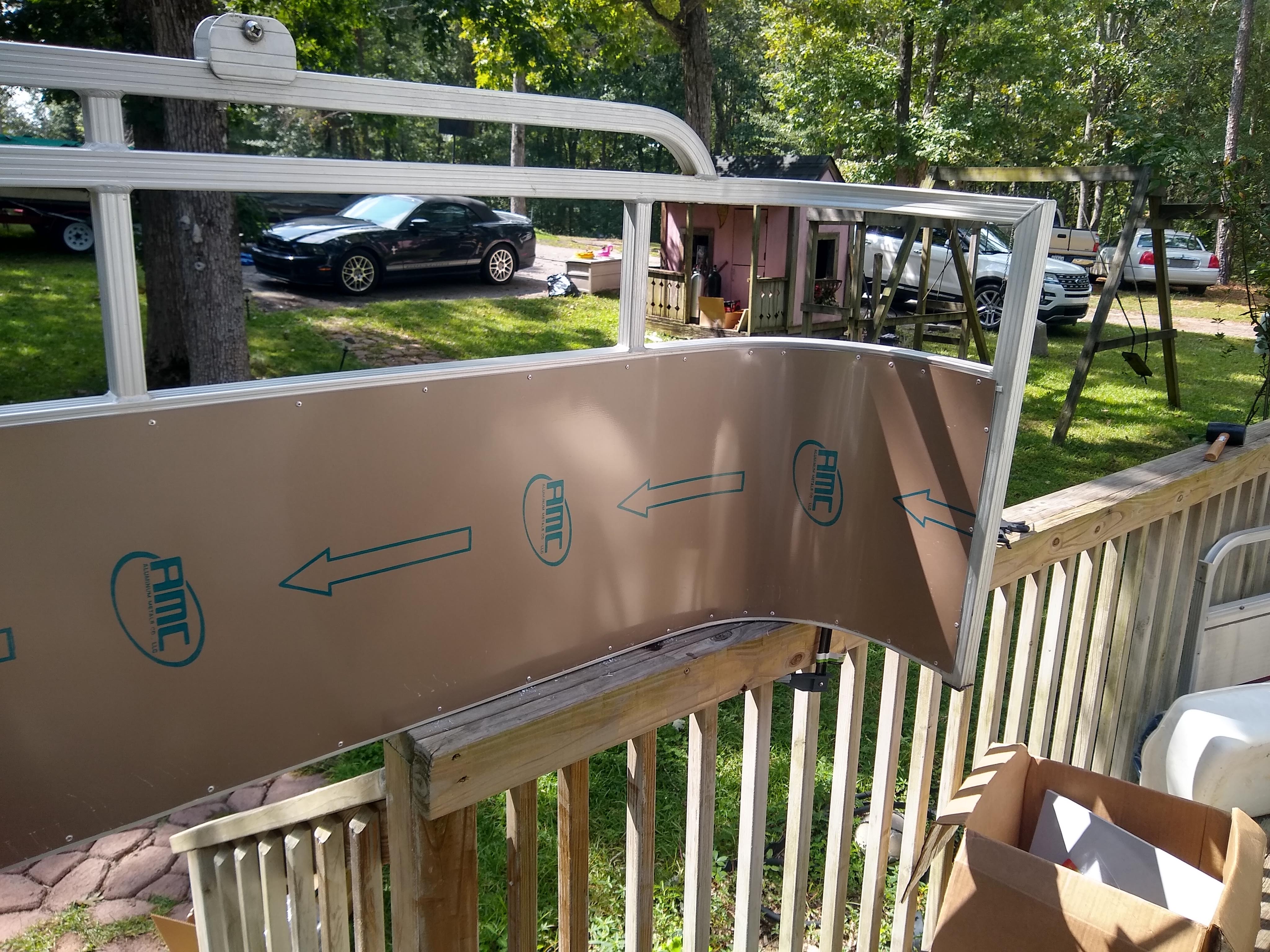

Time to replace railings. Sheet metal came fenceforpontoons. That was fun to cut and mount. Especially around gas tank fill.

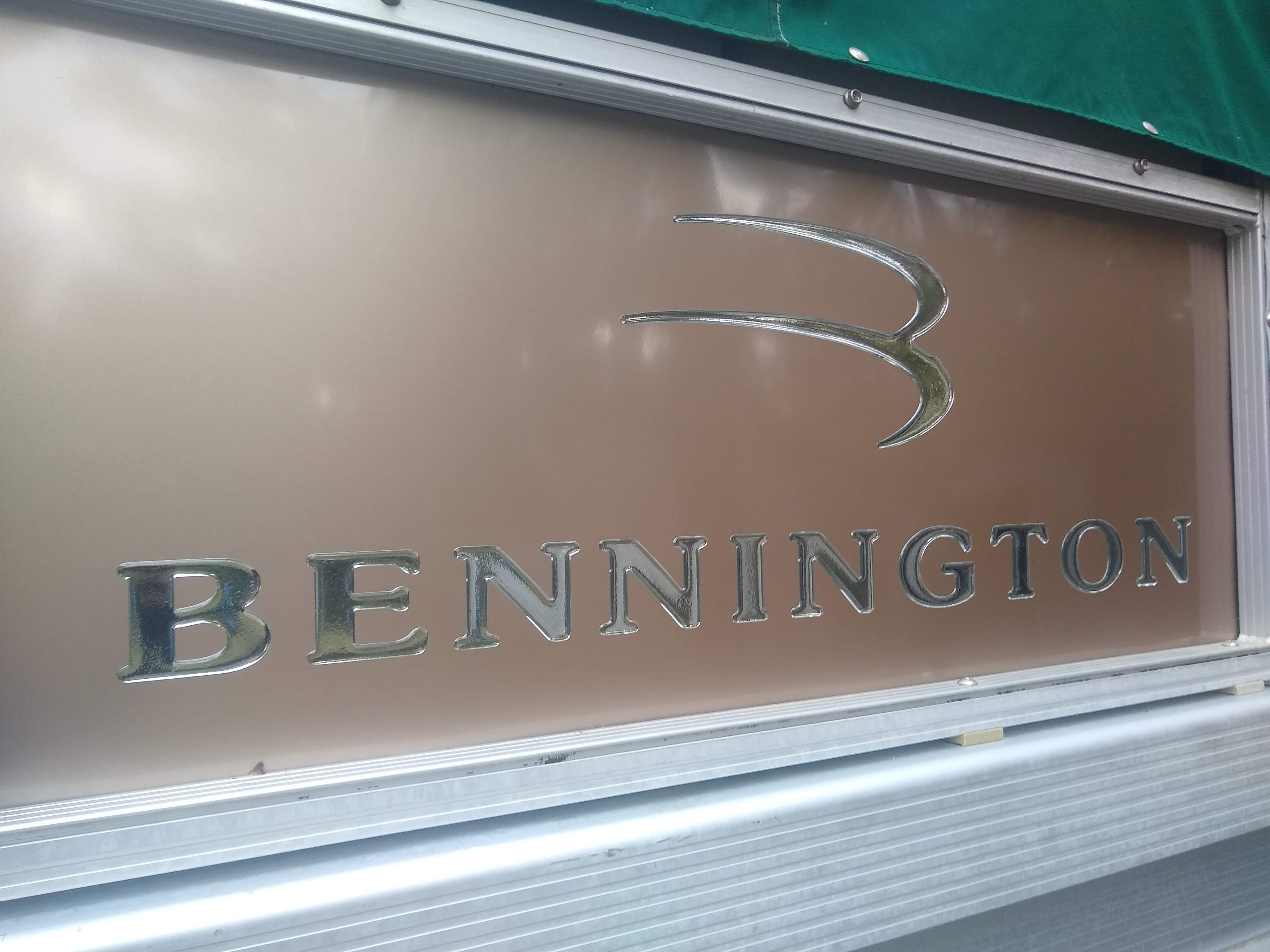

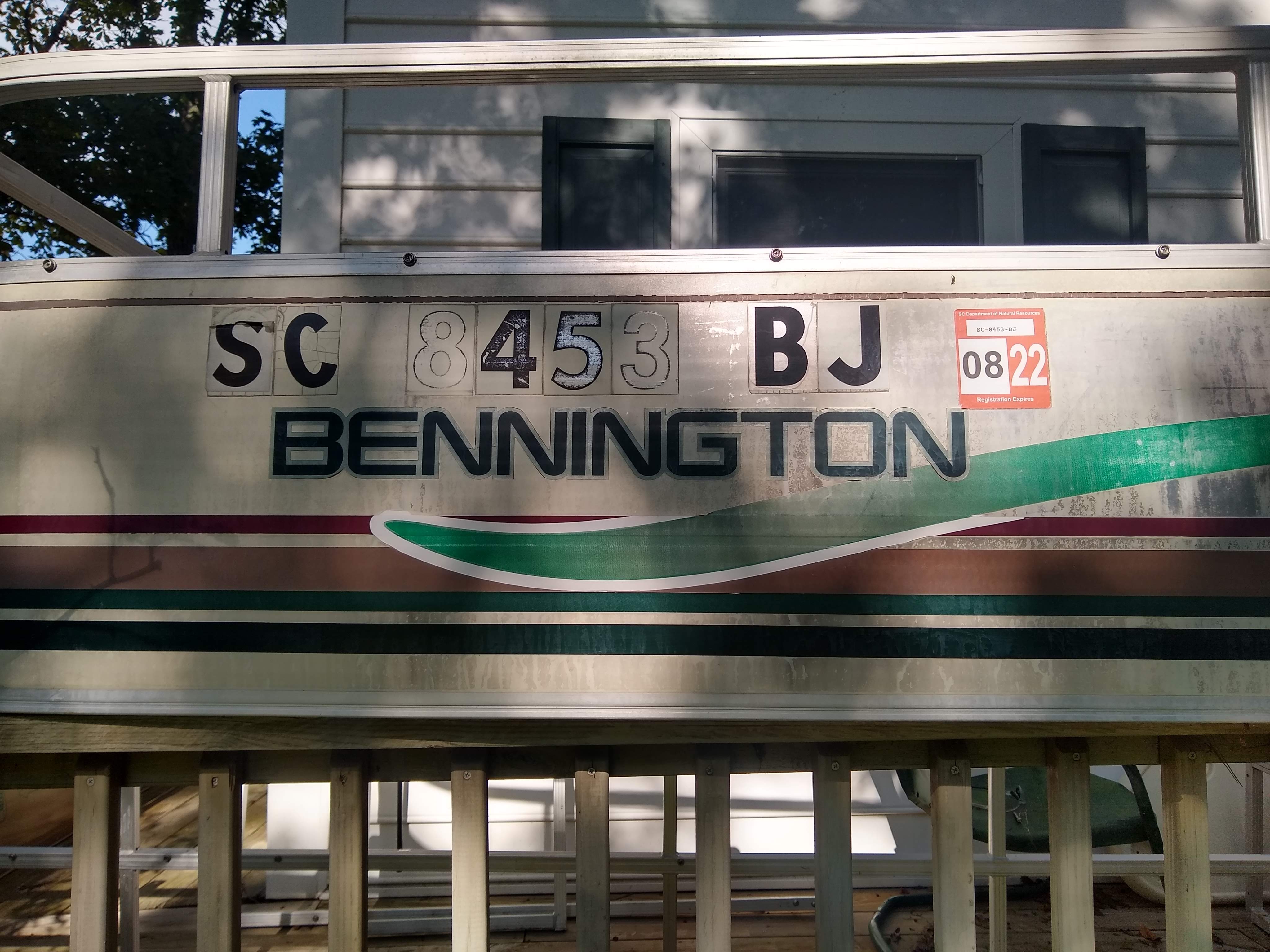

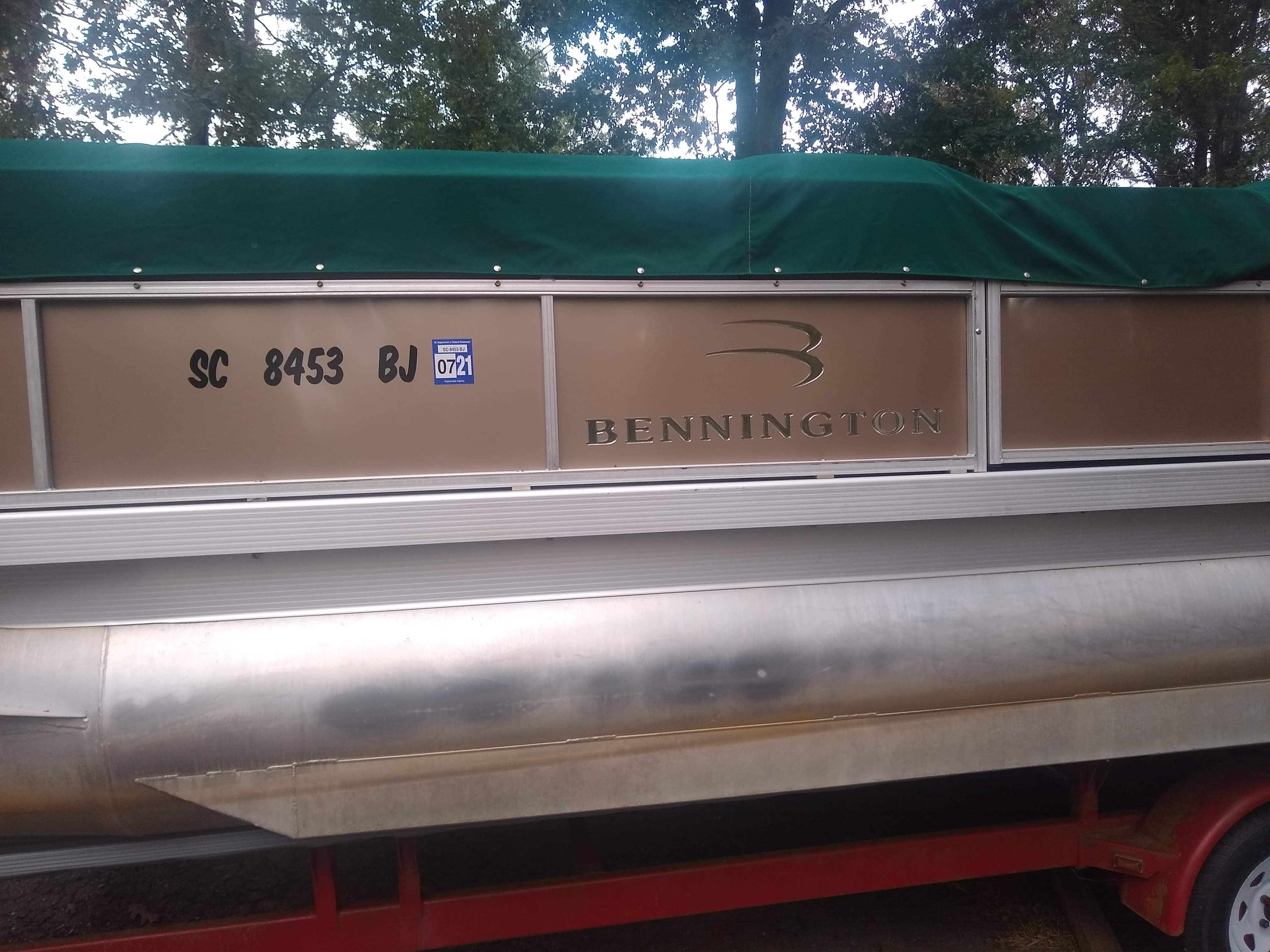

#7 Post by jrolin1 » Tue Oct 27, 2020 6:33 am
Numbers and sticker time. Bennington logo came from Serbia off of ebay. Strange but looks good.

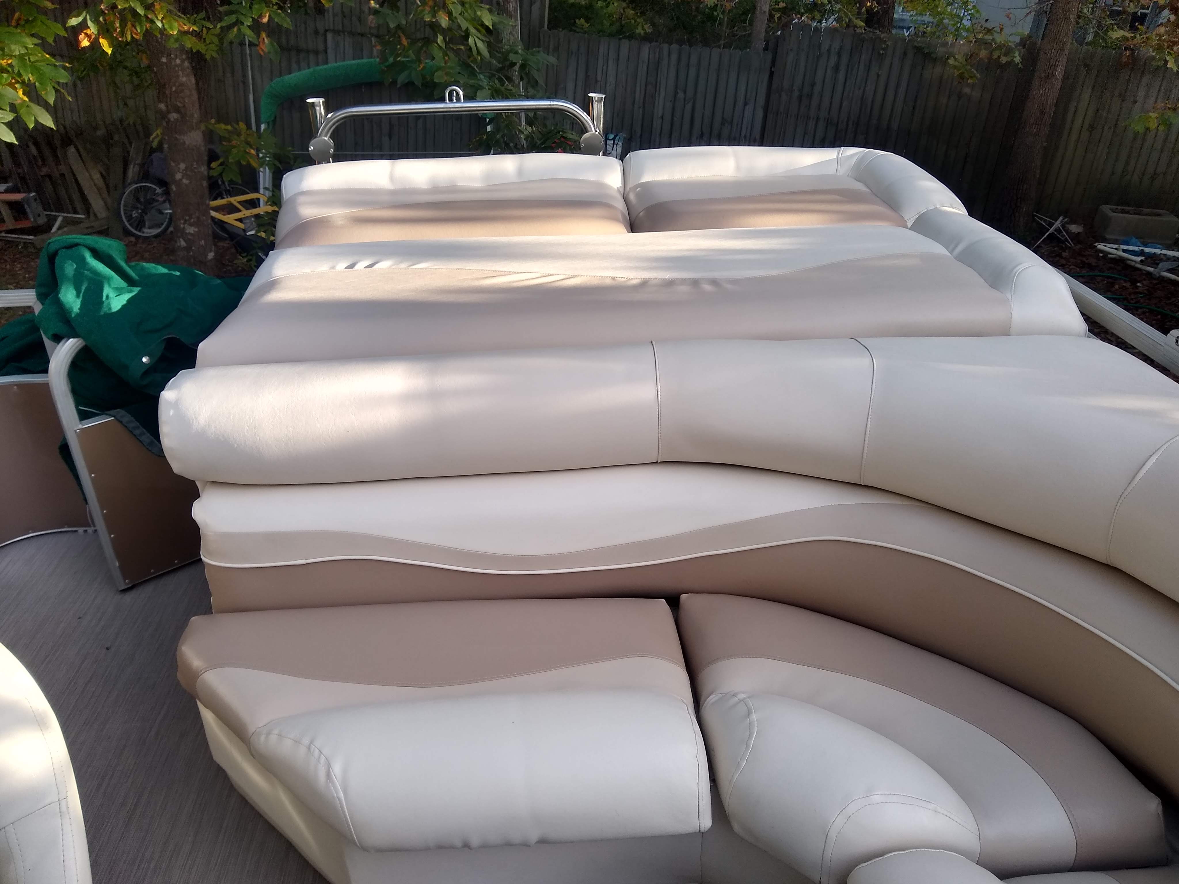

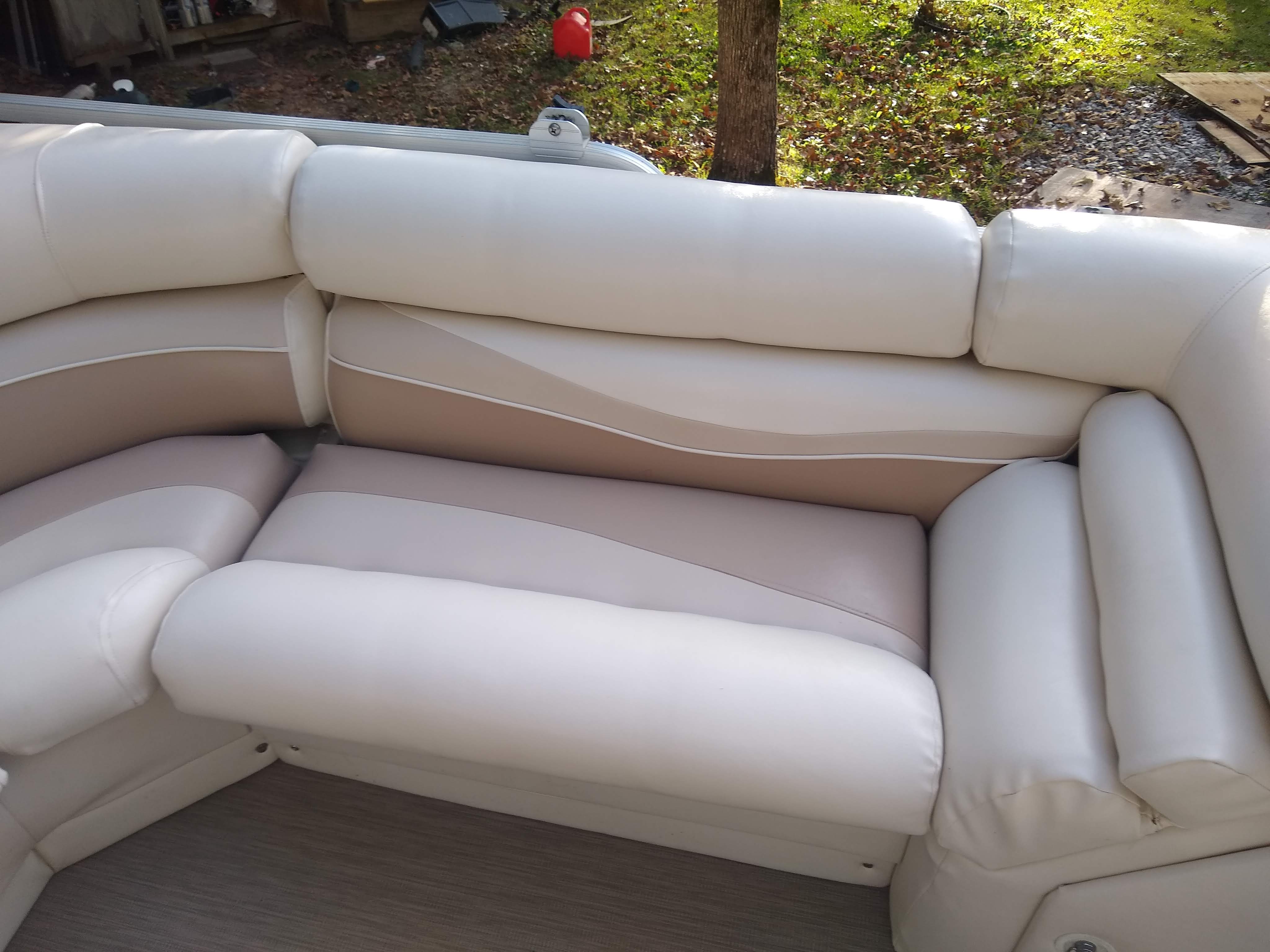

#8 Post by jrolin1 » Tue Oct 27, 2020 6:34 am
I had the seats recovered because they were comfortable and I really liked the captains seat. It swivels to the side to face the other seats when anchored.

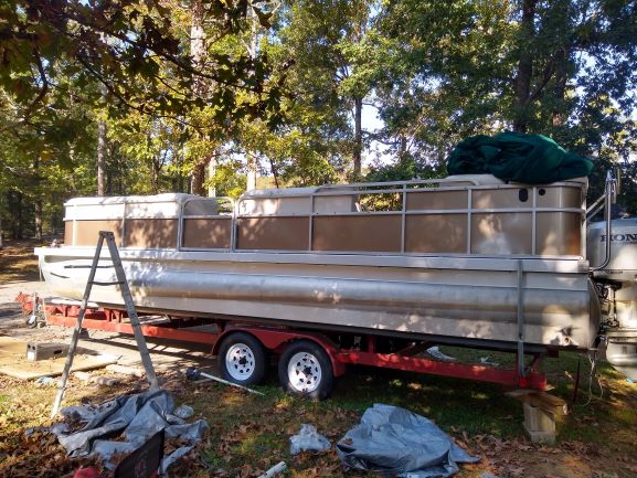

#9 Post by jrolin1 » Tue Oct 27, 2020 6:41 am

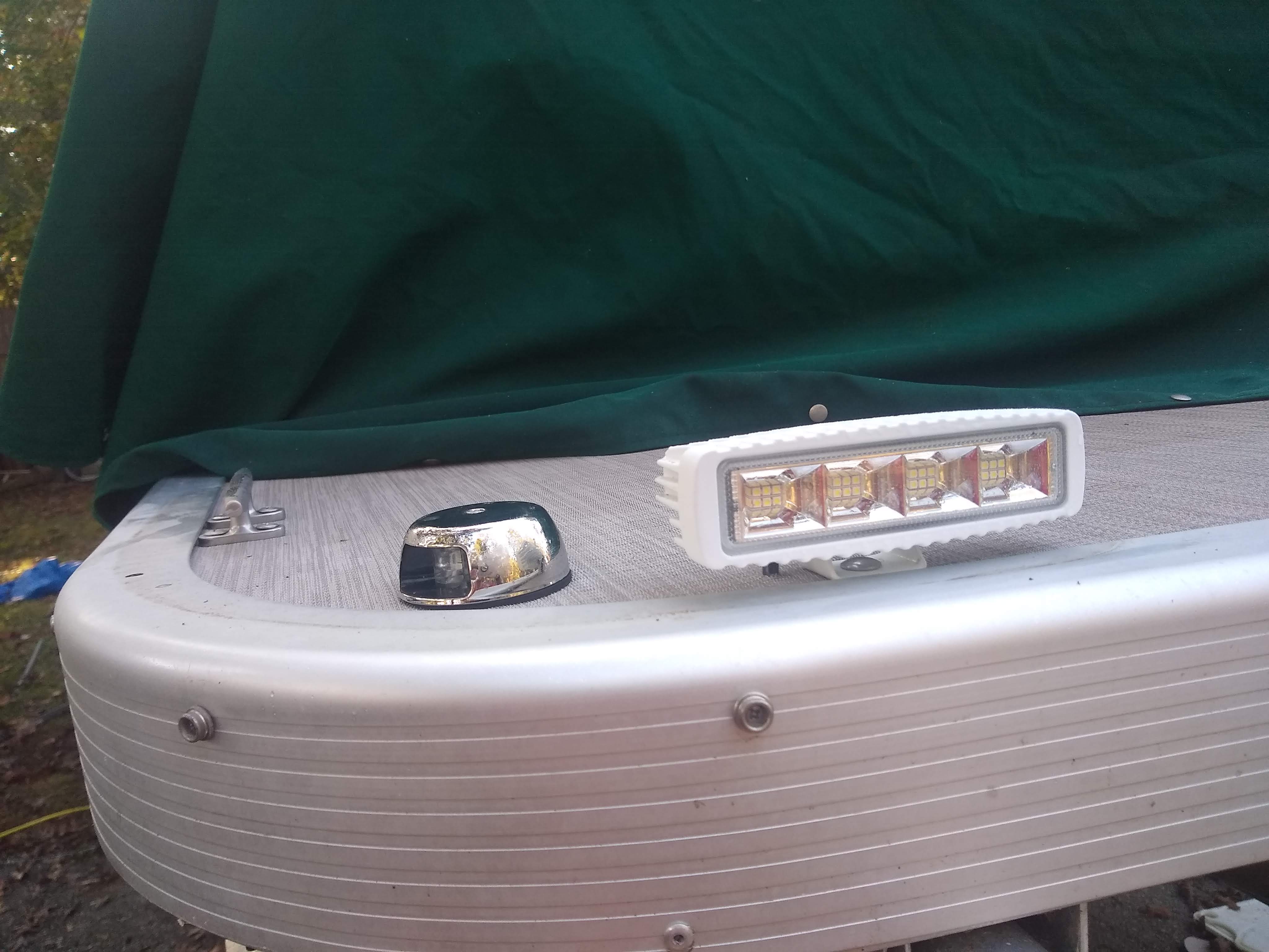

Motor and dash all wired back up. And it works! I am waiting on new bimini top to be delivered from restorepontoon. I also installed new led lights for navigation and dock lights for the front instead of reusing old plastic module. That allowed me to install cleats for the front instead of having to use the pontoon eyes.

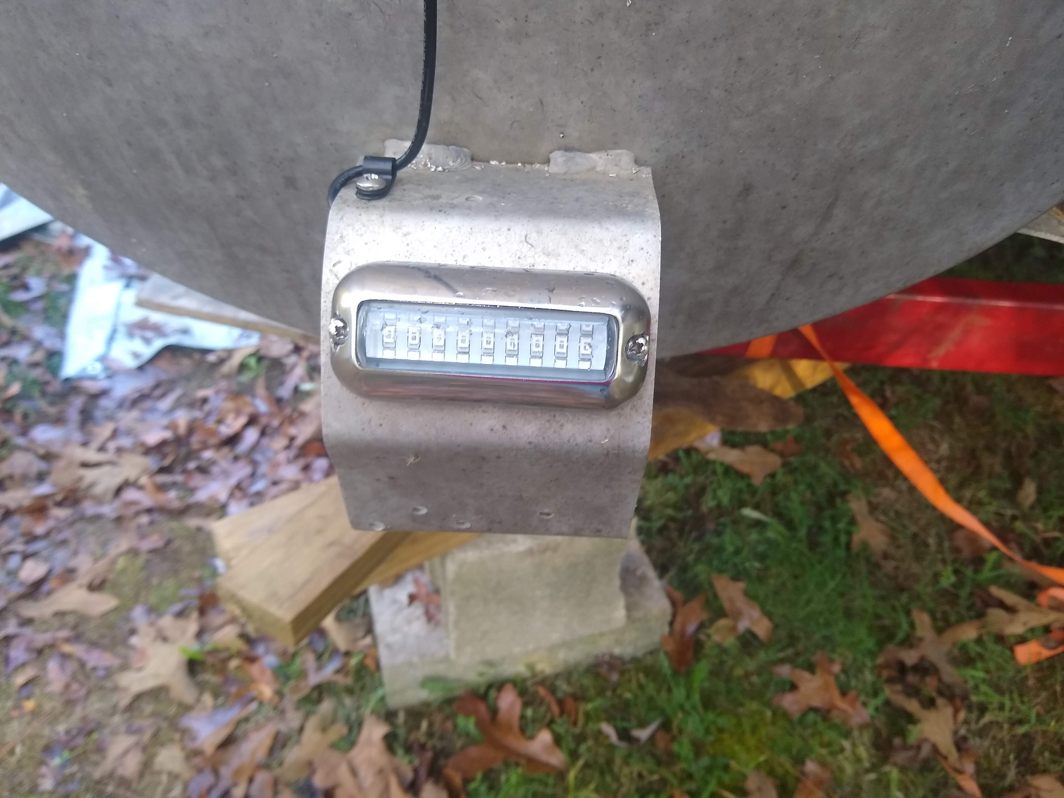

#10 Post by jrolin1 » Tue Oct 27, 2020 6:46 am
I added rear underwater lights and chasing lights for the pontoons.
