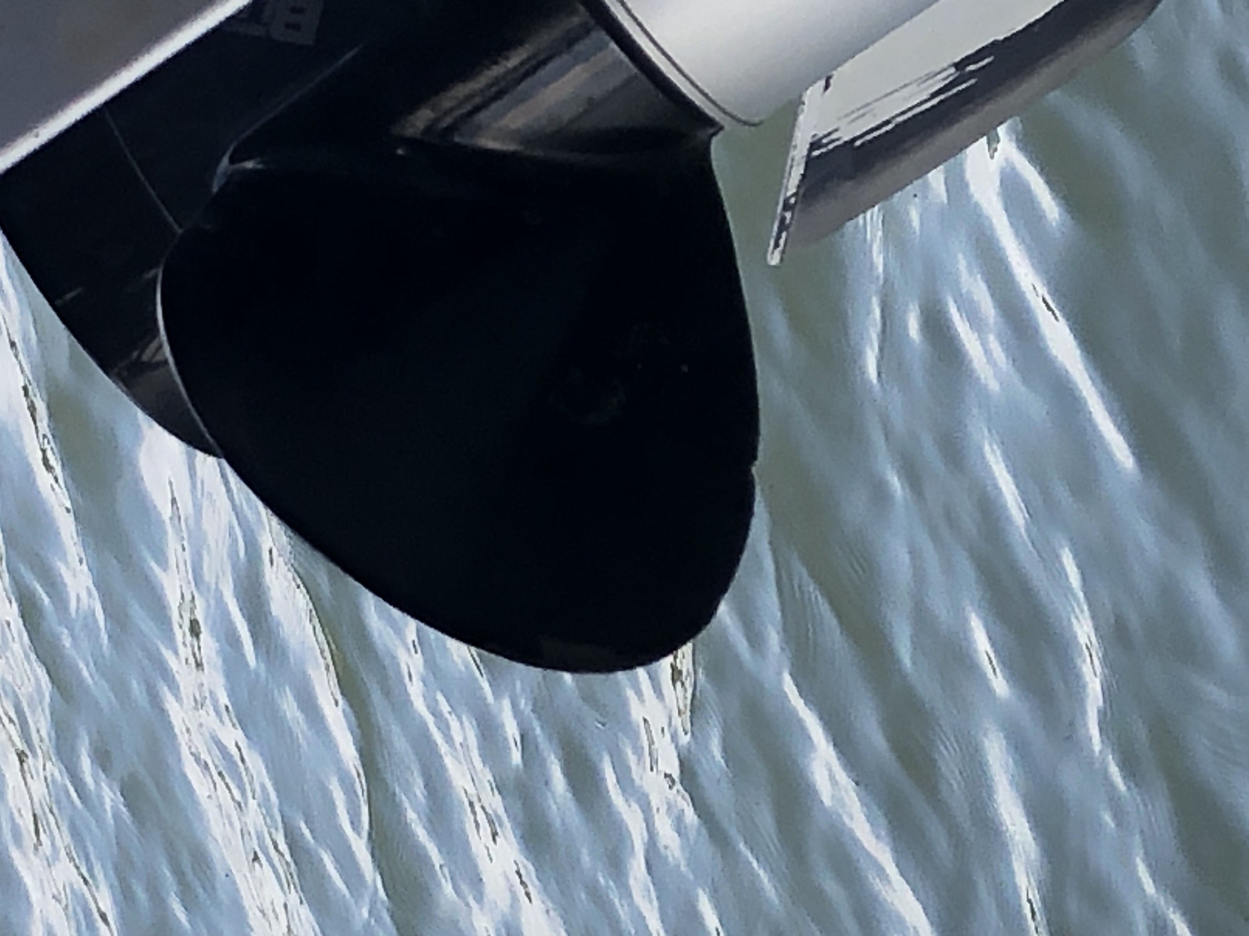

The prop has a few small dings on it that I find hard to believe are causal to this problem. I did some filing on it to smooth things out but that did not help. But this is still an open issue to me. I'll attach a pic. I had to get the pic from the back of my boat. I should have taken on when I had the prop on my workbench. :cry:
