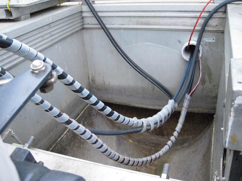

If you are referring to the transom area just in front of the motor like pictured below.
If so this area does not require a bilge pump. You can see some stains from water in the one pictured here. As you move with any speed at all the water will drain out through some sort of opening low down on the transom. The one pictured has a sort of small slotted hole that will plug with debris such as leaves occasionally that I have to clean out so it drains properly. So enjoy your boat, you've got one less thing to worry about.Respect Our Recreational Resources

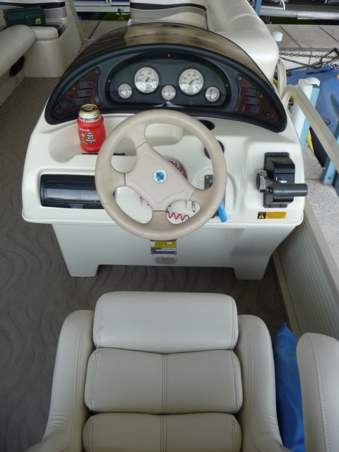

It's very unlikely that you have a "fuse box" on a pontoon boat. There should be a fuse holder with a fuse inside the battery box or it will be found outside of it. Does your switch panel somehow resemble the one pictured below.....
The small arrow points to the "fuse" on this particular switch panel. A lot of boat panels are set up with a similar type deal. If it "trips" you push the button to reset it again although I've never had one trip on my boats as of yet.Respect Our Recreational Resources

OK, you lost me. From what you described you have an Aloha pontoon boat (2 logs) with a motor pod. Your motor pod will fill and drain depending how fast you go. There is no bilge pump because there is a drain hole at the bottom of the pod which will allow water to go in and out. However your pod shouldn't sit so low in the water that it completely fills up. If that is you set up you don't have a bilge pump or need one.

Bamby - thanks for the photo and info. The switches look about the
same as what you show. There are six (6) swithes and I've ID'd
all of them. But there are no circuit breaker buttons associated
with them that I can find. There is an inline fuse located at the
battery box and it has a reset button on it. So, I guess that's it.

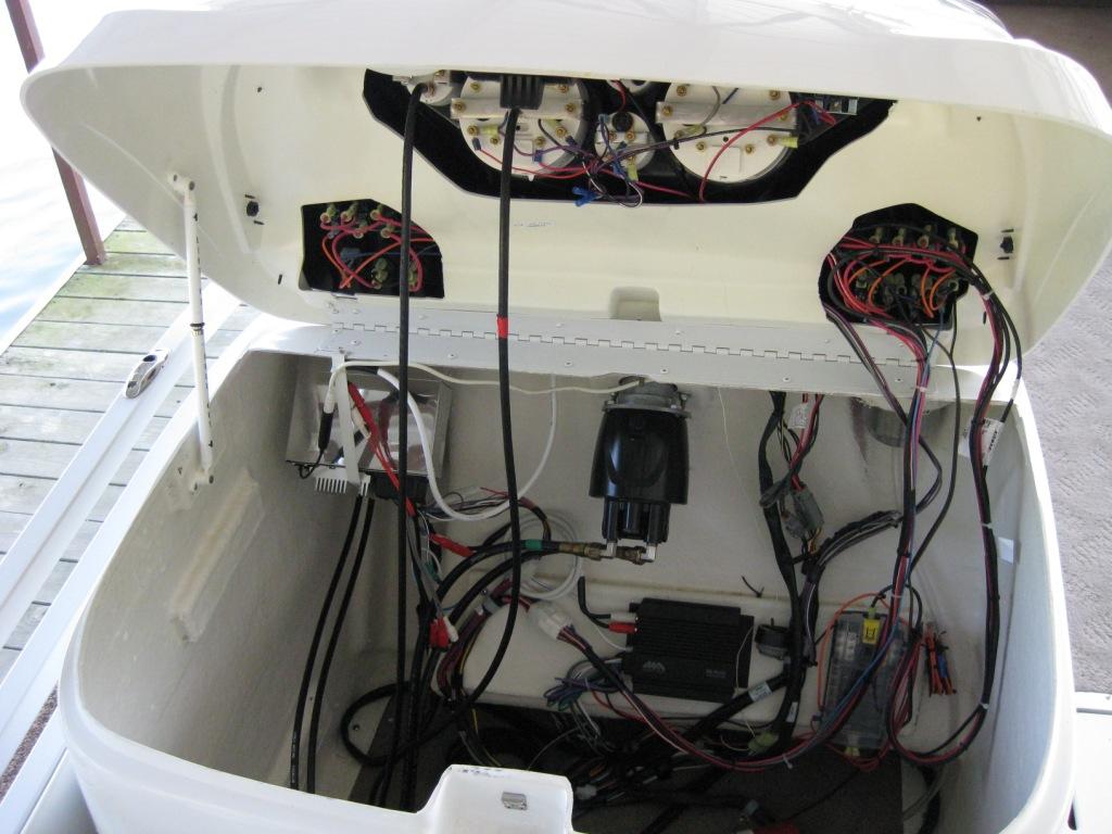

Re: Bilge Pump?
I would check inside the helm (steering console) There is most likely a fuse block in there up high to stay dry.

Yep fuse block is inside and high...

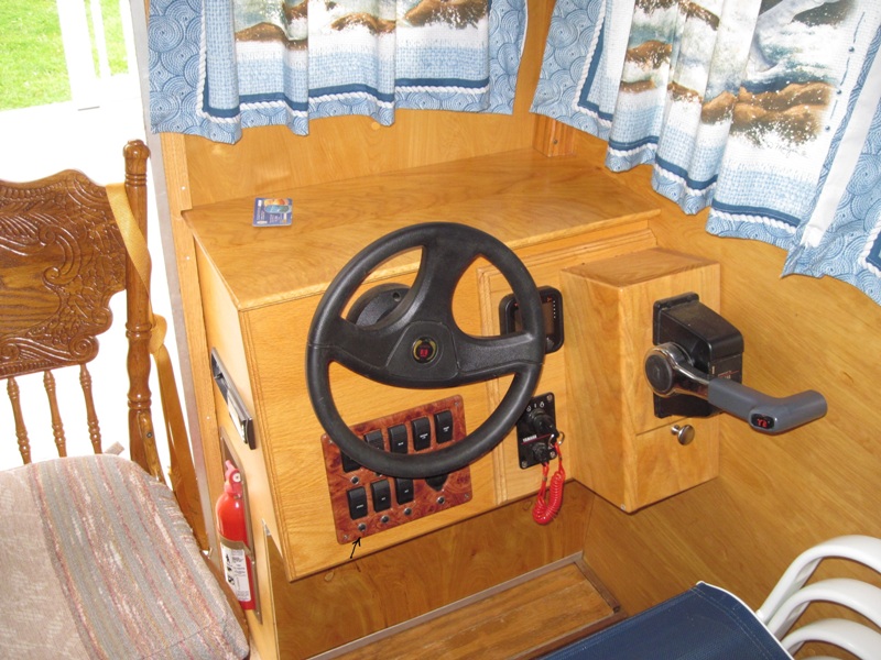

It would be a lot easier if your console did this -
- March to September 122 small.JPG (96.42 KiB) Viewed 13126 times
- Posts: 5441
Re: Bilge Pump?
Fuckin show off....
That is awesome. I have to undo 4 screws and lay on my back to barely get to mine.
Re: Bilge Pump?
OldePharte wrote:It would be a lot easier if your console did this -
Yeah, mine does that too. It does make the access NICE.
