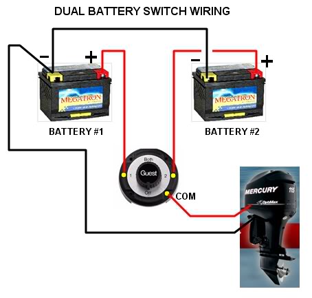

Just buy a second battery and switch. It's very simple to hook up dual batts:
- StandardBatterySwitchWiring.jpg (27.35 KiB) Viewed 5817 times

Re: Radio/Battery
^ That's the setup I have.
