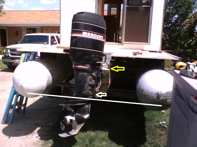

On one pontoon boat I owned I did actually install a hydro foil and it seemingly did correct or help the problem. But I latter learned more and found that when we purchased the boat new it actually wasn't actually rigged right from the dealer. I raised the motor a couple of holes (20 in. shaft also) and truly corrected the problem.
texaspontoon wrote:It may have something to do with the engine height.
It may have everything to do with the engine height. I've had the best results when the anti-ventilation plate (white line) is more or less level with the transom. This is also a 20 in. shaft motor and notice that it is also raised a bit (yellow arrow) to achieve the proper height. Now take note to the left of the white arrow, if your motor is also anti water dynamic like this one with any factors that are disruptive to water flow. The boils created by such may be the real source of your problem. Deeper is not always better, there is a chance that you may actually need to raise it some to correct the real problem.
