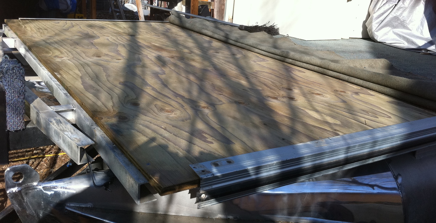

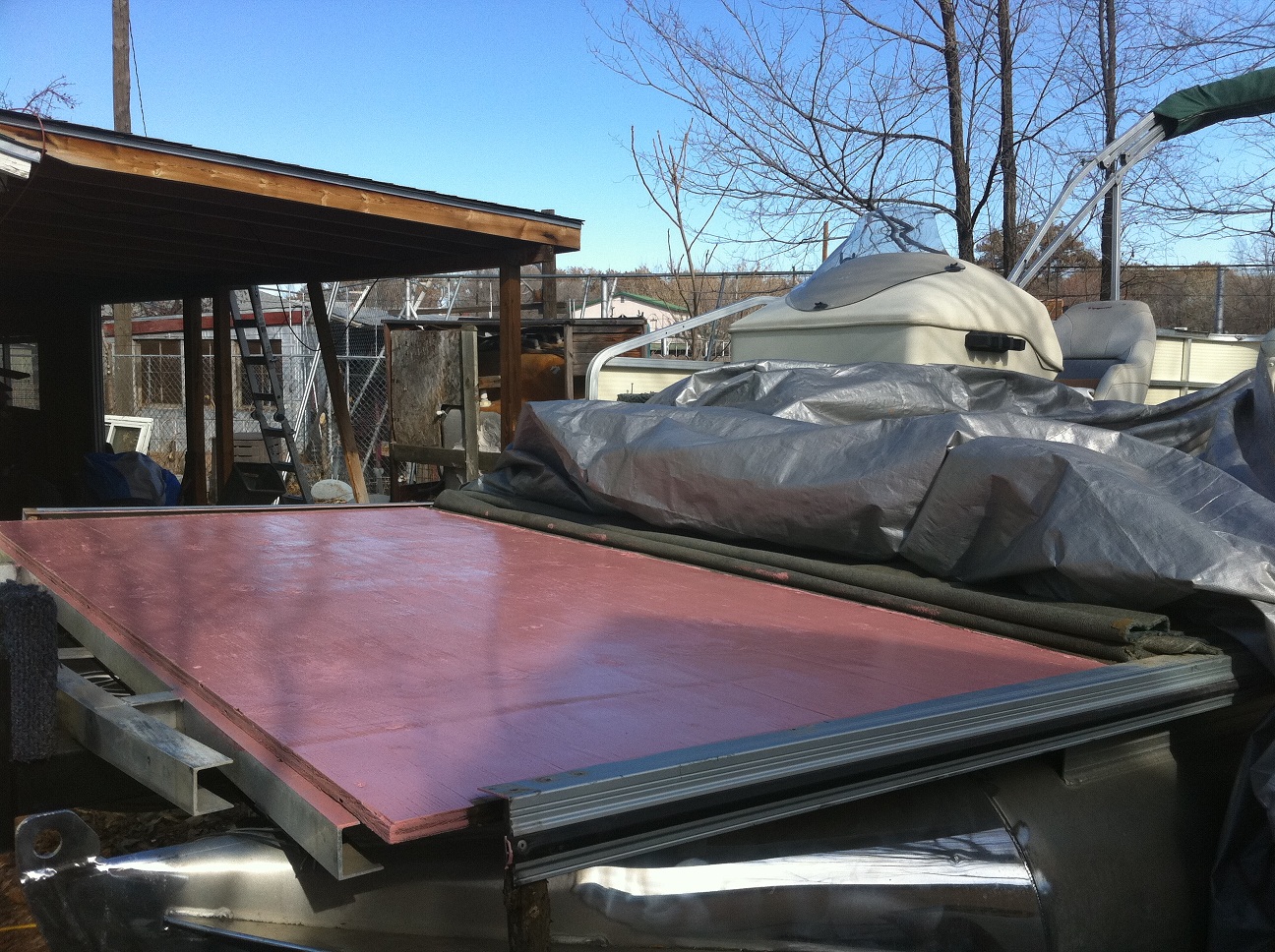

well i am going the cheap as we speak...i got a full 4x8 sheet of treated wood...i am adding some protection with some oil based outdoor paint as per the recommendations of others here. I have applied 5 coats of paint over the past week. This was paint from home depot. it was a can of oops paint..didn't care about the color since it will be under the carpet. I didn't coat all sides. i am going to be installing under-skinning once i am all set. it will bottom protection and some top so we shall see how it does. The first pic is before i started coating and then after.
- newdeckcoated.jpg (561.73 KiB) Viewed 12154 times
- here is the deck before coating
- new deck.jpg (587.23 KiB) Viewed 12149 times

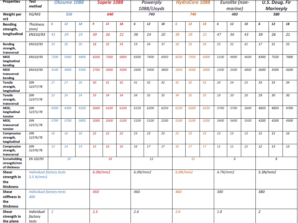

Blowing smoke?
I could get into the semantics of engineering terms all day long if you would like, but I prefer to show ACTUAL results.
The attached table shows just how much better Meranti (Hydrocore 1088) is versus Doug Fir -and I stress that the table shows MARINE GRADE FIR which is head and shoulders better than any junky "concrete form" plywood you can buy at your local big box.
Take a good look at the 12mm column (3/4", which is the most commonly used on pontoons) and see for yourself. Meranti absolutely trumps Fir. While bending characteristics are pretty much equal this isn't really a consideration since they are both supported by stringers. Tensile, compressive and shear characteristics are far more important when it comes to defining overall "strength". When you can buy Meranti for almost the same cost as Fir there is no contest.
Oh yeah, Meranti has DOUBLE the screw holding strength - something that is sure to piss you off in a year when you start tripping over them in the middle of the night.
