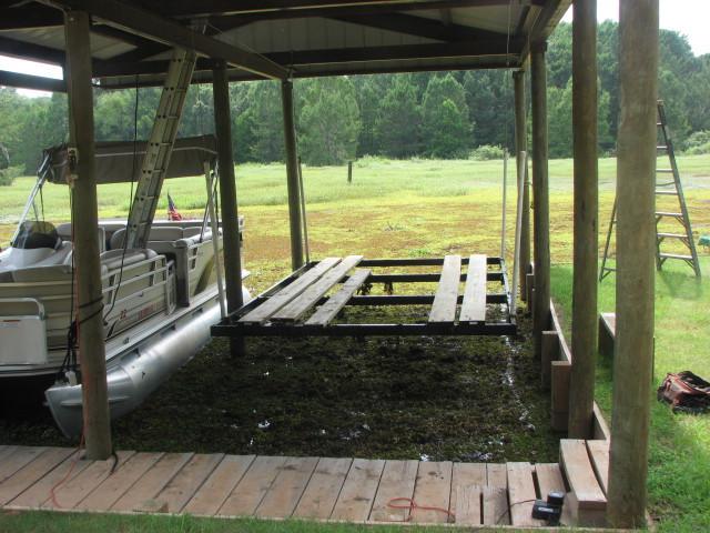

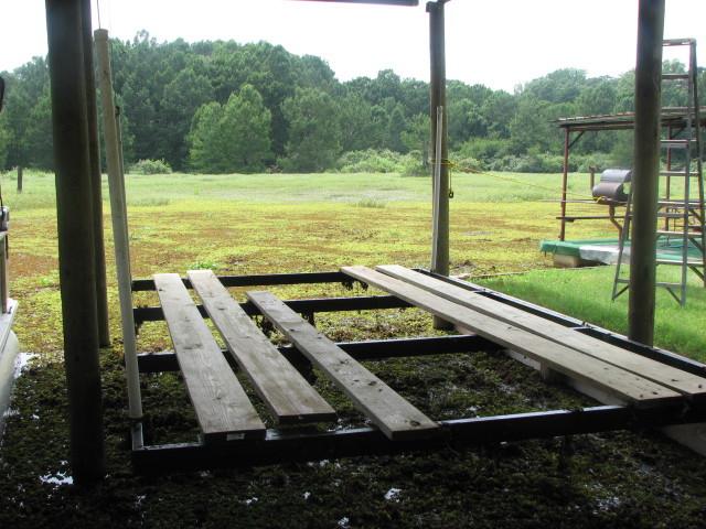

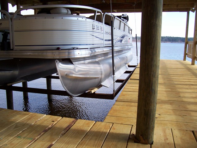

This is how I did mine and don't have any problems with it. Once mounted and when pulling in your boat centers up on the boards. Your boat is too big and long to miss them. It's easier than loading on your trailer. The pictures without the boat on the lift show the boards just laying on the lift not screwed down yet. But it gives you the idea of how we did it. There are a few more like mine. I don't like the idea of mounts holding up the outside edge of the board as when and if the boards rot or break then you have this mount sticking up through your toon.

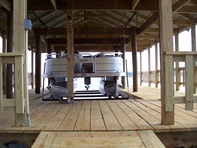

This is what I have. Similar to jimrs and works well. It is fairly easy to float the boat on backwards for prop changes and maintenance.

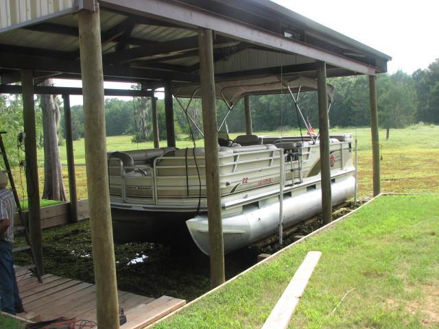

Beleve it or not there is 6 foot of water below the boat in the picture. You are seeing the invasion of the Giant Salvania. This started the year the boat house was completed and we are still fighthing it.
That is actually water all the way over to the tree line about 1000 or 1200 feet behind the boat.

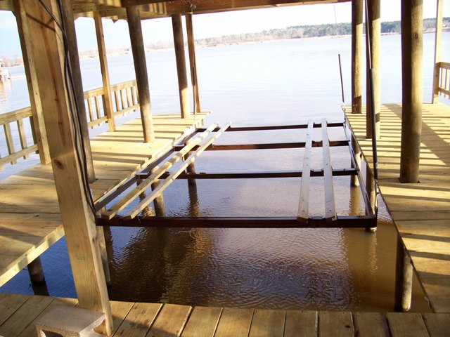

Interesting. The lifts around here look more like this and when it is a pontoon they just run the boards flat where the pontoons sit.

Greg, I thought about just flooring the lift frame but that is not how it is done around here so the contractor built bunks. In any case most of the boat houses around here are covered and the preference is to put the lift mechanism in the ceiling. Because of the lifting strakes the bunks are narrower than they would have been for regular tubes.

Greg, it appears that you have a front and rear lift system. Am I looking at your lift correctly? Looks like you are well sheltered. Nice.

The rear lift plate pulls both ends. There are pulley blocks in the front. This requires a rigid girder on both sides so the pilings don't pull together. In my case is is a pair of 2x12s with 2x4 bridging between them to stiffen the whole thing up.
The switch is the over travel cut off. If you get distracted and it winds up too far that will shut down the motor before it "tops out".
