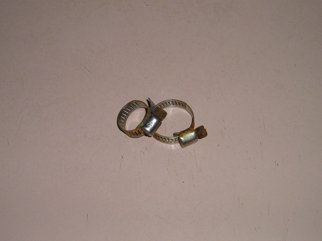

Yeah..like so:

Also when you buy clamps..make sure they are 100 percent stainless. There's alot of them that have plain steel screws with a stainless ring. In your climate, they'll corrode and break pretty quick. Bring a magnet to be sure
Seriously. I do...a boat builder friend of ours recommended I do so. Generally what's sold at marine stores is 100 percent while hardware stores, Lowes, Home Depot, etc. mix and match them.
- Posts: 32
- Joined: Wed Dec 02, 2009 9:22 pm
Re: Gas tank's...and then there were two...
X2 on the magnet, there is no guessing involved. If it sticks you don't want it.
