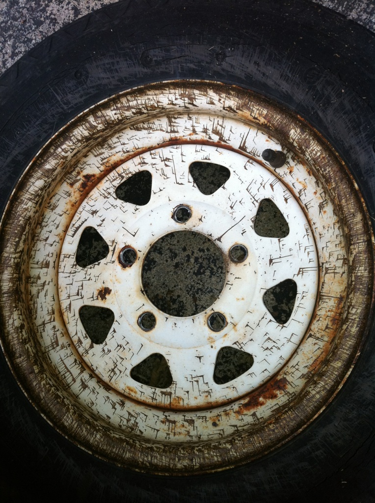

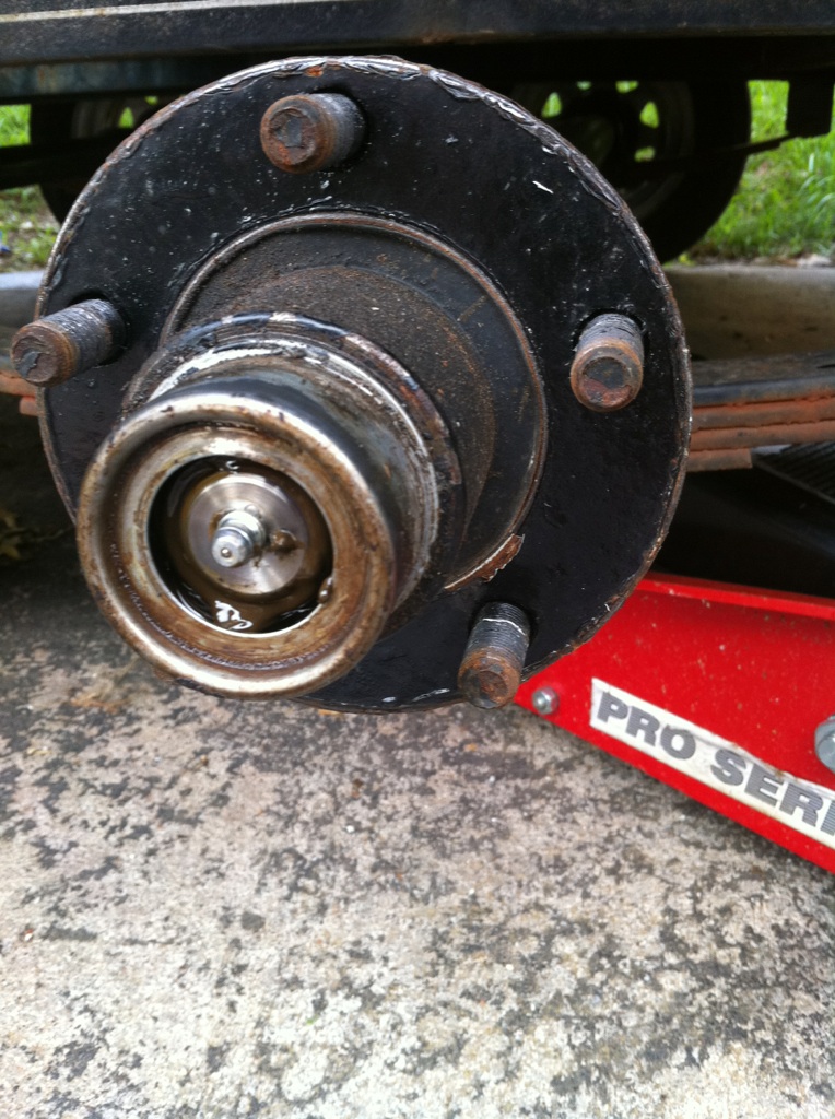

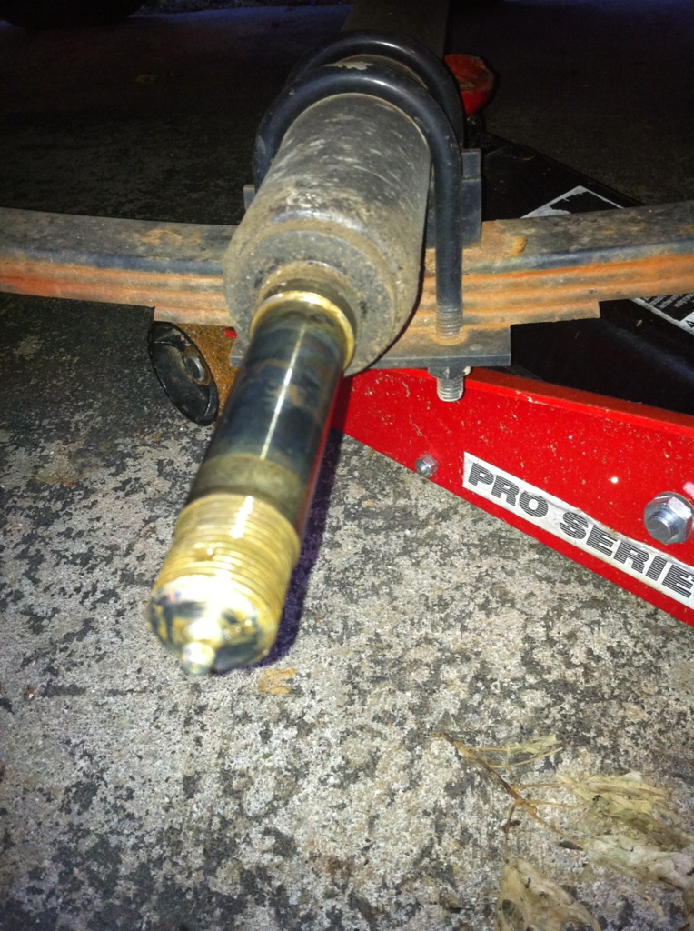

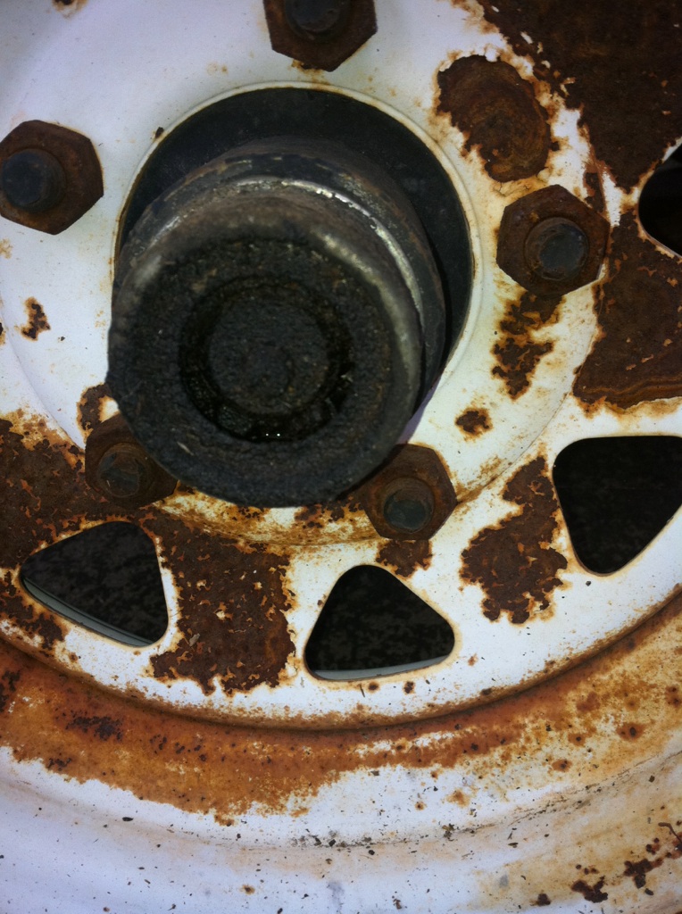

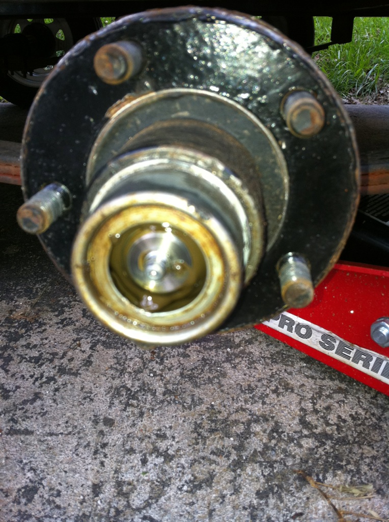

Here are some pics of my disaster.
- hub IMG_9057.jpg (343.82 KiB) Viewed 3583 times
- hub IMG_7652.jpg (324.67 KiB) Viewed 3581 times
- hub IMG_7131.jpg (283.64 KiB) Viewed 3576 times
- hub IMG_2755.jpg (306.93 KiB) Viewed 3577 times
- hub IMG_3596.jpg (277.63 KiB) Viewed 3578 times

So you took out the best way of greasing your hubs and went to one of less value, I have had mine for a while I love them, all I have to do is remove the front seal and pump in new grease while catching the old on a rag and I'm done.
Yes you do have to replace the seals now and then, but I'm still using the bearing that came with the trailer.

You went from good to crap. Bearing buddies are bad about blowing rear seals. The ones you have push old grease from rear to front bearing. It doesn't take a lot of grease, just enough to keep full. You should have had a rubber plug that fits in the housing. If this is intact no grease should get out unless to much was put in.

I hope you didn't already "break off" the grease fitting on the spindle. You have the best system already. It forces grease through the bearings from the back to the front. The little rubber covers you're talking about are only a couple bucks apiece. You'll sling a little grease now and then, but it's a good system. It sound like you should just replace the bearings and seals, or if you choose, the whole hub. I wouldn't recommend getting rid of the greased spindle and putting in bearing buddy type system. Just my 2 cents.

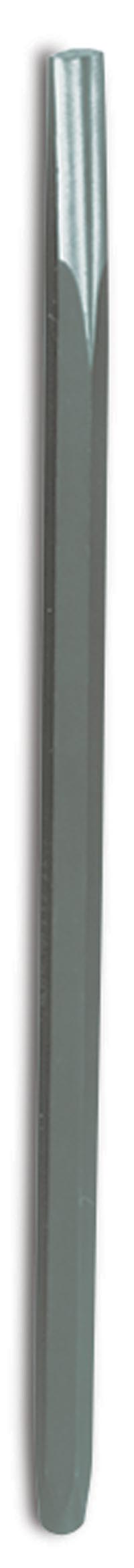

To add on more thing...... if you do find yourself with a stubborn race that won't budge, use a race punch. You can see in the pic because of it's shape more of the surface of the punch makes contact on the radius of the race and it makes removal much easier. Like most jobs, the right tool makes a huge difference

The caps are not plastic - they are rubber. Over time they will desiccate and shrink, but if you keep your tires (and wheels) covered when parked they will last many, many years without any leaking at all. They cost about $2.50 each.
Judging by the amount of external corrosion those wheels should be retired. What you can't see is the corrosion inside the metal which of course will cause the wheel to collapse at exactly the wrong time.
