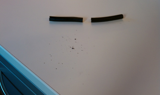

REplace your lines too mine were full of shit.

If the plugs & plug wires aren't the problem and you're going to wait until the end of the season, try running Sea-Foam in the gas. Enough of it in fresh gas will dissolve the deposits. When there are deposits in the jets an engine tends to run rough if they're in the idle systems, and won't develop full power at W.O.T. or the power comes on slower if the main jets are clogged.

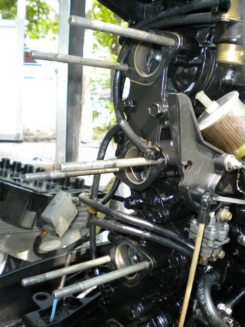

A spot you might want to check on a Merc. O.B. is the fuel line that runs from the engine's fuel inlet to the fuel pump. I had to replace that line last year. It's kinda hidden, it runs under the air intake manifold. Take the cover off and pump the primer bulb. Look for fuel in the bottom of the cowling.
Now that I think of it, this sounds like it could very well be your problem. As the line is on the inlet side of the fuel pump, a sudden decrease in fuel on the outlet side (as when going W.O.T. suddenly) will cause the pump to have a higher pressure differential as the pump needs to draw more fuel in to fill the carbs. If the line is cracked it will allow air to be sucked in to the fuel system, causing the engine to stumble. Once the pressures equalize the problem will go away. The line is a factory part and is not real expensive (I think it was about $25.00-30.00 last year).

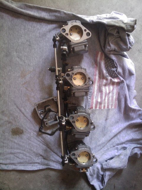

I took the carbs on my boat last year and cleaned them out (before I owned half of it. That bought me some free boat time.) in the water. Replace the rubber fuel lines. if you do it. It took me about 2 hours to remove, clean & reinstall all 4 and I've never had a boat engine apart in my life.
