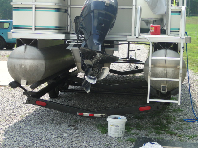

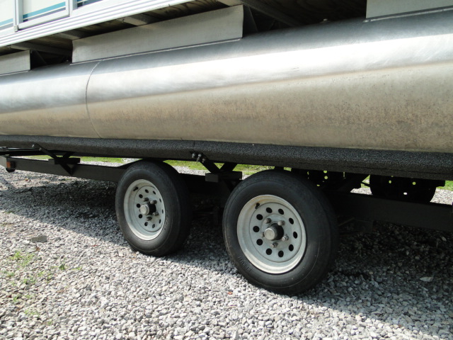

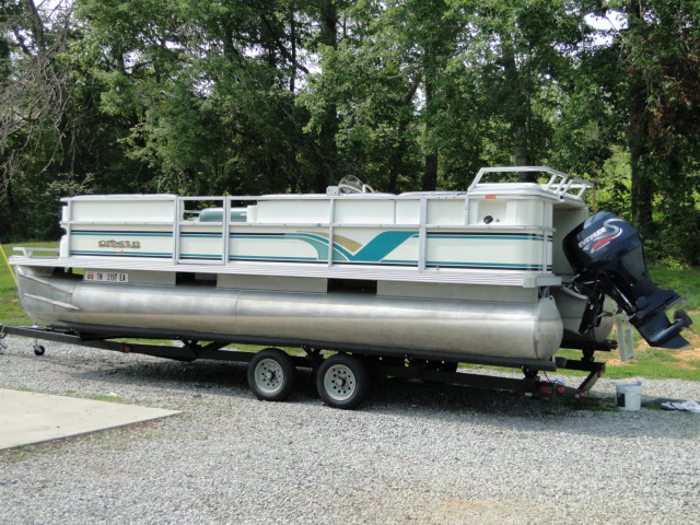

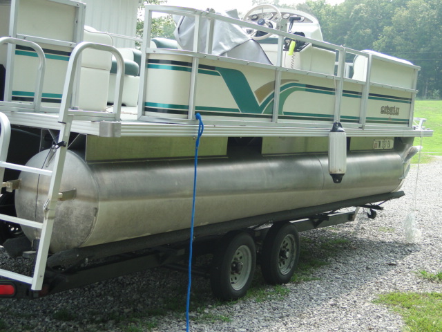

Pls check out these pics. Do I need to check for water in toons? I haven't been out enough to use the fuel up to compare how it sits in the water with less fuel.
When I'm at full speed the ladder frame seems to cause a lot of water to come up on the back deck right side. Is this normal?
Thanks,
Tere
Thanks,
Tere

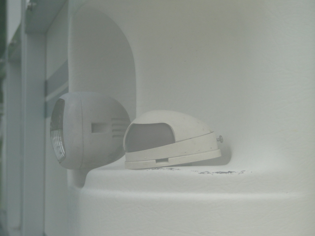

- Know where I can find running light like this one? I need one for left & right side.

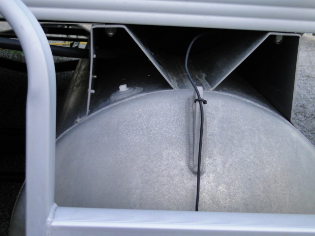

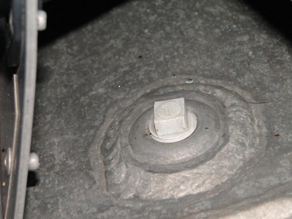

- A little better view of the plug on top.

- Another angle for comparing the water lines. If you look real close on top of the toon just fwd of the rear frame under the floor you will see the 1/2" plug. There are several of these and they all look like they've not been broken before.

You look a little back heavy. If you have no water in your toons you need some weight up front.

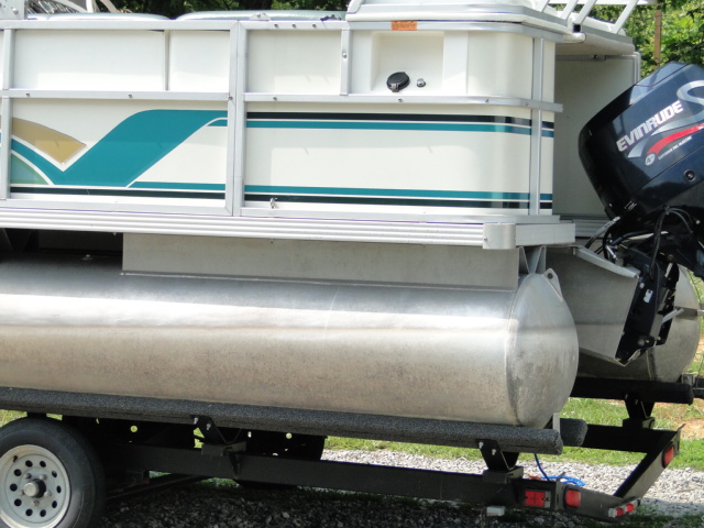

In this photo it looks like you are listing to the port. Notice how the waterline is a couple inches higher on that pontoon.humtere wrote:Pls check out these pics. Do I need to check for water in toons? I haven't been out enough to use the fuel up to compare how it sits in the water with less fuel.
My ladder also causes some spray. I think that is pretty normal.

Could this be from a full tank of gas? We have hardly used the boat this summer & have not even hit 3/4 full yet. My boat is 22' long, 1800 lbs, the motor it is rated for is a 70-90 hp I have a 70 evinrude/johnson motor it weighs 378lbs., the pontoons are 24" in diameter. Wish I did have a 90hp.

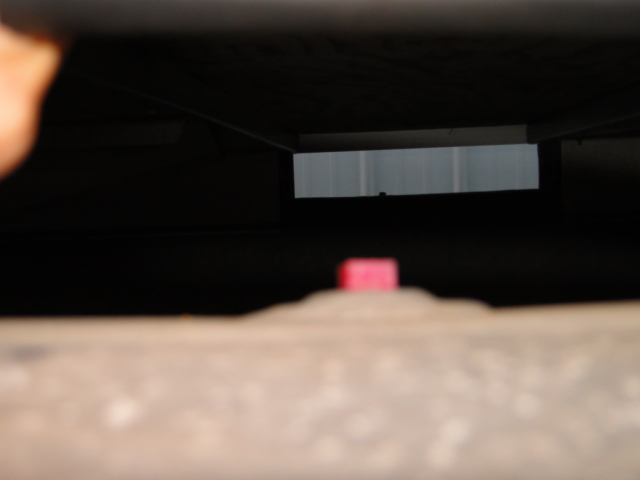

Can't do slosh test until week from Monday. Truck is in Charlotte. Lv for vacation Sat. I'm having some hesitation about breaking these seals. Hoping there is no water in the toons.
Any more suggestions?
How about the lights. Where can I find them?

- This is one of 8 seals, 4 on each toon. They are rubber.This is a close up of one.
- DSC00931 email.jpg (57.4 KiB) Viewed 2803 times
- There are 2 or 3 that have red spray paint on them.note one in foreground & one on far toon. They are all in the same place on each toon.

Yeah, a full fuel tank could cause it to be lower on that side. Your plugs are above the waterline so I wouldn't worry too much about breaking the seal if you hear water sloshing around when you do the slosh test.

The lights are made by Attwood. I replaced mine with LED lights Attwood that have the same base size and stainless covers. Here is a link to what I ordered for my Crest.
http://www.backtoboating.com/Scripts/pr ... product=97
Here is a link to Attwood's navigation light page.
http://www.attwoodmarine.com/store/cate ... s/two-mile
I ordered LED lights because my engine only had a 6 amp alternator and we do lot of boating at night. The old lights would slowly run the battery down over a period of time unless we did a lot of day running.
I found that all LED lights do not have the same brightness or are coast guard approved. Be carefull if you look at cheaper LED lights, especially anchor LED lights.
The two Crest boats I have owned had a 24 gallon gas tank on port side, most likely yours does to. When this tank is full, my boat was lower on the port side even while under way. I moved the battery and anything else of weight to the starboard side that I could.
My current Crest boat has port and center tanks. It still leans to the port side so I run the fuel out of the port tank first and then switch to the center tank.

Re: water in my logs?
I bet your pontoons don't have water in them...
If you look close at the picture of your pontoons from the side,
the front of the pontoon sits about 1/3 or 8" down into the water.
It looks like the rear of the pontoon is about 2/3rds or 16" down into the water.
Now look at the load...the motor is hanging way out on the back, the gas tank and the battery are in the back and there is more furniture and railing at the back than at the front.. when the driver sits down, his weight is also towards the back.
Even if you place all your extra gear and the passangers towards the front on the boat,
the rear of the pontoons will not rise very much, if at all.
I think your low ride is because the pontoons are only 24" in diameter.
and there probably isn't much you can do about that..
Good Boating to you....
