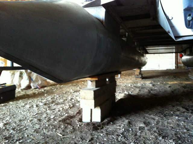

I'm going to try the tilt method today. Will try and get some pics of the process.

#14 Post by emerald_coast_tooner » Thu Aug 08, 2013 3:22 am
Didn't get to it yesterday. I will post pics and hopefully. I am bottom painting, so no resting on the logs.
