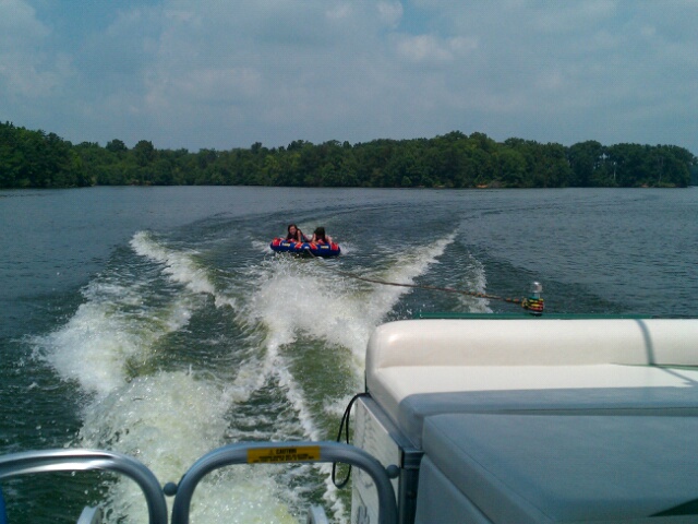

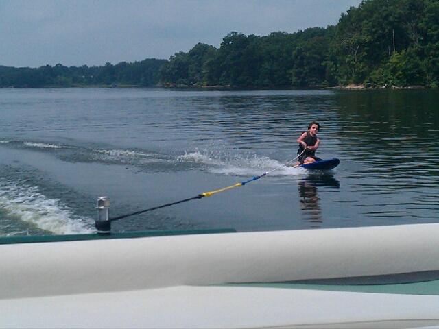

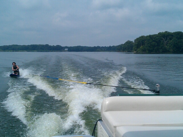

Got it mounted up the other night. Used it on the 4th. Worked great. My son enjoyed knee boarding much better as he was able to cut in and out of the wake easier. It was also great on the tube.
