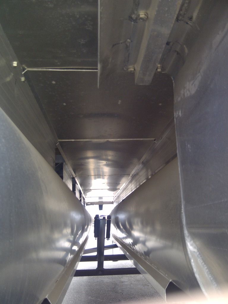

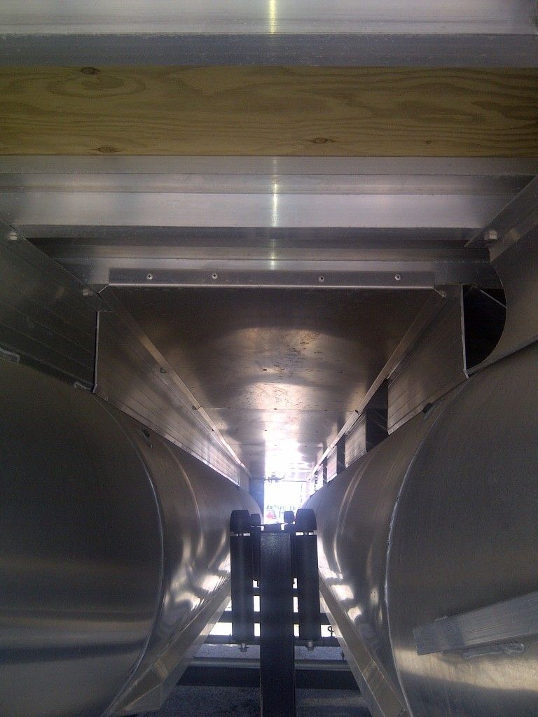

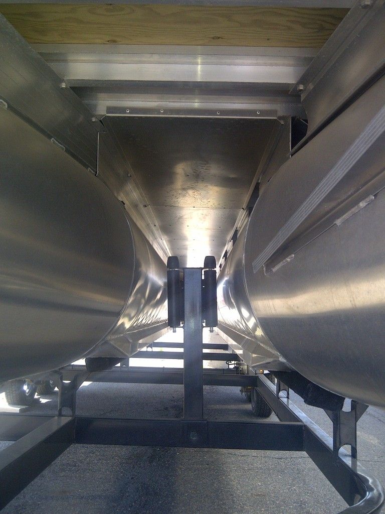

Not much to add, mostly just following along. However here is a picture of the bottom of a tri-toon Sun Tracker that I took a couple weeks ago. I had more but somehow 'lost' the phone that I took them with.. (I left it on the front deck of the pontoon as I drove down the highway.... :oops: )
If you click on these youc an see more 'full sized' pictures (I guess I was smrt enough to upload them to Photobucket before losing my phone!)
From what I've read on here, I see many fewer rivets than the 'do it yourself guys' are using..
