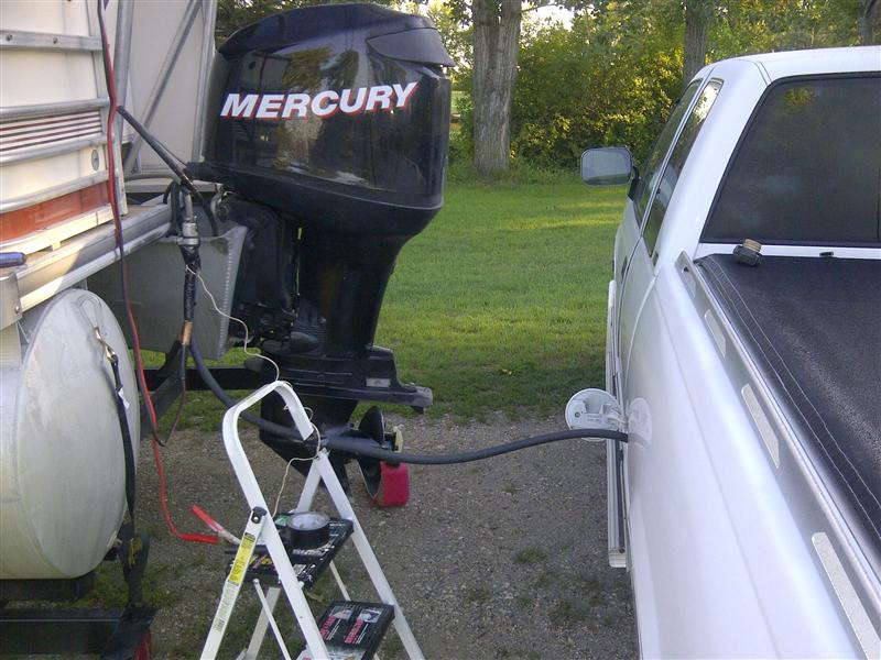

Last Friday I rushed home immediately after work because a storm was coming (70mph straight line winds, strong wind, chance of hail... we got some marble sized). In my haste, I neglected to pay attention to the gas gauge. So this morning I head out to get my stuff in the pickup, fire it up, and low and behold its on the red! I can't make it in to town without adding some gas, no problem, grab the lawnmower gas can (empty, grr). Then I realized I have about 20 gallons sitting on the boat, but how to get 5 gallons into the pickup? I thought about siphoning, no hose. I thought gravity would work through the factory fuel line to siphon, no luck there is a 1 way spring loaded check valve threaded into the top of the fuel tank making it 'spill proof'. Then it struck me! I had a spare 12v fuel pump from a car project just sitting on my shelf!
So here you have the rigging..
1 3/8" electric fuel pump
1 set of el-cheapo jumper cables
4ft of 5/8" heater hose (the only hose I could find this morning, I would have sworn I had some high pressure 3/8" fuel line but couldn't find it)
2ft of black duct tape
This winter I will use this setup with 3/8" hose, but I will probably pump it into the tractor..

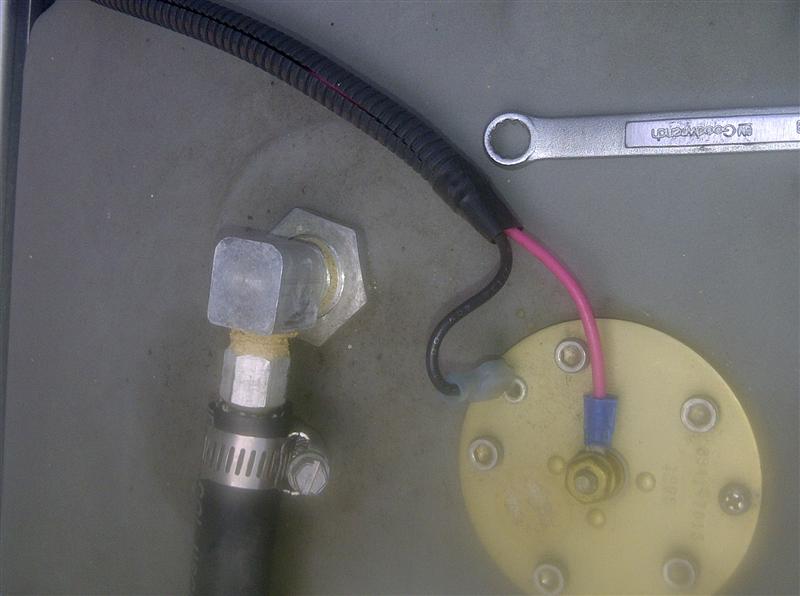

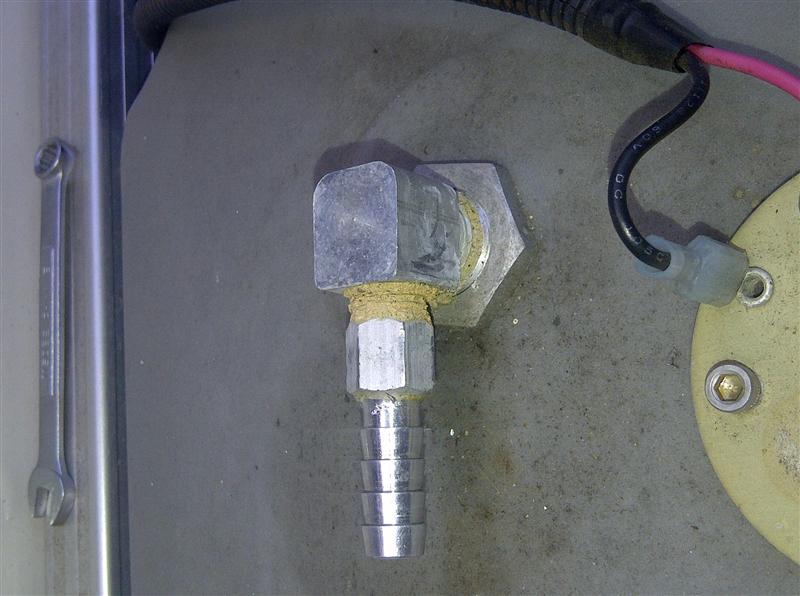

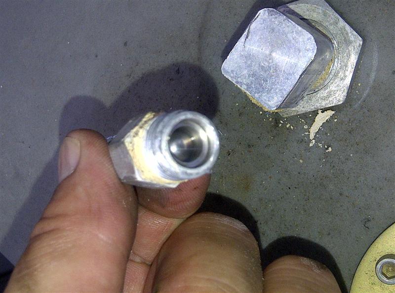

My one way check valve is threaded into a bung at the top of my fuel tank, so that wouldn't work anyhow.
Valve Location
Valve
One-way check ball
I know I've said this before, but my phone/camera goes everywhere with me, I have a bad case of CRS....
