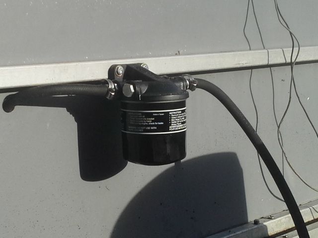

Re: Water/fuel seperator
thsi is mine. not sure what brand but it was on the boat when I bought it and walmart has the filters
