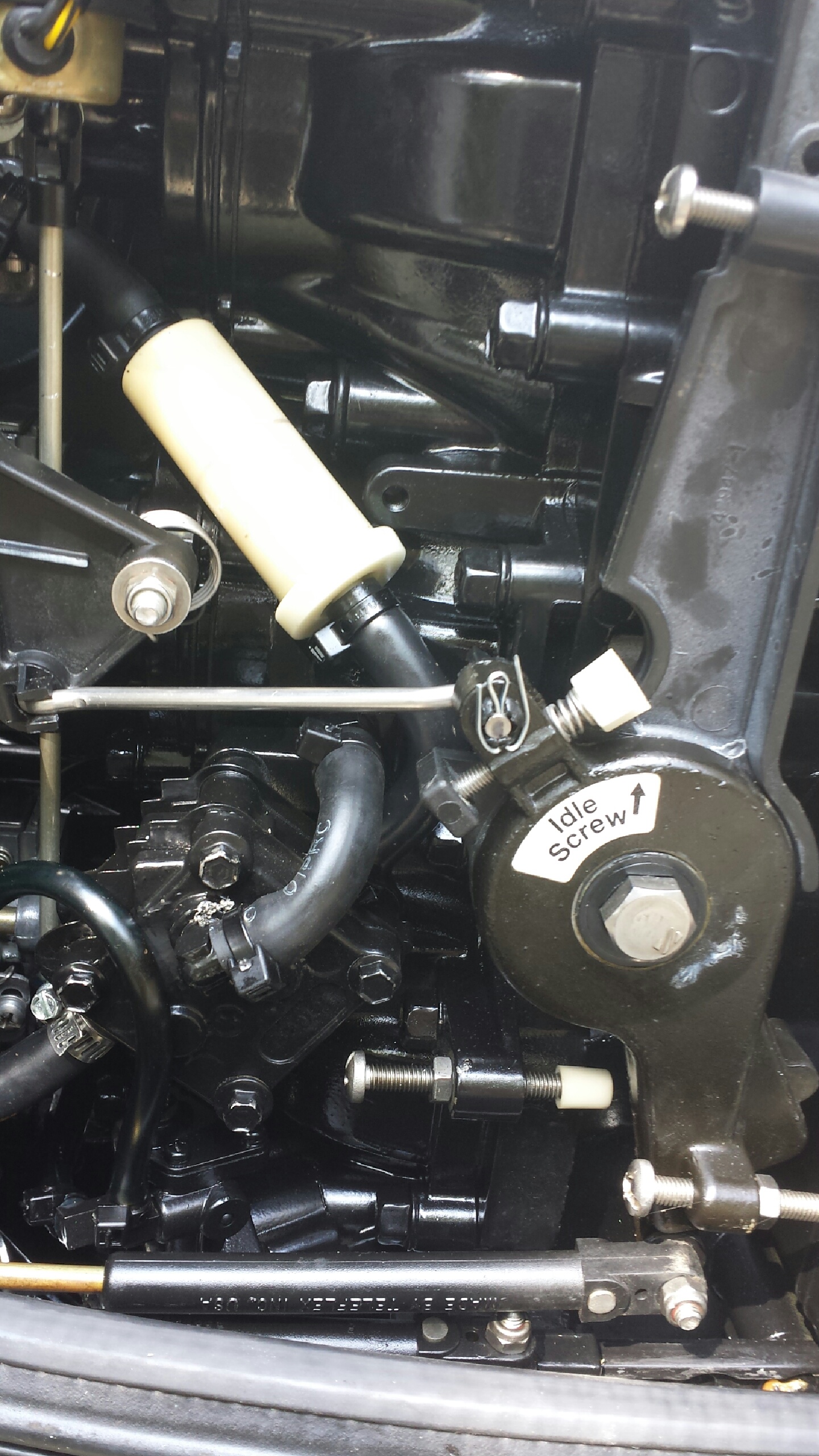

#11 Post by BigBoyKY » Fri Sep 20, 2013 1:46 pm
Ok so I haven't really kept up with this.... I replaced the Y fuel line hoping it might have been the issue with the idle issue. Well that helped some. It's idling smoother but will still cut out. Another issue arose the last trip out. The throttle linkage to the carbs kept falling off. I ordered new bushings, they won't arrive until late next week. So we are supposed to have a nice day Sunday and we were wanting to take her out. So I did a little redneck enginneering... Here's a pic.
A really small drill bit and a small cotter pin should take care of the problem
Mitch
