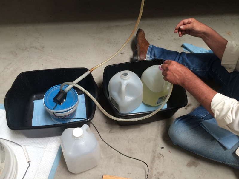

#14 Post by kiowacampers » Fri Aug 01, 2014 8:41 am
We used a small pipe and wire since we didn't have a clamp, and used a small pump to get it started, then let gravity take over. Worked great.

#15 Post by babock » Fri Aug 01, 2014 3:43 pm
Please tell me that's a fuel pump.
