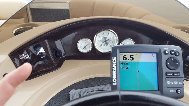

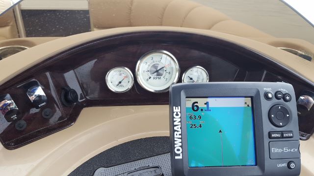

Raised it to hole four and made my test run today. I can go one more higher and think I should. Here’s why. I took a gopro camera and shot some video. I cannot see the anti-ventilation plate. I can see the little structure above the AV plate. The AV plate It is about another 2 inches under water. See the photo, I can see the little fin above the numbers 13x31, but not the AV plate. I could trim it pretty good before I got venting. However, the venting was at roughly the same trim point as when the motor was as low as it could go. When I trimmed for speed I would vent a little in a hard turn. If I just bumped the trim down in a turn, it hooked up with no more venting.
Runs were at 5000 rpm with 25.4 MPH running reciprocal courses on GPS. My finger in the photo is the reciprocal run.
I was heavy, three ice chest full of water, me about 220 and all my gear, bimini up as close as you get to having a full blown boating day. :thumbsup
So bottom line, I’m going back to the shop and have them raise it to the highest position and will make another run.

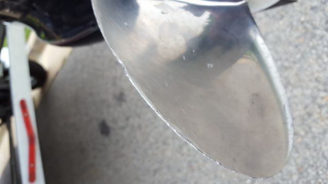

Also my prop is a little dinged, photos of one of the blades. I think I might want to factor that when making the prop decision.

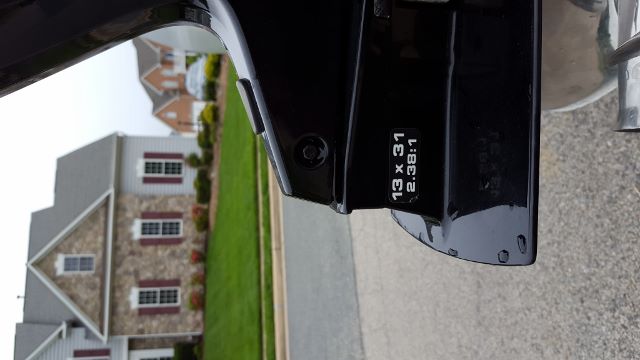

A/V Plate Reference
20160512_133732 (360x640).jpg (79 KiB) Viewed 6780 times
Reciprocal Run
20160512_122712 (640x360).jpg (88.25 KiB) Viewed 6780 times
Initial Run
20160512_122545 (640x360).jpg (90.19 KiB) Viewed 6778 times
Dinged prop blade
20160512_133742 (360x640).jpg (65.01 KiB) Viewed 6776 times

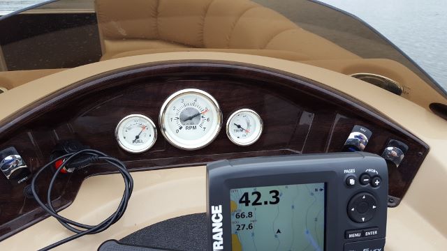

BTW getting the motor height to where it is, as shallow as it can run, got me from 22.4 to 27.6. I did underskin, but that's probably 1 to 1.5 MPH at most; I measured it as best I could. So over all MPH up 5.2 MPH, 23.2%. I'll take it. If I can get to 30 MPH, I'll be satisfied. Wife doesn't want it to go any faster, she afraid I'll hurt the grandkids tubing.
20160519_094159 (640x360).jpg (90.71 KiB) Viewed 5901 times
