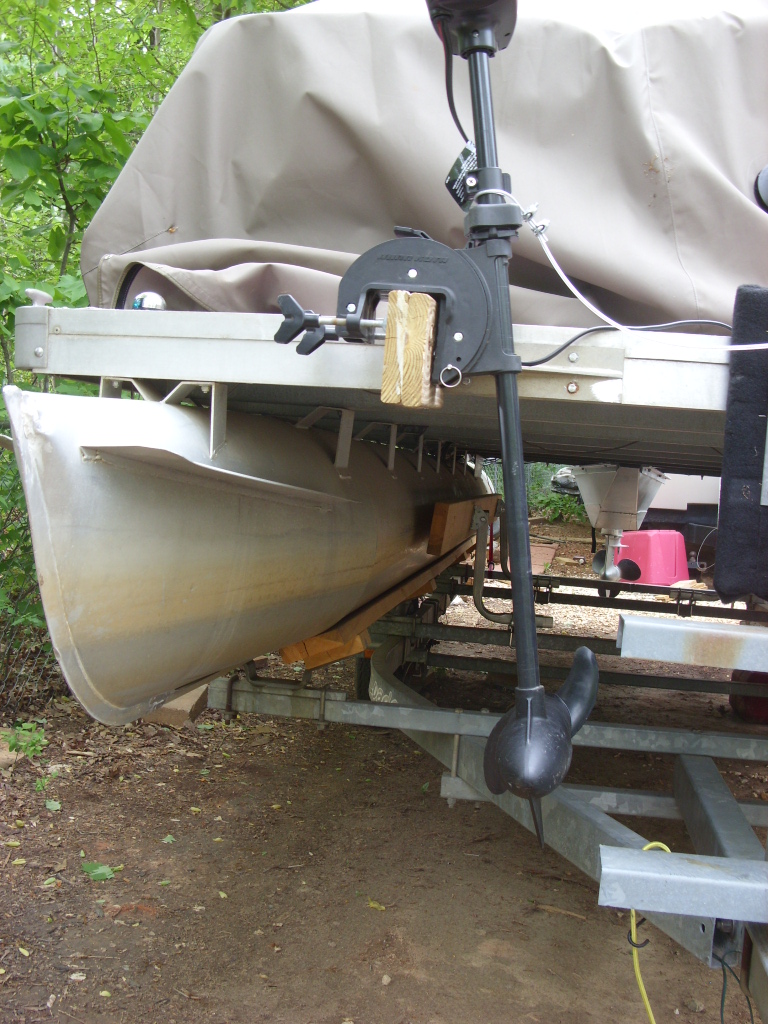

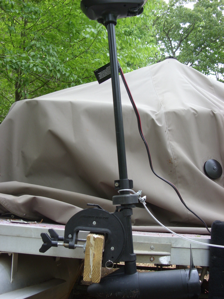

The MotorGuide VariMax 75 lbs thrust 24 volt 50" pontoon mount is Mounted , still havnt done the battery box or wiring yet but here is was I done this evening .
From the seat
UP Periscope
I guess this will hold it if the factory 2 locks fail , it has the squeeze slider and the twist lock
