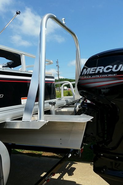

My Ski/tow bar finally came in and had it installed yesterday. Really looking forward to trying it out this weekend.. :alright

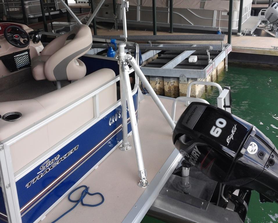

This is mine built in the driveway in a couple of hours with nothing but hand tools from 1.5" (1.9" OD) Alum Pipe and Cast Alum Construction Fittings as sold at many Industrial Suppliers to which I used http://www.mcmaster.com (http://www.mcmaster.com/#4698t81/=y3apk1) I upped the strength by removing the 1/4" pin used to join the swivels and replaced with 5/16" cap screws and pinned the pipe in the fittings with 3/8" cap screws, also used 1/4" thick plate under the decking to sandwich the flange fittings to the deck. It now has a plastic swivel bushing at the rope attachment point to allow the rope to swing side to side and cause no chafe. Used the stink out of it with up to 3 people on the tube and it works great.....

I live very much off the beaten path and there is nothing I dislike more than having to go into town as just the drive takes least 3 hours out of my day... The UPS man dropped it all off at the house for about 200 dollars...

Both of them look very good! I wish my boat was two feet longer and I had that two feet on the stern to put one on.

That's one of the reasons I rolled my own was that many of the topside mounted 4 point bars used up more real estate than I had to spare. I don't recall the width if my overall footprint was even 18 inches... But I understand some boats don't have an open stern at all.

I had Tracker in Florence, AL install it, but from what I can tell, they mounted extra bracing to the floor bracing and bolted it down. I will snap a few extra pics when I get home if you want?

First time I have seen one like that on a toon! Seen em on fishing boats but I like it! :idea:
