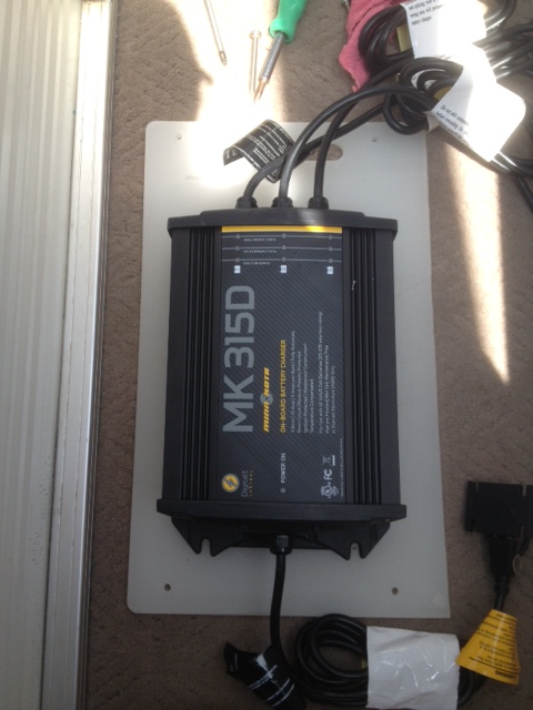

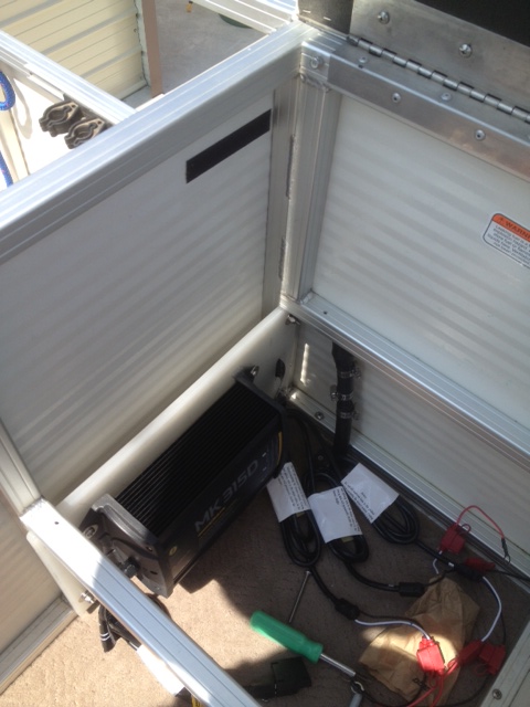

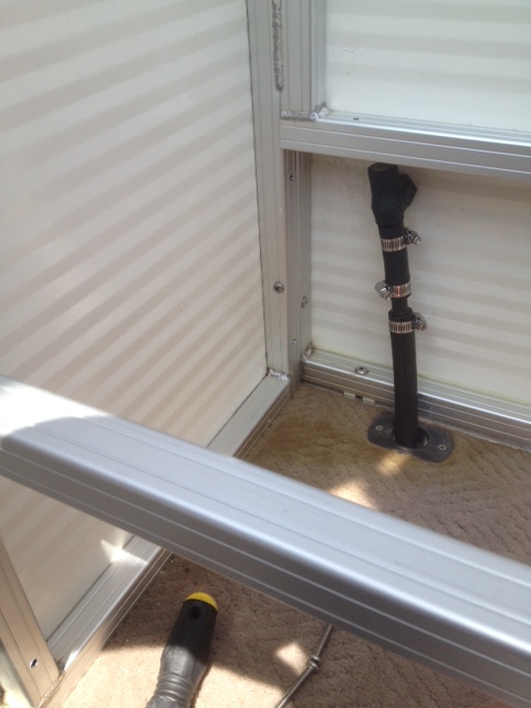

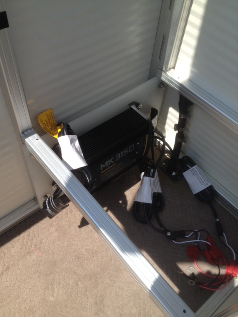

Here is the latest with my charger install project. About 90% complete.
Decided to solder wires.....why...... I didn't like the way the charger OEM wires (about 14 gauge) fit into a 10 gauge butt connector (my charger leads were made with 10 gauge duplex). So, I soldered wires, used heavy 3M electrical tape to cover soldered wires, and finished with adhesive lined marine shrink tubing over tape.
Charger mounted (through bolted) to a piece of trimmed down 12"X18" standard cutting board (no wood here). Then, the board was through bolted to fencing frame. Nice and strong and not prone to rot. I was a long time sailboat owner that owned a boat with a lot of teak/mahogany wood, so I like things that are maintenance free... as much as possible!!
Now, I just purchased a Minn-Kota adapter plug that is designed to incorporate the factory charger plug end into a through bulk head plug adapter. The adapter is then used with a standard extension cord. Basically, you mount the charger plug end into this adapter, then drill a hole into fencing material, mount the adapter to/through the fencing, and whoalaaa....you have a receptacle to plug an extension cord into for charging!! I plan on mounting the plug adapter about 1 foot right of the gas vent line. This keeps it near the charger and covered up by the porta-potty seat. The entire charger is covered by the porta-potty seat/carpeted board.
NOTE: Todd....I'll see if my Minn-Kota adapter fits any better than yours. If not, I'll make up the pigtail as you described.
I hope this helps others who may be thinking of how to mount a permanent charger.
Thanks for all the advice and suggestions!
