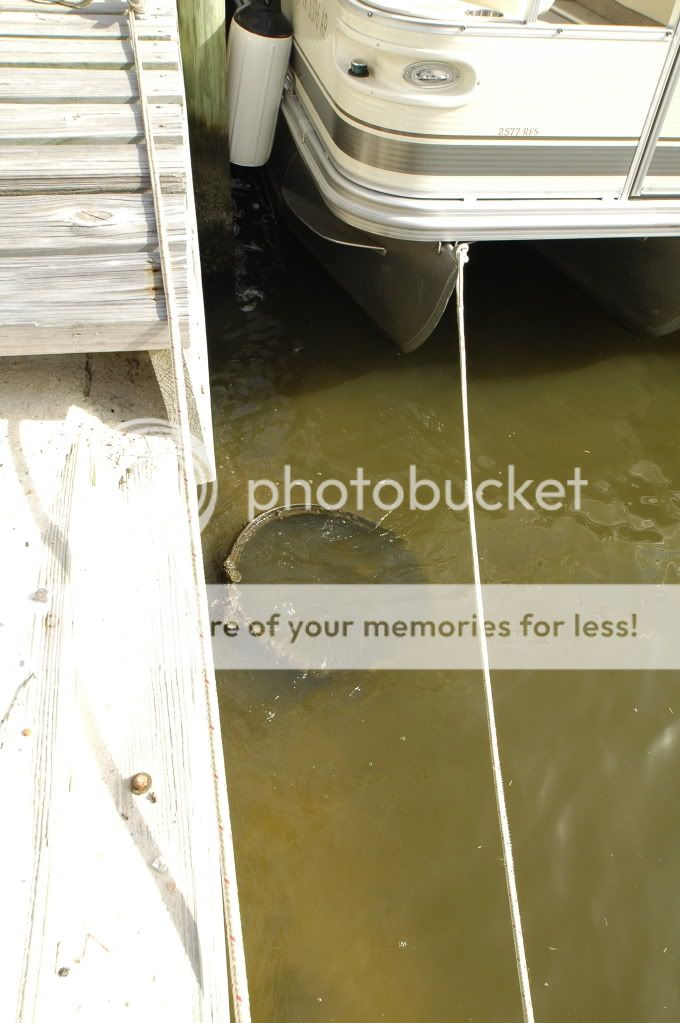

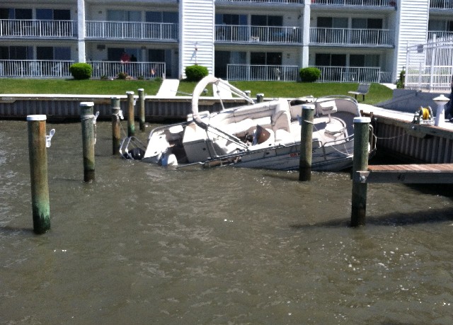

Bad start to the season.
Copy of sinking2.JPG (96.17 KiB) Viewed 4310 times
Copy of sinking1.JPG (99.83 KiB) Viewed 4309 times

It was REALLY windy in Ocean City, MD last Friday night. The tie down hook that is welded to the pontoon got yanked off and left a big hole in the tube.

That's why you use that hook for lifting only, it doesn't like side forces

They are made to pull straight up, people have got away with using them for tow rope use, some have had cracks form, no way would I pull and boat with them, if you don't have cleats in the back, put them on, or at least some good strong eyelets.
Might not cause a problem, but why take a chance

Yep. I was specifically told by Tracker ( I e-mailed the factory reps) NOT to use the log eyelets for tying to a slip. The port and stern cleat welded onto the log has a HUGE backer inside the log, that's fine...eyelets have no side to side strength. A lot of 'toons on the bay have the log eyelets bent or broken off due to our nasty weather.
