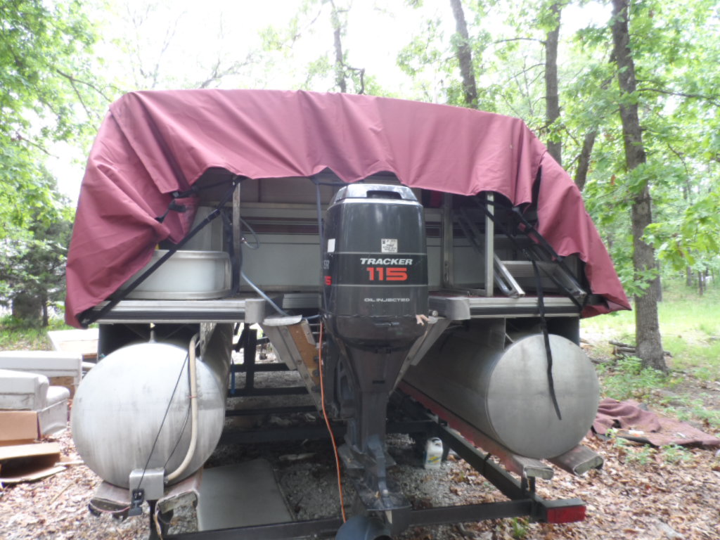

I have searched this forum, but I don't see a best location to mount a transducer for my new Lowrance Elite 4 DSI fishfinder.
I see that most people say to mount the transducer on the bracket that goes around the aerator pump on the left toon at the rear. But I saw where one person has mounted the transducer on the transom.
I haven't drilled any holes yet for the transducer. So what does everybody suggest?

Right bracket. There's no pump there.

Since it is a Tracker it probably has a ladder....and no bracket at all.

Be sure and mount the bracket as close to bottom as possible. Toons make lots of bubbles and disturbed water and transducer needs clean water to work right. Don't tighten so much it won't kick up when it hits something.

On the bracket. It also has to be level. Your kit should have shims in case you need them. Be sure to use stainless steel hardware.

I think curtiscapk is correct, I can't find a bracket on the right side of my Tracker. So I will mount it on the aerator bracket on the left side. I just wanted to be sure before I start drilling into our new boat, ha.
