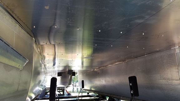

figure 300.00 . however that will vary with what thickness you use. I used .080. mine turned out great. big difference. wore me out doing it but results were well worth it just in how much quieter it is now. didn't pick up but maybe a couple miles an hour but speed and pontoons are not natural allies..lol/
Now..what I did was I layed down a thick bead of 3M UV4000 Marine adhesive to the cross members. I marked and pre drilled the sheets . I placed the sheets where they went and then secured across the braces in the pre drilled holes with a SS #10 TEK. I put them in with an Impact gun, NOT a screw gun. I have U shaped logs so I didn't need any side filler pieces. There was no need to secure to the side bracing. There those on here that will tell you that the only way to do this is with a rivet attachment as the TEKs can theoretically back themselves out. Yes, possible. Realistically, it would take a lot of vibration and movement for that to happen.
This is where the UV 4000 comes in. It creates a permanent bond of the sheet to the cross brace. All those TEKs can fall out and these sheets are going nowhere. Have extensive experience with this stuff and cant say enough about how well it works. In fact, Featherlite Trailers are constructed with this material for the attachment of all the outer skin.
Here's a pic.
Here's a pic.

The primary use of the adhesive is to eliminate the loading of the panel being borne solely by the TEK screws. Yes, in the event that they do back out you haven't compromised the sheet attachment. Additionally the sheets being bonded to the braces with the adhesive, become a stressed member. therefore adding a slight amount of rigidity to the overall undercarriage. Screws or rivets alone do not allow for lading to be distributed all across the bracing and do not connect one brace to the other. Now...you CAN remove the sheets. It will take some good effort but you can remove them. The adhesive has some elastic properties in it which do allow for natural expansion , contraction etc.
you will get the same result with adhesive used in conjunction with rivets. They are just harder to put in as compared to TEKs . They DO eliminate 100% any "backout"
Point is...the adhesive is a plus any way you cut it
