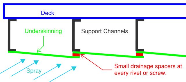

Hope I'm not hijacking this but since Soonertoon brought it up...is the adhesive only for if the screws come out? Or does it need to be permanently sealed? I am contemplating doing an underskin job but I'm sure water will still make its way between the deck and the underskin and I would like it to be able to drain out still and breath a little. I will end up using aluminum rivets as I'm on saltwater and you don't want saltwater, stainless, and aluminum pooling up together unless you are trying to make a battery!
What I am envisioning is something like those old slotted louvers on the rear windows of Firebirds/Trans-AMs with maybe a 1/4" space between the adjoining sheets allowing anything to drain out and a little air to flow through.
Anyone have any thoughts on this?

So does no one ever have issues, or even know if they do, with any water pooling up on top of the underskinning? If I was on freshwater I wouldn't be worried about it but saltwater pooling up there would be bad, especially if I use any stainless screws. Also in Florida where the dang humidity is 90% or better most of the year stuff doesn't evaporate very quickly!
Maybe my louvers description wast good. Here is a crude sketch of what I was thinking.

[quote="Jake_Daddy"]So does no one ever have issues, or even know if they do, with any water pooling up on top of the underskinning? If I was on freshwater I wouldn't be worried about it but saltwater pooling up there would be bad, especially if I use any stainless screws. Also in Florida where the dang humidity is 90% or better most of the year stuff doesn't evaporate very quickly!
Maybe my louvers description wast good. Here is a crude sketch of what I was thinking.[/quote]
I see no issues with that design, except possible "oil canning" noise if there is too much space between fasteners......... and a little extra work, but easier to handle smaller panels.
