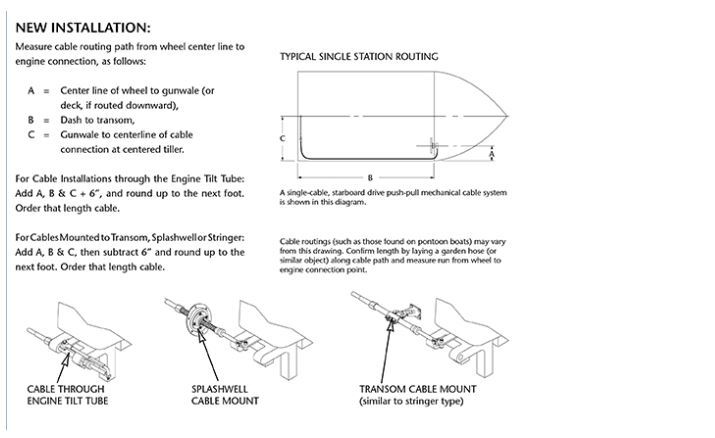

If I were you I'd get a correct size cable instead sounds like that one is too long. Mine has a foot of slack and that's it. "and then under the boat it goes side to side 4 times" crazy!
When replacing the steering system on your pontoon boat you will need the following measurements to determine the cable length.
A. Measure from the center of your pontoon's console to the edge of the starboard side of your deck.
B. Measure your pontoon boat's deck length from the center of your console to the point where your engine is attached to the transom.
C. Measure from the starboard edge of your deck to the center of your transom.
Add A,B, C + 12", round up to the closest foot and that's the length you need.
https://www.pontoonstuff.com/collection ... ing-system
https://www.pontoonstuff.com/collection ... ring-wheel

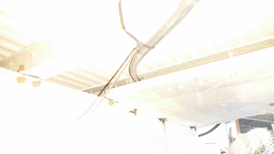

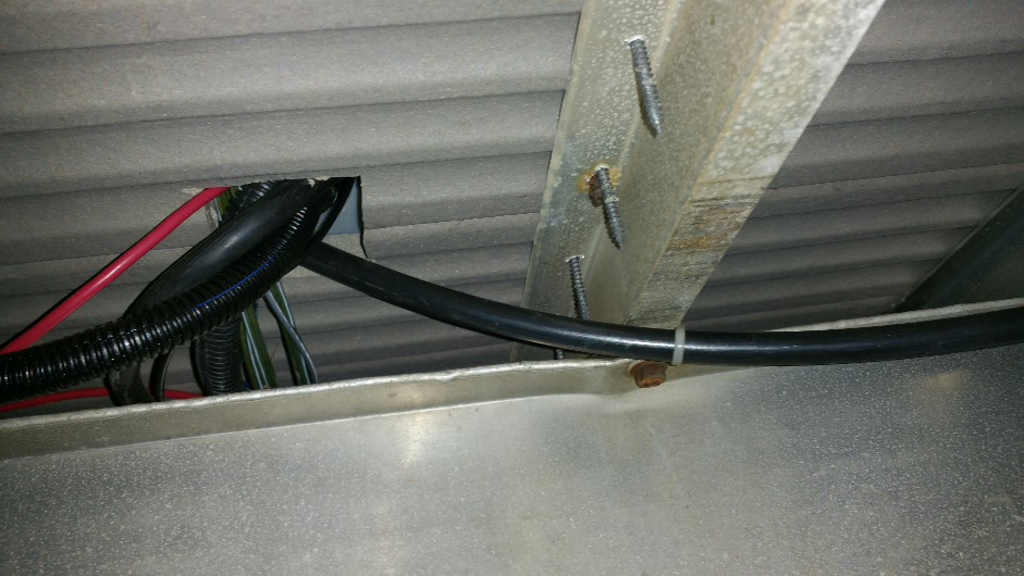

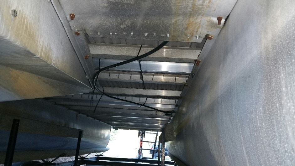

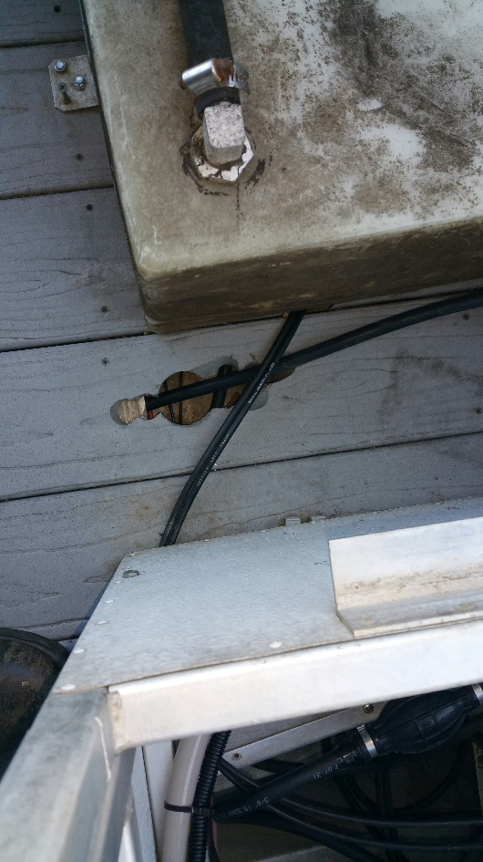

#9 Post by bansil » Wed May 02, 2018 3:14 pm
curtiscapk wrote:
Wed May 02, 2018 11:21 am
does it really go back and forth?
I undid 1 loop last week to try and help it and it work some still horrific ,this was taken last night
2018-05-01 19.03.34.jpg (140.99 KiB) Viewed 4372 times
2018-05-01 19.31.15.jpg (97.59 KiB) Viewed 4372 times
2018-05-01 19.02.39.jpg (132.76 KiB) Viewed 4372 times
2018-05-01 19.02.15.jpg (48.59 KiB) Viewed 4372 times
2018-05-01 19.01.48.jpg (131.28 KiB) Viewed 4372 times
You count every place in contact and they are stressed, all holes wrong places and it will be fun, i have a pretty good plan laid out to try and salvage thos...

#11 Post by curtiscapk » Thu May 03, 2018 6:44 am
yikes I think you'd see dramatic difference with something like this....
