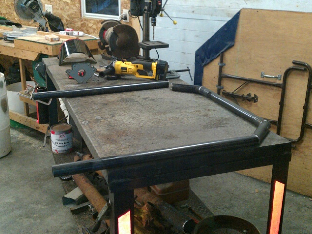

I'm sick of the stupid "Y" rope. It's a pain in the A**. I'm a good metal fabricator, so I'm going to build one out of regular metal. I'm not paying the $500 the dealer wants for one.
Basically what Curtis has on his, but I'm gonna make it out of round tubing for more of a factory look. I'll just paint it for this summer, then maybe this winter I'll get it powder coated.
Here is a mock up built out of wood to get all the angles and dimensions. That way I can get a cut list and know all the lengths and angles.

The bottom will have a flat iron running from the front support to the rear support. That flat iron will then bolt through the crossmembers.

Re: Homemade ski/tube pylon-bar.
Finally got some time to get started on this. Been busy with work, but now since it rained AGAIN, can't get back in the fields for a few days. So figured I could get her done this week. Took about 3-4 hrs to fab it up and weld it. Now just need to figure out some type of rope mount. Then get some paint on it and bolt it on!!!

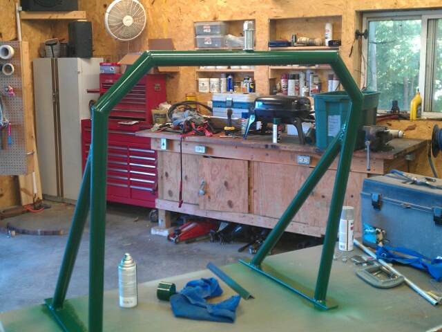

Here's some pics of it painted and with the rope mount on.

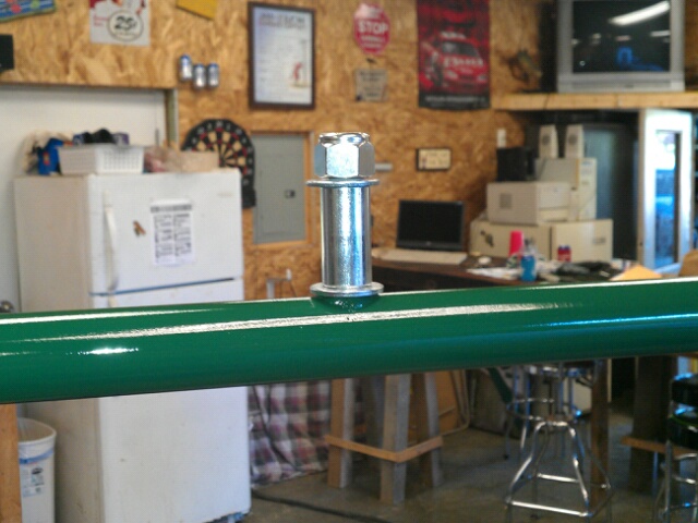

The rope mount I ended up welding a 3/4" bolt (cut the head off) to the top bar with a slight angle forward to keep the rope from trying to jump off. Then I found a bushing and put some washers on each side of it with a lock nut on top. This way the bushing can swivel so it doesn't wear out the rope.
