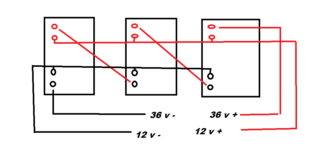

OK You Two What do you think about this layout...
Batteries in Series 36 v 12 v.png (19.74 KiB) Viewed 2162 times
Since marine batteries come with duplicate posts on each connection why not utilize them in making this work for the man?
Note on second thought I need to look deeper into this... My batteries have two distinctive attachment points separated in non conductive plastic. I realized after posting many batteries are conductivity connected so this wouldn't work for them... Will haft to look deeper into subject.. :coffee

#28 Post by babock » Mon Mar 23, 2015 3:28 pm
The 2 batteries on the left have dead shorts!
EDIT: All the batteries have dead shorts.
Uhghh! Where's the "bang my head against the wall" icon!
Bamby wrote: Note on second thought I need to look deeper into this... My batteries have two distinctive attachment points separated in non conductive plastic.
Yes, and they are electrically connected! All marine batteries that have the extra post are still electrically connected!
